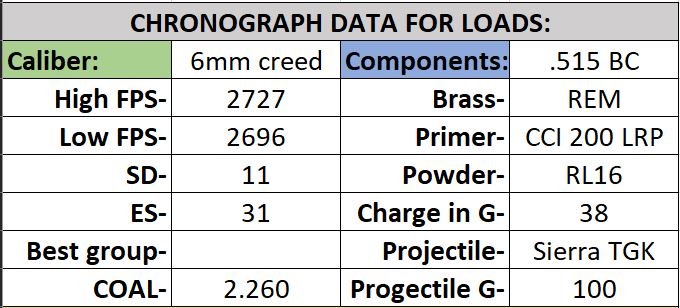

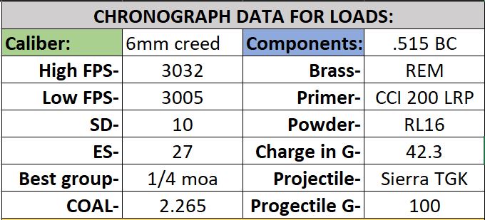

I did a few loads with RL16 under two different 100g pills, here is what I got.
