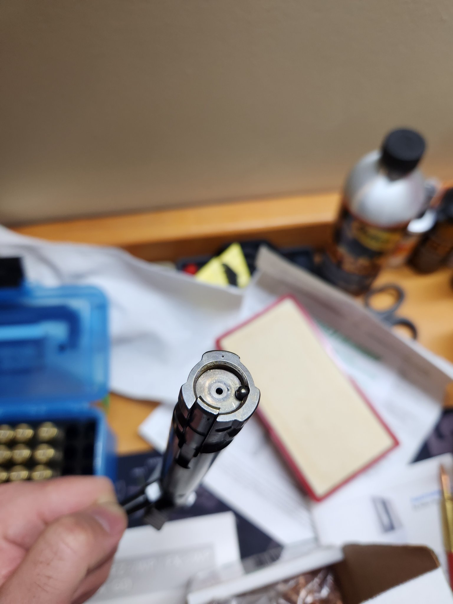

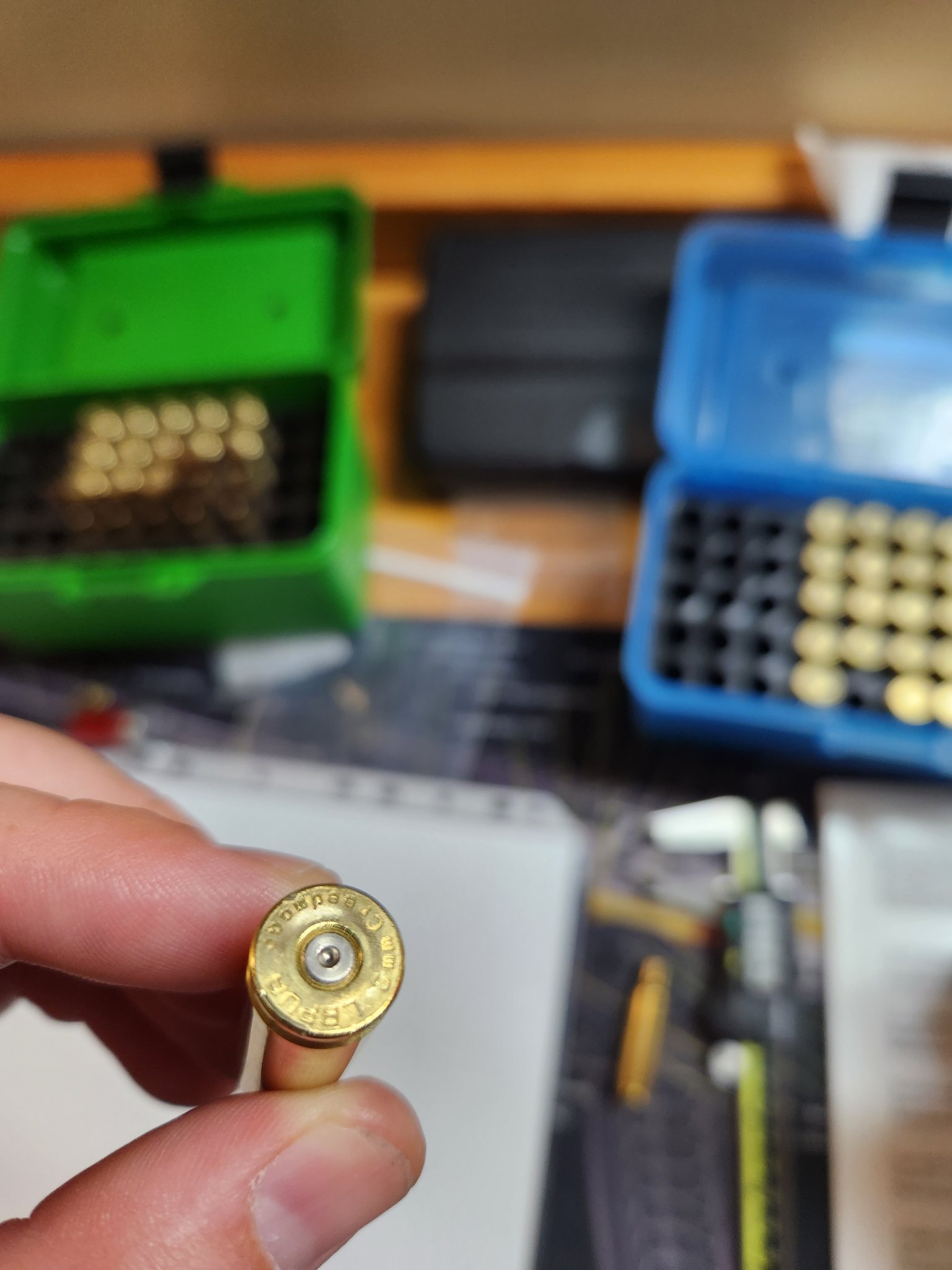

So I just did a small ladder test with my AT-X. I'm getting heavy bolt lift on what I believe to be pretty mild loads. I'm also noticing weird markings on some of the case shoulders. No real signs of pressure otherwise (please double check me on this). I'll post some pics.
6mm Creedmoor
107 SMKs
Lapua Brass
CCI BR2 small primers
H4350
Charges were 40.5, 40.8, 41.0, 41.2, and 41.4.
Velocities were under 3100 fps
The brass was new and I sized it with a SAC sizing die prior to loading.

You have a piece of something in your chamber shoulder area. See mark on brass shoulder. If you have a bore scope you can probably see it. Clean it out and the issue will go away. I had a similar issue after blowing some primers.
Maybe.
If that mark wasn't there before you shot the brass then as said here, check it out and see if there's something there.

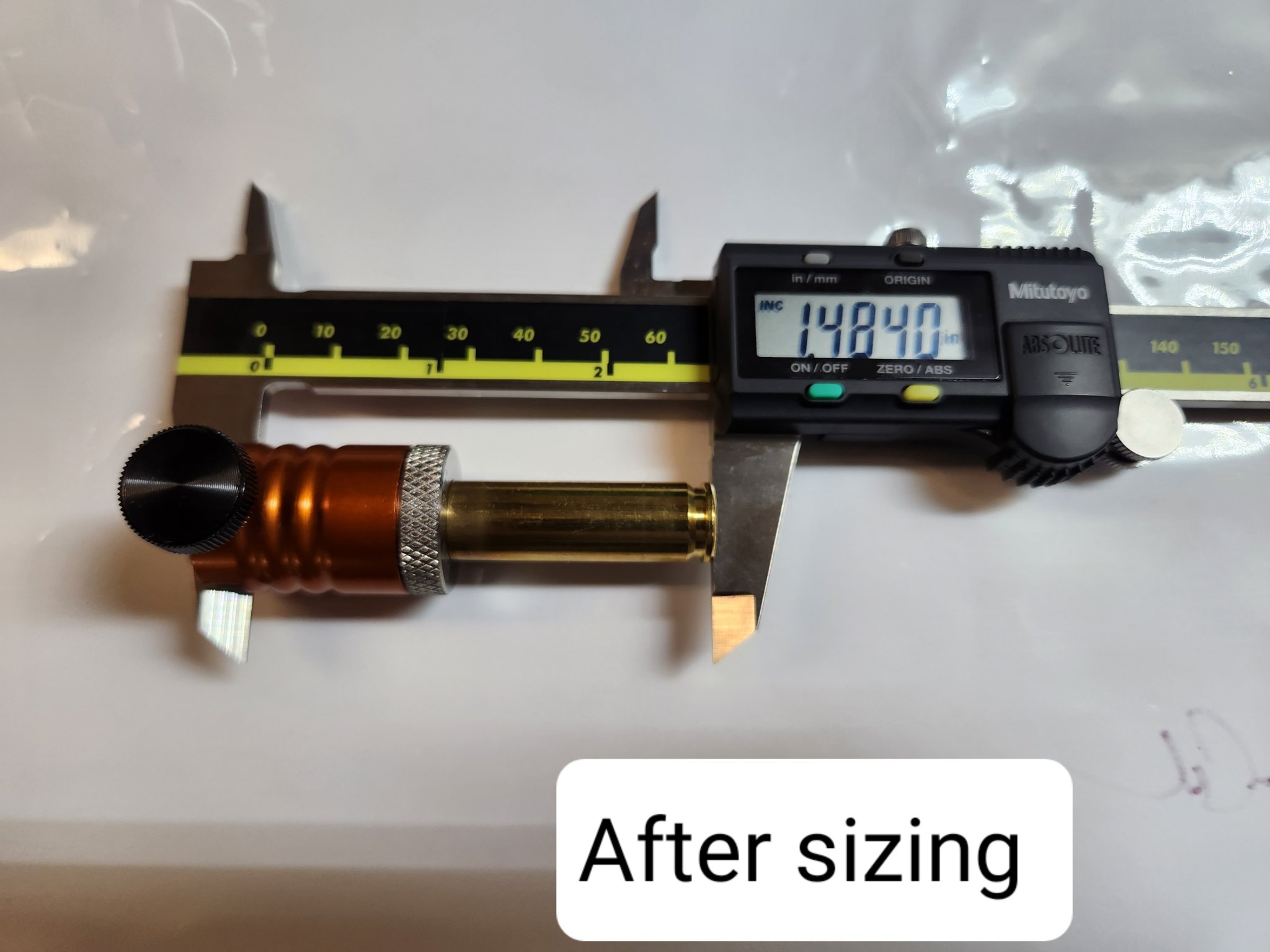

The SAC comparator should be here tomorrow. I'll update with the measurements

I'm really thinking I need to just keep backing down my charge. At 39.6 I still had heavy bolt lift on most and my velocities were around 2960. Dunno whats going on...

Doesn't seem to be the sizing of the virgin brass based on those pics.
Move to the next thing on the list. Make sure that brass isn't too tight for your chamber. Then make sure you're not seating into the lands.

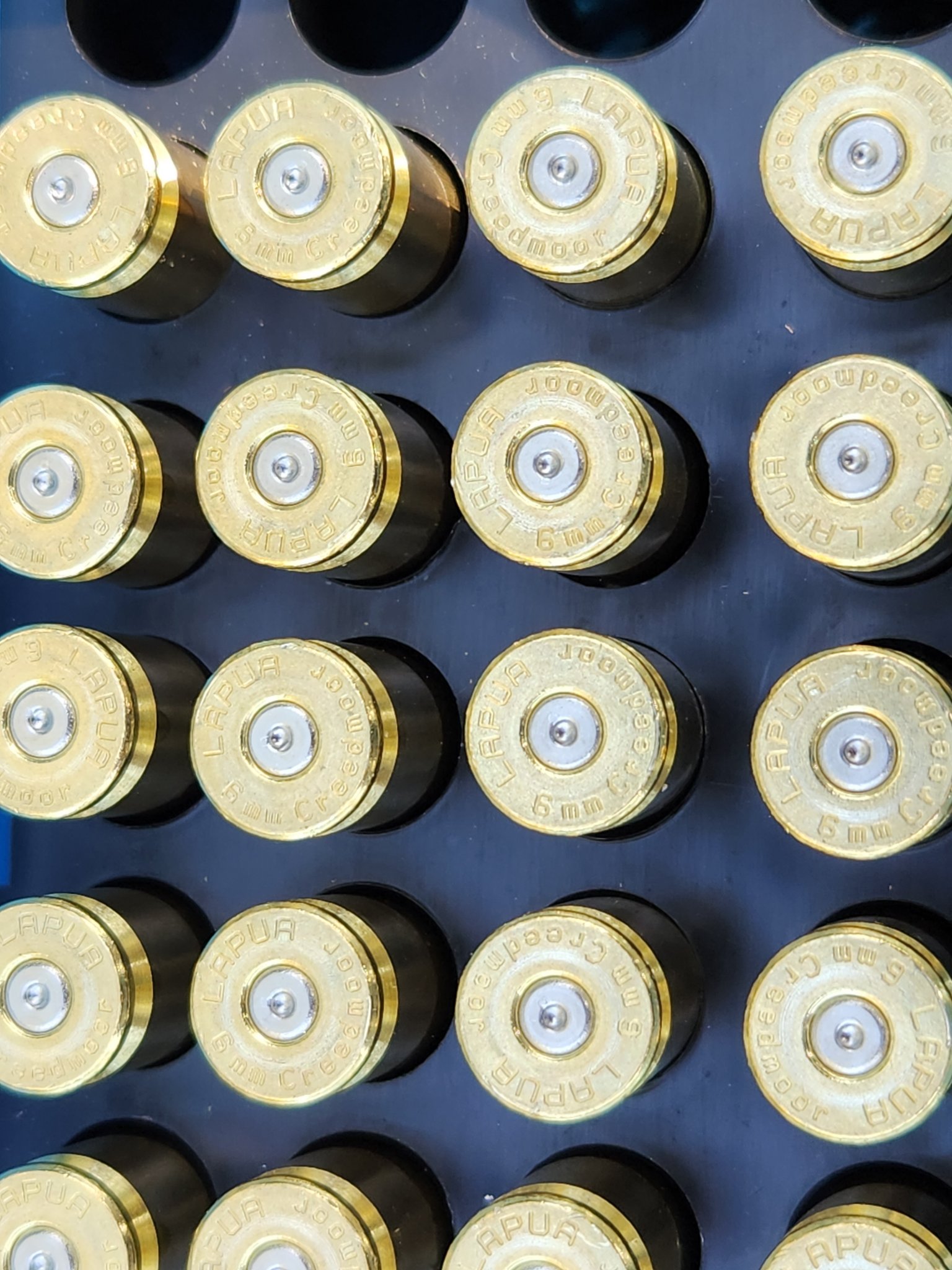

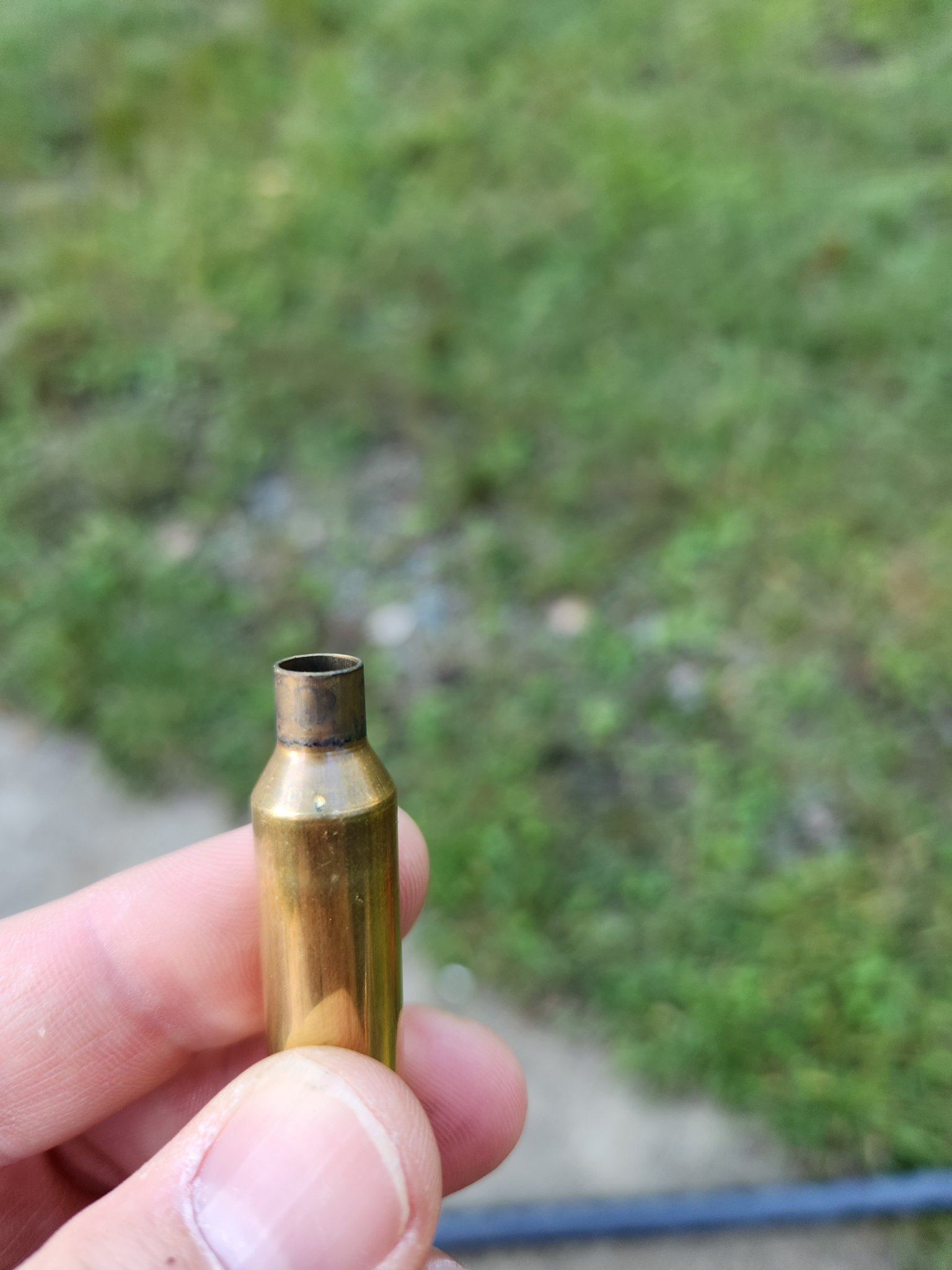

So there's this ring around my primer. I'm not sure what to make of it. It is NOT present on my factory ammo

Measure a fired case as well, see how much it’s growing.
Agree next I’d check your not in the rifling with your bullet.
Next I’d insider last time you cleaned and how well it went.

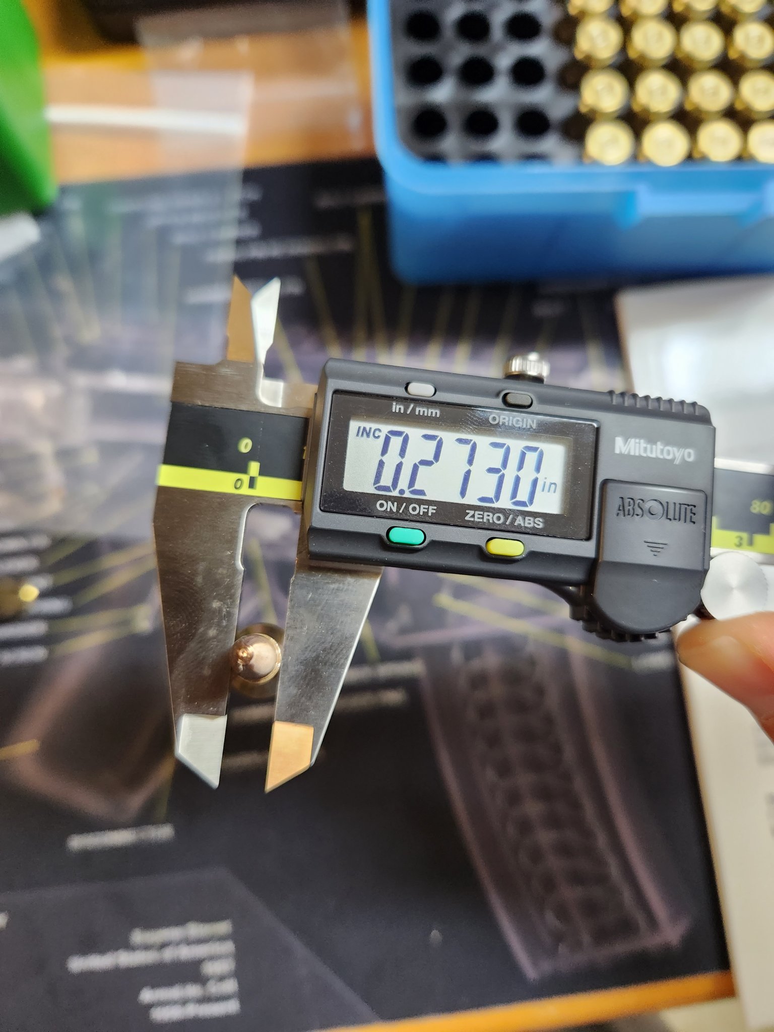

If your necks are .273 all the way (no lip on the mouth, etc), then you should be fine there. Saami for 6cm is .276. I prefer a bit more than .003, but .003 is fine.
If your chamber is tighter than that for some reason, that could be an issue. But if it's Saami, the neck isn't the issue.
