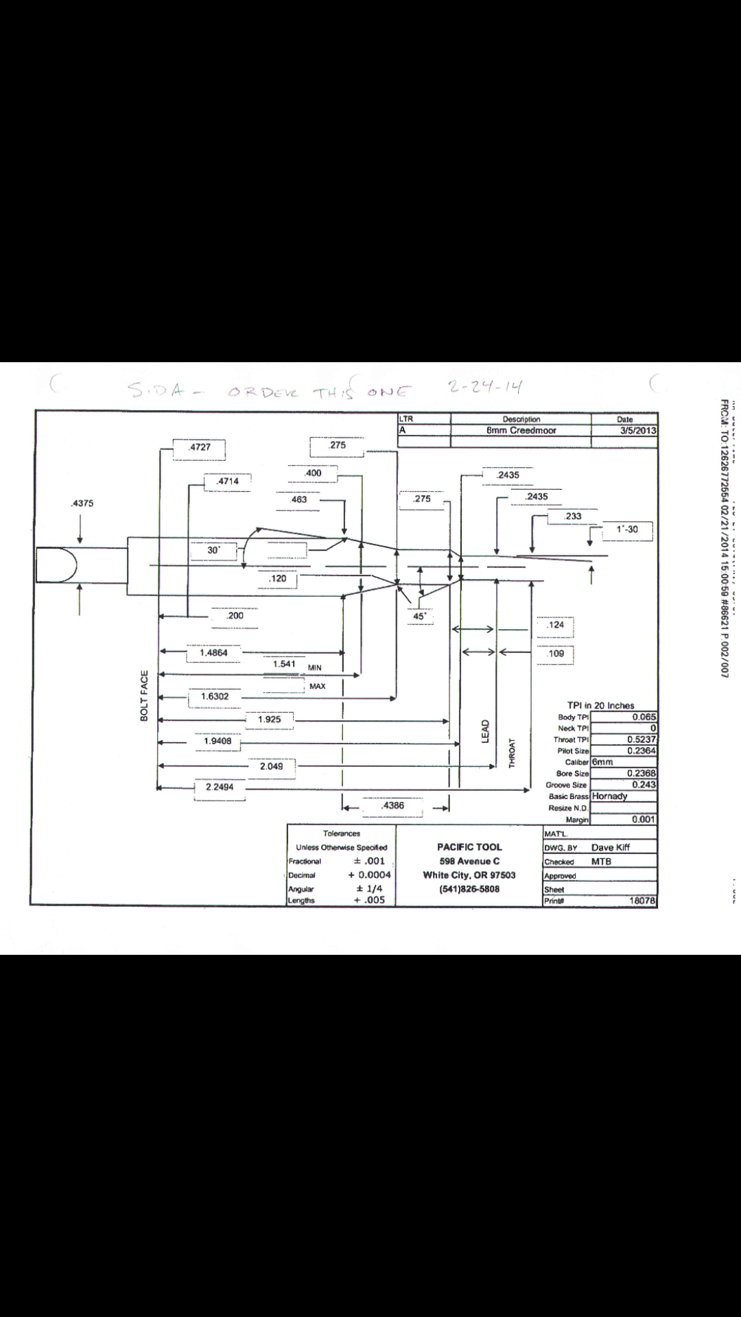

Theres the reamer print. I also have the reamer print for the 6mm creedmoor match chamber, which is what it's looking like I needed. The match chamber has .183 freebore so I'm sure this one is less.

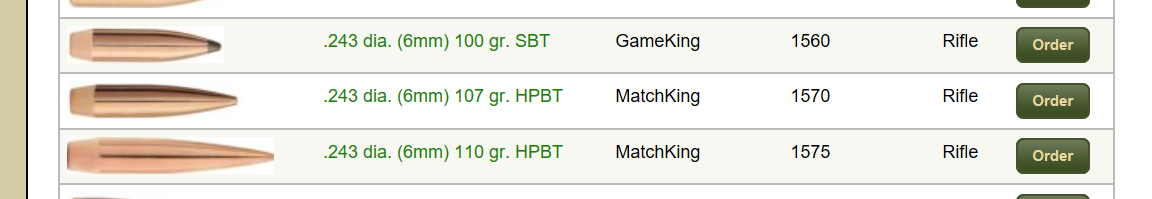

I can tell you from experience, that .109" freebore is perfect for a 110 Sierra. Even running a sleeker ogive bullet like a 105 hybrid will result in the boatail junction being below the neck-shoulder junction in your brass.
You either need to ream your throat some, or switch bullets.
I've attached a file, if you look at your bullet and the 110, you should be able to visualize what is happening.Capture6.PNG
If you are not planning on running Hornady bullets or a dtac, I'd steer clear of that match reamer, my .02
You most likely ordered a prefit, this is what I would do. Get a Hornady oal tool, a modified case, find a smith close with a throating reamer(unithroater), take your rifle, tools, caliper and comparator and set your freebore for your desired bullet.
I'm making the assumption you are new to custom chambers, as you go you'll learn reamer selection plays a big part in your success. With reamer info, guys or the smith can help decide what bullets will shine.

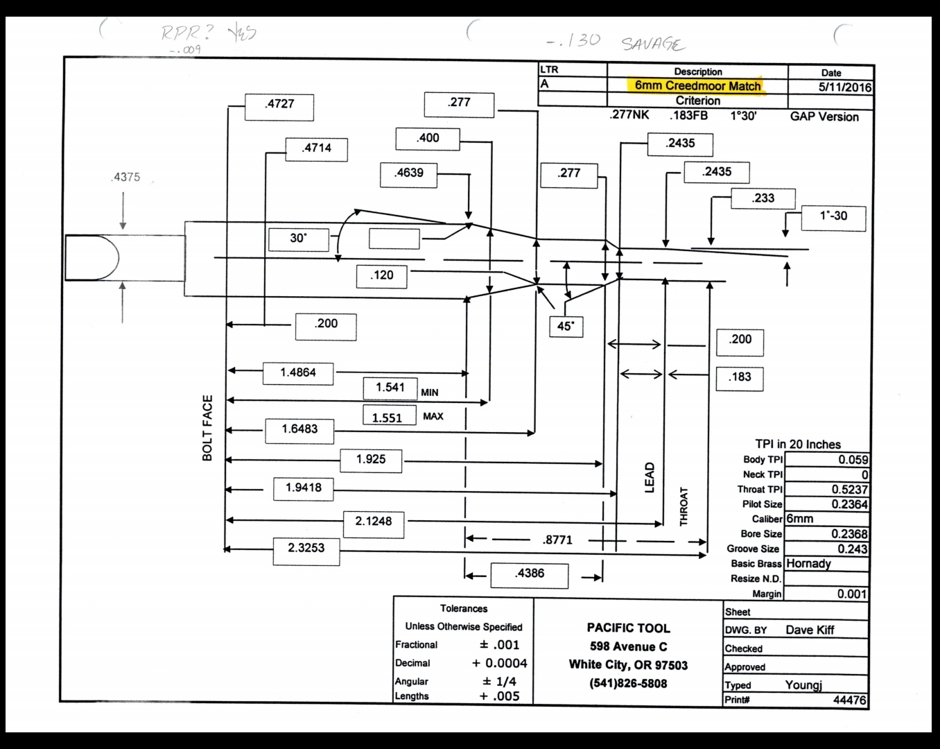

Here's the match chamber reamer. Is this more along the lines of what I need for the 107 smk?

Yeah that's the .183 freebore which would work better for your bullet of choice. It's what I use with the 108 ELD-Ms. I am at about .020" off the lands at about 2.795". Just need to figure the bullet you will use and get the right chamber set up.
Ok, I got the barrel back from criterion which they rechambered ro their 6mm match chamber. First let me say that criterion was excellent through the whole process and didn't charge me a dime which they didn't have to do. Now with the 107 smk, the bullet touches the lands at 2.796. This definitely sounds better to me. I'm thinking of seating to 2.775, this should now give me plenty of room for powder right? Within the cartridges limitations of course.
