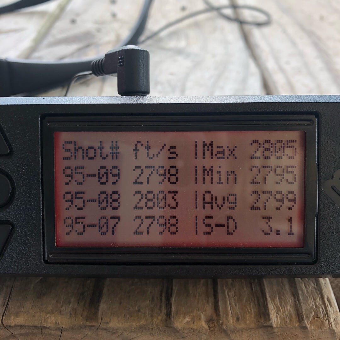

So for anyone else that may use this set up.this weekend at MPA I used 34gr rl16, 110smk 2.4 coal, not sure how far off it is as I don’t have a modified case yet. Br4 primers In hunts long range hydro formed brass and after the new barrel settled it it was right at 2800fps. No pressure or anything even with the large FP primers were good. I’m gonna work up a couple loads to see what my limit is for reference but the rl16 preformed perfect. 26inch kreiger 4 grove 7tw is the barrel. Phot is the last nine shots I had after the match over the magneto

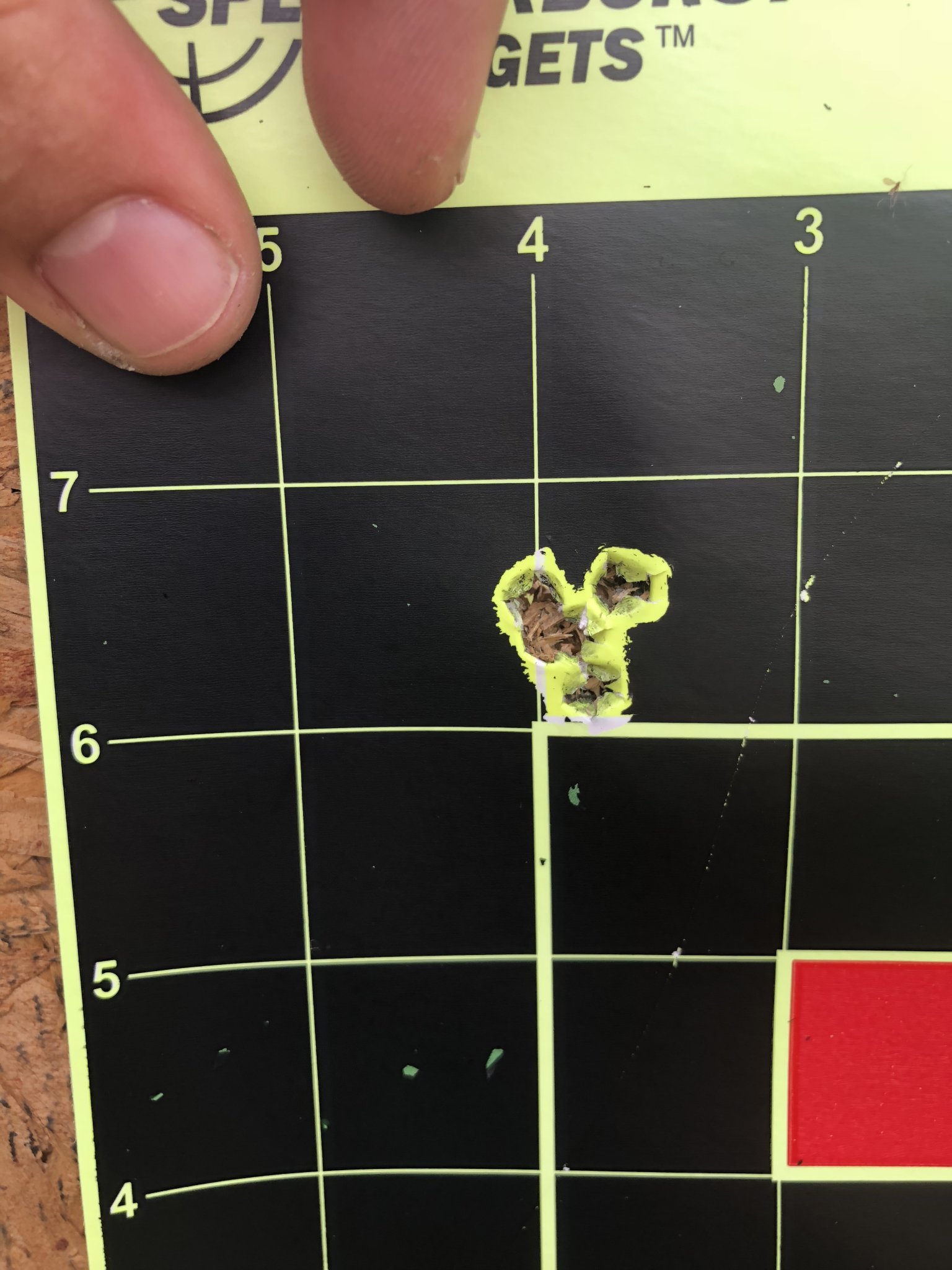

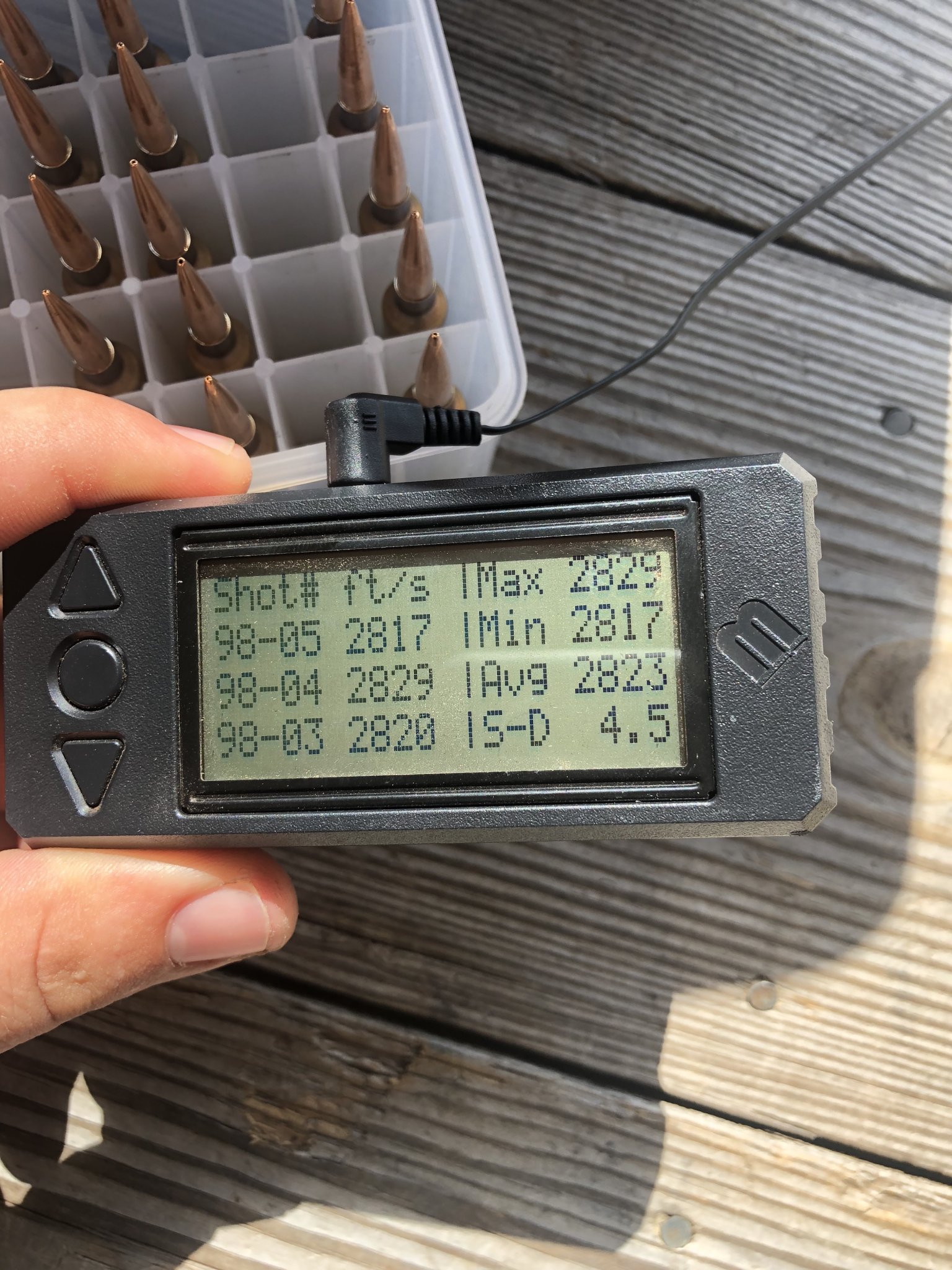

So with the brass being fireformed now , I annealed and did a ladder test, 34.8gr rl16 got 2900 with no pressure what so ever. I have a nice node at 2820 so I’m just going to stick with the 34gr that in the formed brass sits me right at 2820. Probably could get to 3000 if I really wanted but it shot great at 2820 at LPRC this last weekend. RL16 seems to work in the dasher just fine. Here’s the 5 shot 200 yard group and the magneto speed.
