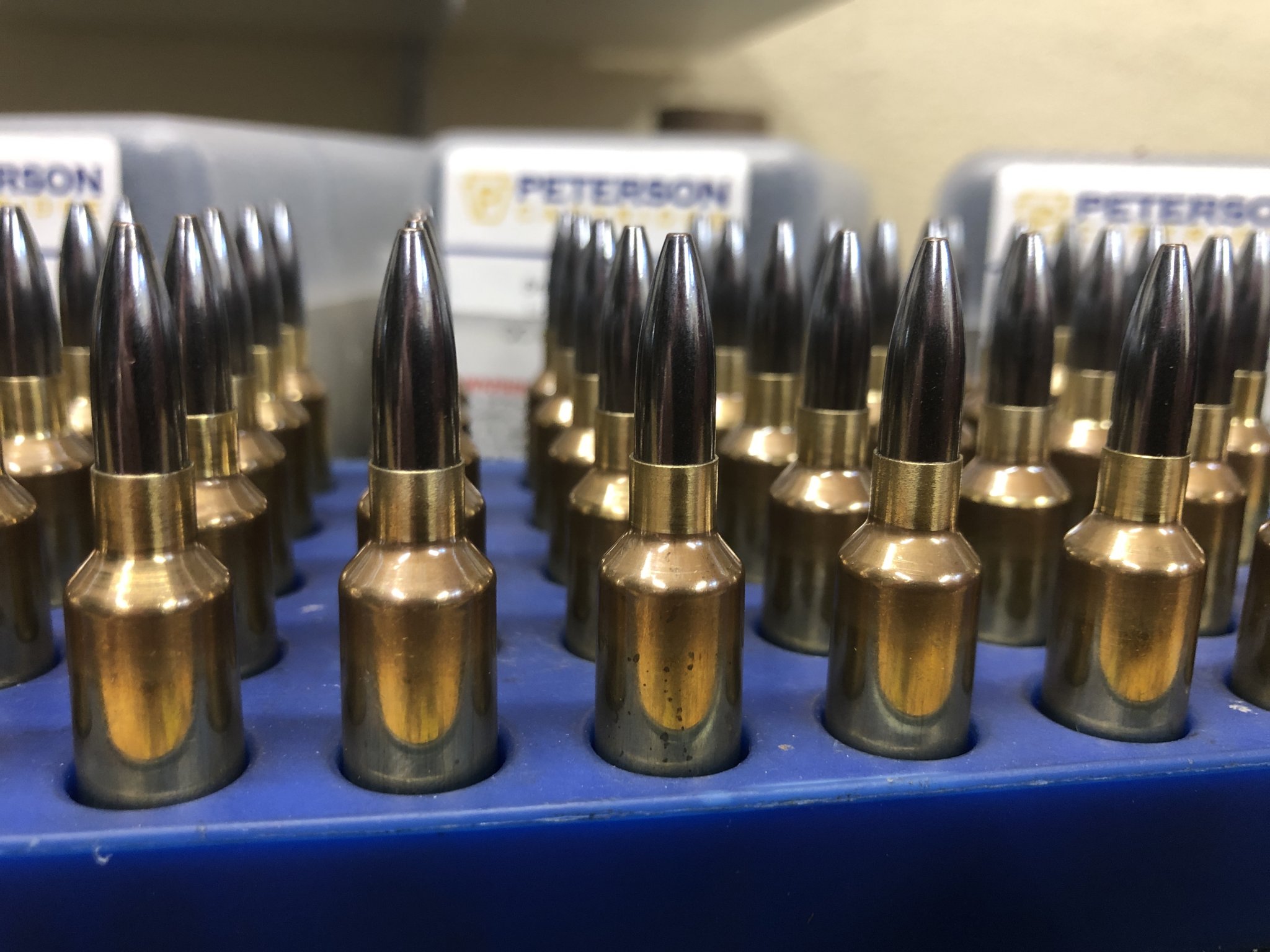

On my new Dasher barrel, for fun I’m going a different route to see if it makes a difference in its’ life span.
Not finding Varget or Norma 203B, which I used for my previous barrels, I’ve tested and switched to VV N140, a single base powder which has a little “cooler” burn then some others. Also, I’ve gone back to coating my bullets with Tungsten Disulfide, WS2, which worked really well when I was shooting F-T/R a few years back.
The barrel life calculators say it should matter, we’ll see how it plays out. Here’s some Peterson Dasher brass I loaded this week with WS2 coated bullets.
The barrel life calculators say it should matter, we’ll see how it plays out. Here’s some Peterson Dasher brass I loaded this week with WS2 coated bullets.View attachment 8039753

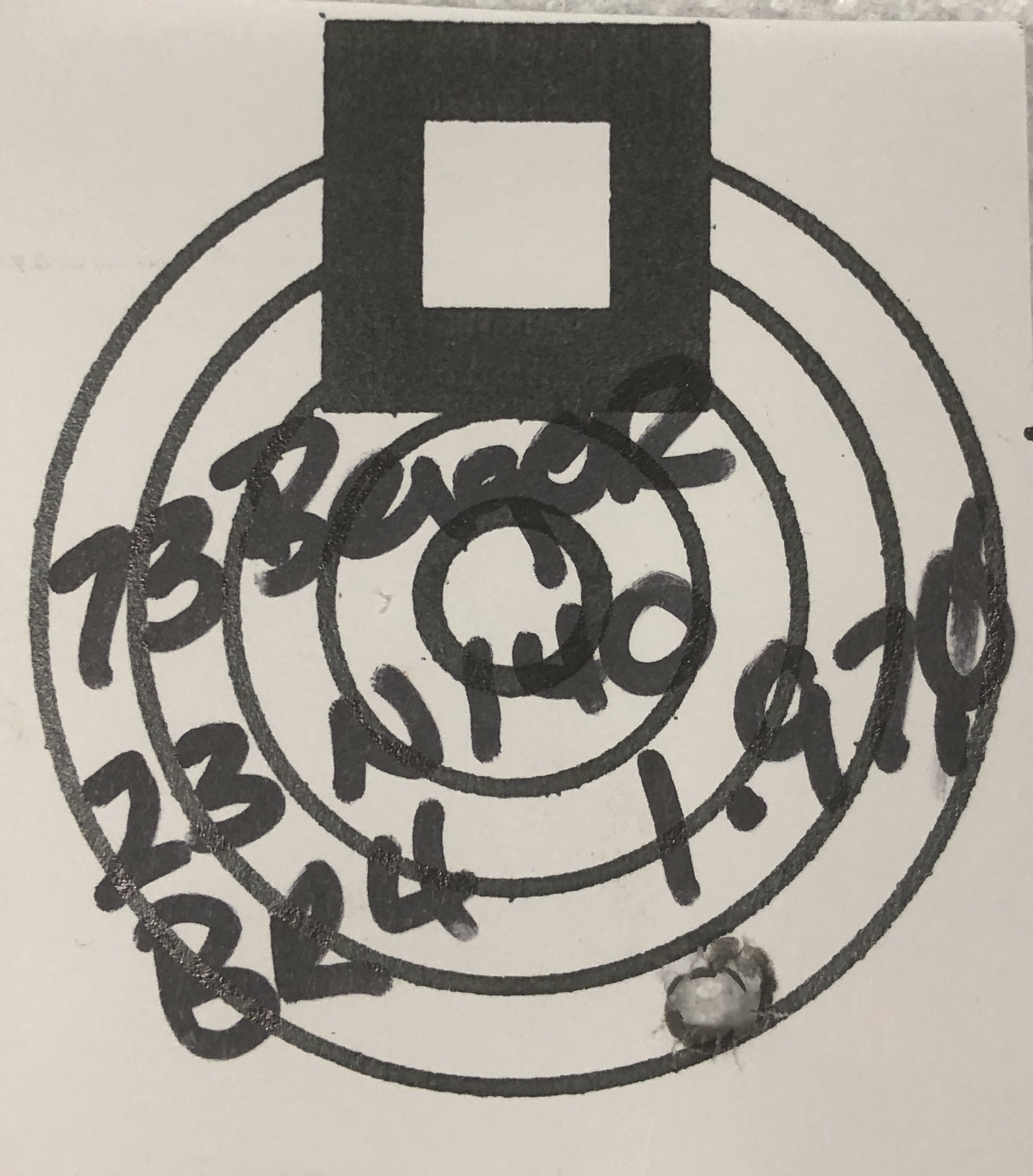

I don’t usually save “wallet targets”, but this one was stupid good. It’s a 223 test for seating depth, 1.970” is the LTO, 73 grain Berger’s, 23 grains of N140 and BR4 primers. 5 shots at 100 yds.
