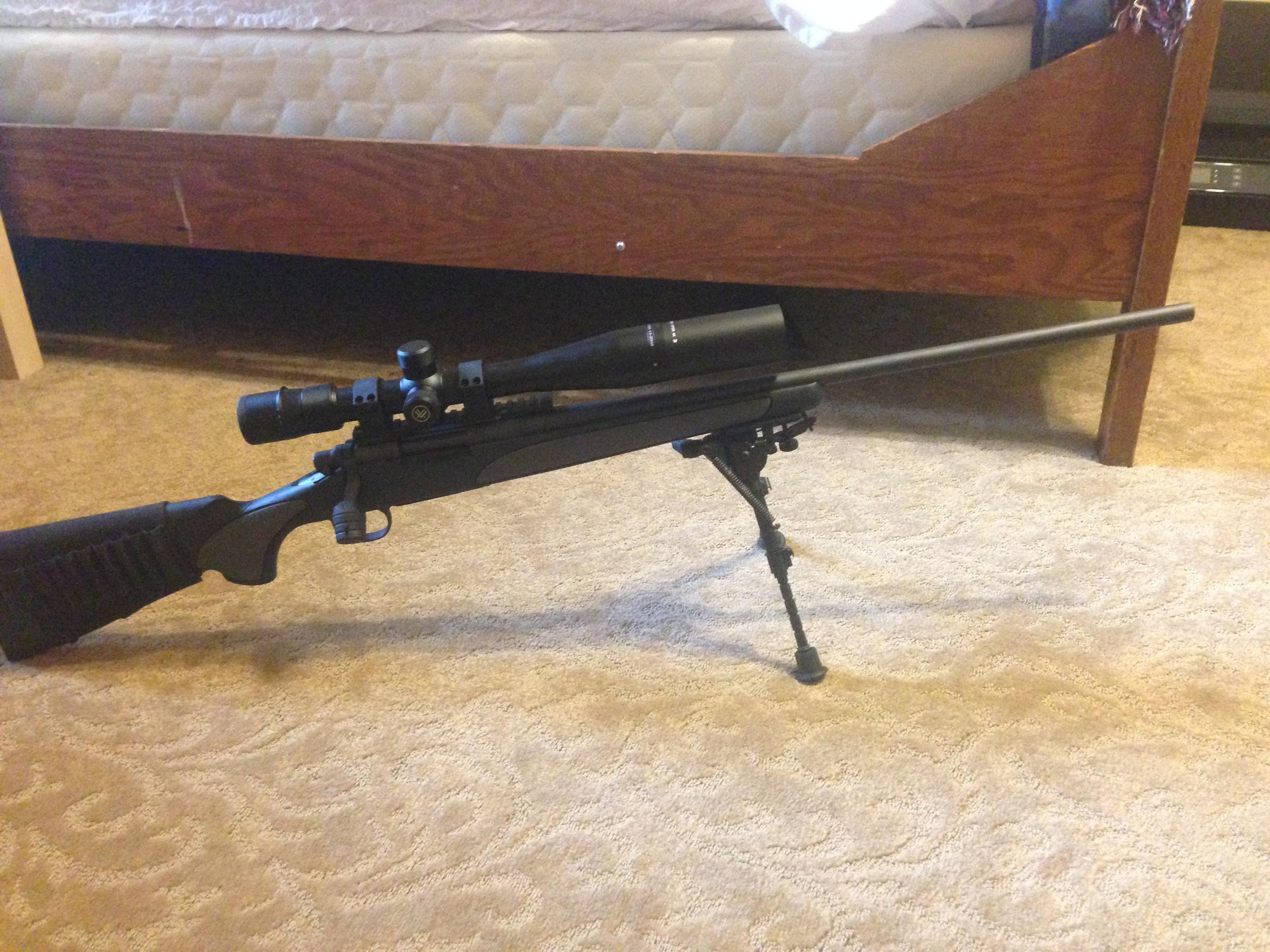

Update: My scope and scope rings came in the mail today, and I will say, I am very happy with my choice. I was very hesitant to spend the $100 on the Vortex Matched Rings, but after sucking it up, I went with them, and haven't looked back. The construction is outstanding relative to the $20 Leupold Rifleman Rings I had before. As for the scope, I haven't had a scope this nice before, so I have nothing to compare it to, however, I am very happy with the glass quality and features on the scope, especially for the price. Again, thank you to everyone who gave their two cents, I would still be researching today trying to figure out what's what. As promised, here is the current build:
(Click for enlarged image)
