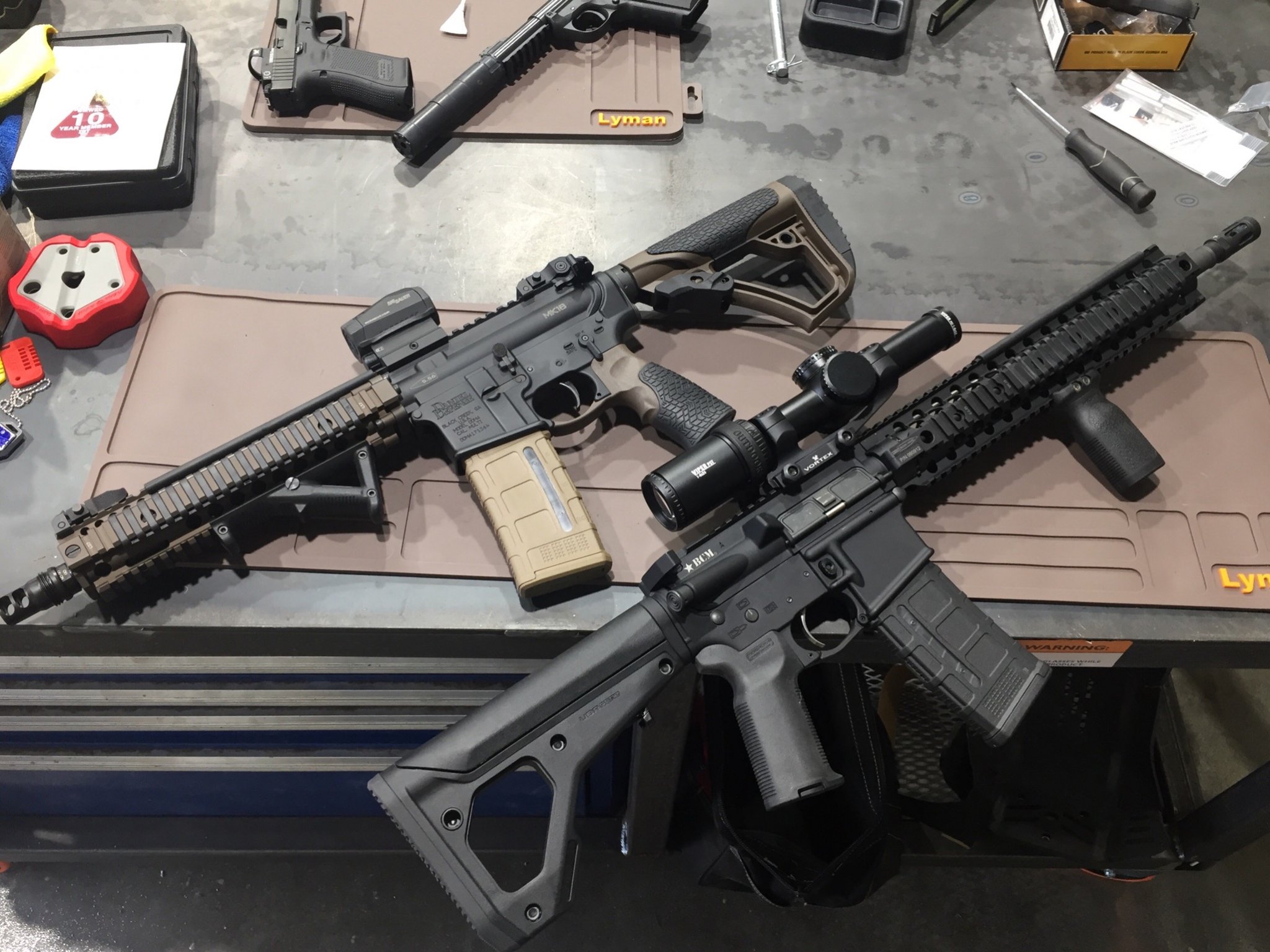

I signed up for a 10k where you have to be able to do all these obstacles and also engage torso sized steel out to 600 yards. Have to carry a rifle and pistol with 50-60 rds of each minimum.
The guy says ar platforms are usually the most competitive but I’m worried I won’t be able to hit jack at 600 with either of my ars. How hard will that shot be considering I’m in pretty good shape but have never even shot that far. Longest range I have to practice at is 400.
I have a dd mk18 10.5” and a bcm 14.5” with a pst gen2 1-8. Other option is to carry my ar10 5-25 but it’s crazy heavy.

I would run the 14.5. Should have more than enough ass to get to 600. The -25 will just be heavier, and shoot essentially the same with more recoil. A hit is a hit so the additional energy is not really needed. Now a 6.5G AR may be a little more forgiving with wind but you should be fine. I would look into 69GR SMK, 75GR Hornady BTHP and 77GR SMK. Those will perform in the wind a bit better.
Make sure you build out your dope and find a 600 yard range to verify.
Upgading to a vortex G3 Razor would make it alot easier. More mag, better glass, better holdover reticle.

You'll wanna collect data, that's key. 600 is about the max for 14.5 and 62gr. ammo --you can push it a bit farther and then it goes trans and it's more about probability and less about skill. We trained SDM's on M4's and 600m was the max distance. With an ACOG.
77gr. will push it comfortably further with less effects on the round.
I was pretty good back in the day and ran a bunch of a stress shoots, my favorite was to just squat with a hasty sling, take the shot and move on. Damn near as good as prone if you're flexible enough to ball up and put your ass on your heels.
Good luck.
I've had my 16 inchers, 15" and 14.5's all to 800 with surprisingly good results. Just took the 13.7" out to 720 the other day and and maintained 60-70% hits with winds varying between 7 and 13mph. Posted video of it on here somewhere.
This is on a 16" circle, so about 200 square inches of target area. A full sized IPSC torso is over 450 inches. You'll be fine.

Your 14.5 with 77 or 69 SMKs (depending on what your rifle prefers) will get the job done at 600 man. Run the optic you have. It’s the best way to evaluate your equipment.

I was staff at the last RB run n gun. I used a 13.7 Noveske on a MK6 with 55gr to make the the 600 yard shot. Between what you have, running the 14.5 would likely be the best bet. Given the weight of an AR10 plus an optic like that, I wouldn't go down that route for the sake of a single stage.
