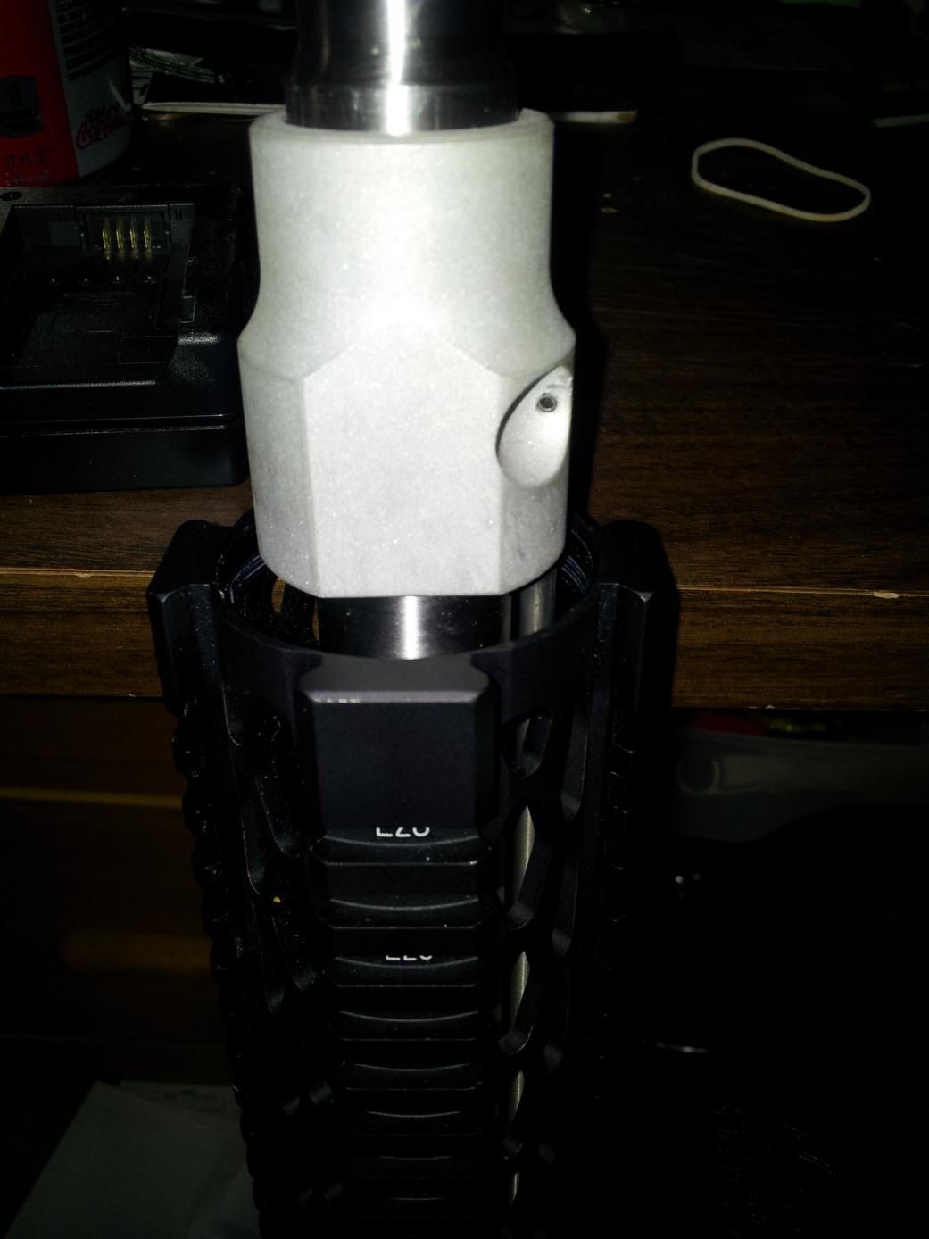

It uses a standard gas tube with the dog leg bend which puts the gas tube hole pretty close to the barrel.
It is basically cylindrical with flats cut on the sides; the OD is 1.490" and it's 1.25" across the flats.
I attached a crappy cell phone pic, hope this helps.
Joe
*edit* well, I attached a picture but I sure can't get it to load from the thumbnail, sorry about that.

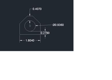

The Seekins SP3R isn't "2in in diameter" but rather 2" wide across the flat, bottom of the handguard.
Here is a link to the diagram I was looking for earlier and couldn't find on the ID of the SP3R handguard (its about half-way down the page...ignore the thread title...its the diagram included in the thread that's important):
NEED HEATSEEKINS ATTENTION - Osprey OPS-416 piston system with iRMT3 & SP3R - AR15.Com Archive
In your case, OP, just substitute the 0.750" barrel for your 0.936" barrel and adjust the outer clearances accordingly and you should be able to determine, with JP's or Scudzuki's numbers whether it will clear.
According to that diagram, it will JUST fit.
The supplied gas block could easily be cut down for more clearance in the regions where it might contact (the bottom will theoretically have only .002" clearance, not enough for a free float system).
If you have a friend with a mill, have 'em whack 1/8" off the bottom of the GB.
Alternatively buy a low profile GB. Myself, I have a machine shop, so it's obvious which way I'd go.

According to the diagram in the link provided the SP3R is only 1.8" wide instead of 2". If I use the measurements in the diagram and adjust the clearances for a .936 barrel and take measurements from the JP gas block I have here, then it is very tight. You would have .1" clearance on top, .23" clearance on the sides, .112" on the angles, and only .079 on the bottom. It is so close, especially on the bottom, I would think it would not work. The one I am using to measure is not installed and the screws are all the way down pulling the block completely together- it will not be that tight together installed over your barrel. 1/16" gap will leave it touching the bottom of the hand guard.
The JP calls for a 1.75 ID so that it will have .05" clearance on all sides. It looks like i will be meeting that space requirement. Think I'm going to give it a try. Worst thing is that I have to return it and get something more simple.
Only problem is that according to the linked drawing, the overall inside height is 1.622" and not 1.75". However as I said, it looks to me like the closest measurement will be about .079" on the bottom. Interested to see how it comes out. Please let us know. I hope it works for you. I have 2 of those gas blocks and I really like them. If JP would just put a stop for the adjustment screw so you wouldn't have to loctite it...
Yeah. I am seeing the same thing. It's going to be tight, but it's only recommending .05" clearance on all sides. I'll let you all know what happens, but it will be a while. Found termites in the house and that sucked up all my "damnit-this-was-for-my-build" money.

Update on the clearance issues for those who are thinking of running this rail with that heavy-contour barrel:
It is not possible. The smallest low-profile gas block I could find has a 1.25 OD. You only have .280" total under the barrel. With that, you have to fit your gas block, space between your gas block and rail section screws, and the rail section screws. It cannot be done with this handguard (15") and a .936 barrel.
For now, I'm just going to move the bottom rail section back a few inches so there is no issue with the gas block. Defeats the purpose of having the 15" handguard, but right now I just need to get it running without incurring more costs.
If you're available on Saturday and want to come by the Shop I can take a look at it. I may need to do a little machining on it but I bet that it's not "impossible" I'd do the work for free if it means that you're shooting in next months match. I can put you between me and the "Dirt Thrower".

Here is the JP .936 adjustable gas block stuffed in a Seekins 15" SP3R
Out of curiosity, I'm assuming that SP3R is the v1 (non keymod). Looking at my SP3R V2, the key mods stick out very very little. I was wondering if you thought the top rail would fit with that gas block.
Looks great. Quite the fit.
