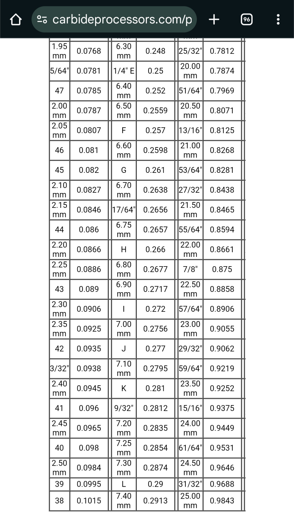

Instead of reducing buffer weights and spring rates, I would recommend just opening up the gas port. Instead of biasing the operating system to one extreme and with specialty springs and buffers in order to compensate for an incorrect gasport size. I would rather baseline the buffer weight and spring with a conventional and middle of the road back end, and then just make the gassing correct. Like just keep a rifle length, green springco and an A5 H2 or H1. So you have a little bit above and a little bit below to select from when you change loads. And then work the gas port to get it to operate reliably with a solid buffer system.
Talking about drilling out a gas port scares a lot of people but it is a pretty easy task. You just need to make sure that you don't over penetrate. And there is potential to clean up burrs or a little bit of port erosion with a fresh cut larger hole. You can order a #41 or a 2.4mm bit to step up from .093". This is exactly how my gunsmith gassed my custom 6.5CM barrel, albeit with a mill instead of a drill press or hand drill. I set up the SCS in the buffer weight and spring color I wanted (middle of the road configuration) and we just went up in bit size, firing into a clearing barrel with a proven load, until it locked back. Then you can fine tune, adjust a buffer weight up or down to account for cleaning, changes in powder and loads, etc.
Thanks for the tip re: drilling out the port hole. I was curious what type of bit people used for that. I will keep this in mind if fixing the bolt drag doesn’t resolve the short stroking.
