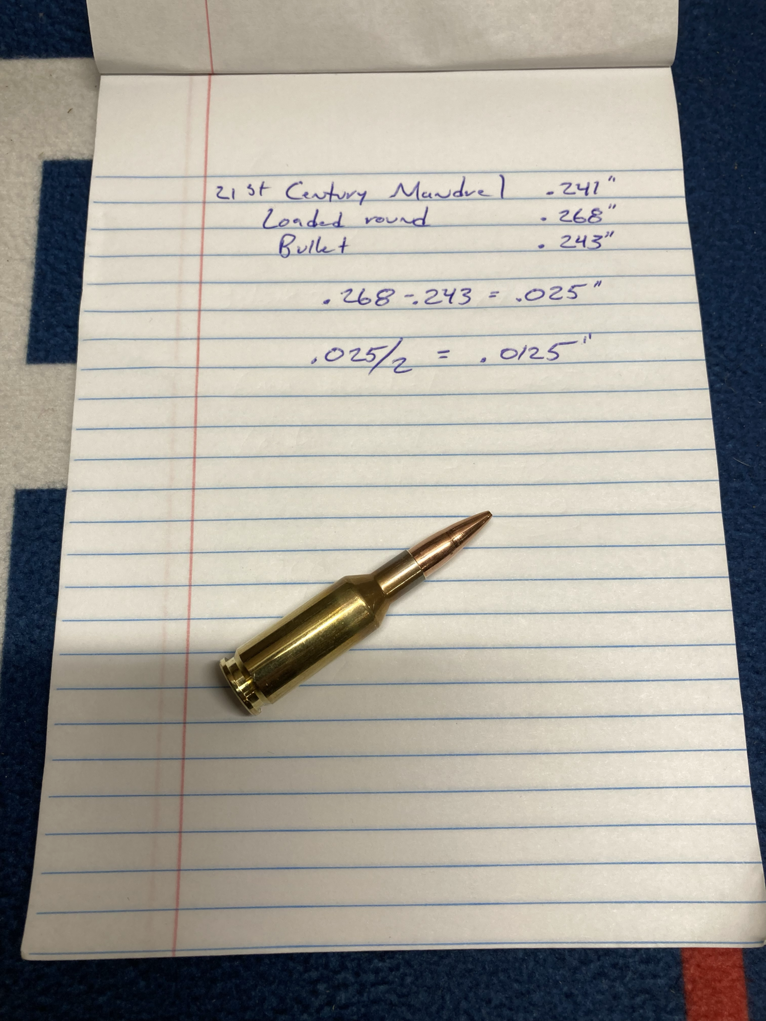

So here are my measurements spife, they mirror yours pretty well. On the Forster Form it says if not using an expander ball to take .002-.003' off of loaded round diameter but may require new dies for new or aged brass. Are they not assuming the use of an expander mandrel?
Should I resize a piece of brass to get an exact measurement of where it lands with the die before I move forward? All brass is brand new.
Another thing I noticed is that the seating stem doesn't seem to match up to well to the hornady 105 as the bullet shows.

If not using an expander take .002-.003 so that you end up with ~.002 inside neck dimension below bullet diameter and then minus the little bit of spring back. So yes, that’s a worst case scenario. You don’t want to take so much out of the die that it can no longer properly size down.
If you are expanding you can leave a bit more in the neck and go .003-.004 below loaded round diameter.
I wouldn’t worry about sizing the new brass. That neck isn’t gonna change diameter much if any. As brass gets fired many many times it generally gets thinner so that’s why they talk about the old or different brass.

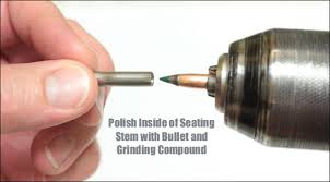

And you can send in the stem with the die and they should lap it up but you can also just do that yourself.

That looks like excessive seating pressure is squishing the projectile.
I was thinking kinda the same thing when seating it but I honestly only seated one bullet to take some measurements. This was Lapua brass and I ran my turning mandrel through it first as well. This morning I ran the turning mandrel through a few pieces of virgin brass and it seemed to have little to no resistance at all.
I also took the die apart the 105 hybrid definitely fits contours of the seating stem better but the hornady 105 bt didn't seem too bad.
I have noticed that with my Lapua 308 brass that on the first loading the seating pressure seemed to vary some so wonder if this will be the same.
Im still a few weeks out on my barrel getting delivered so I cannot take any CBTO measurements I was just guessing when seating this and think I might have went a little deeper than I should have. COAL of that round was around 2.25 I believe.
