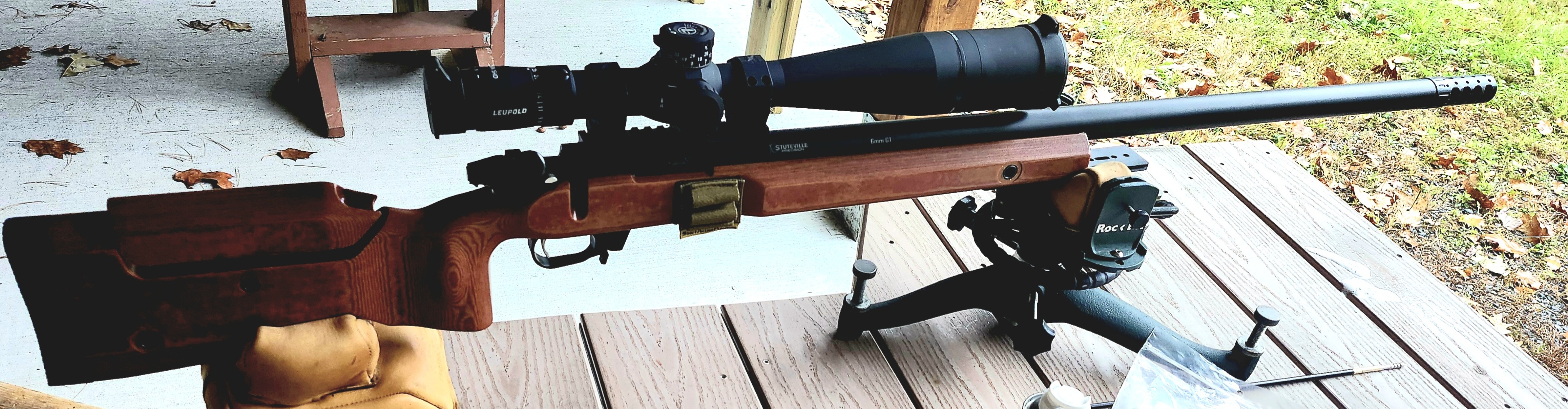

Essentially an Okie special, with an Impact action, Stuteville 28" Comp CRB barrel, and Foundation stock. Trigger is a BnA. Components selection and setup I primarily picked up from here on the Hide. I must say that these suppliers were wonderful to work with and highly recommend them.

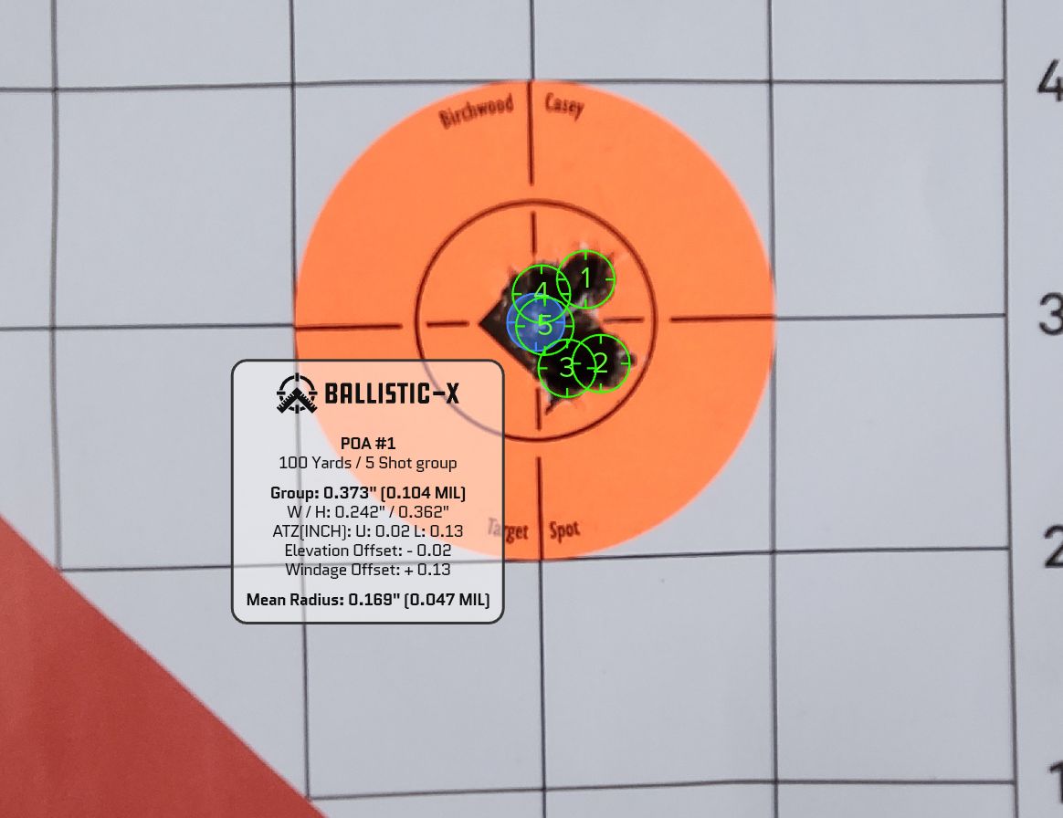

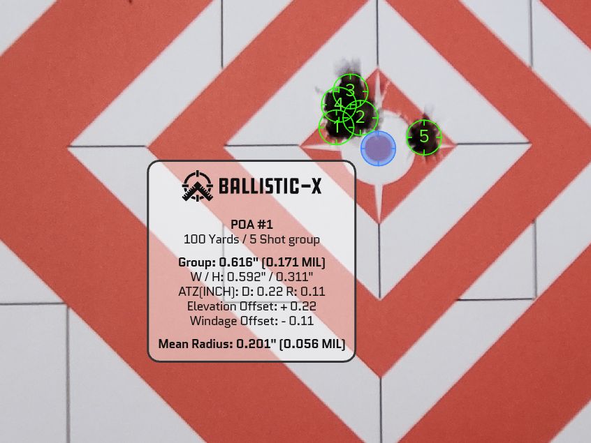

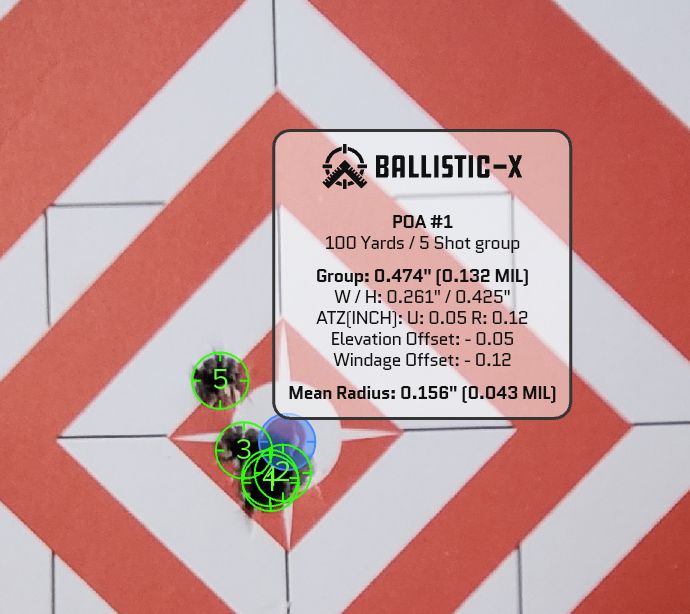

Thus far I've tried a couple loads with Berger 105 Hybrids and 115 DTACs. So far the 105's and 34.2 gn Varget are grouping the best but the ES seems a little high at 18 fps. The DTACs and 32.6 gn Varget are getting SD 2.7 and ES 7.2 but the groups are much bigger than the 105 groups. I'm weighing to single rod of powder accuracy via an A&D FX-120i and was expecting better than the 18 fps ES (5 shots) I get with the 105's. Averaging 2909 fps. New Alpha brass and CCI 450's. Shoulder bump at .005" maybe a little high? Jump is .030". Sizing with a SAC die for .003" neck tension.
Some typical 100 yd groups with the 105's and a best group below. It was raining but at only 100 yards perhaps that's not much of a factor. Best group was the first 1X fired brass I have used and not annealed. Actually, the 1X fired brass gave a 5-shot ES of 13.
