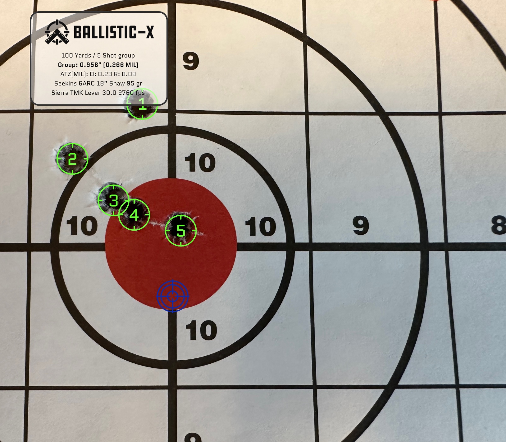

6mm arc 90g Sierra TGK
Not 90 but I did 95 TMK
Seekins 6 ARC 18” Shaw SS barrel, Omega can
Magnetospeed V3
3/22/23
55F 59% 30.31 in
Sierra 95 gr TMK
Lever
Hornady brass x 1
BTO 1.6580
COL 1.4900
28.5 2517, 2545 SD 19.7 1” group
29.0 2623, 2629 SD 4.2 0.4”
29.5 2677, 2669 SD 5.6 0.6”
30.0 2705, 2711 SD 4.2 1”

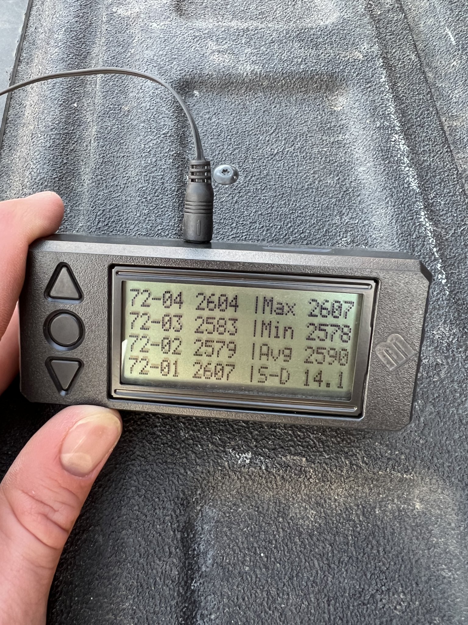

4/22/23
59F 82% 29.83 in
*2x fired brass
30.0 2733, 2759, 2770, 2764, 2756 SD 14.1 30.5 2798, 2799, 2802, 2814, 2814 SD 8.0

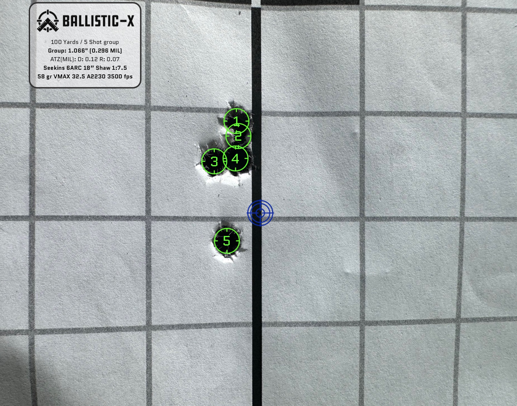

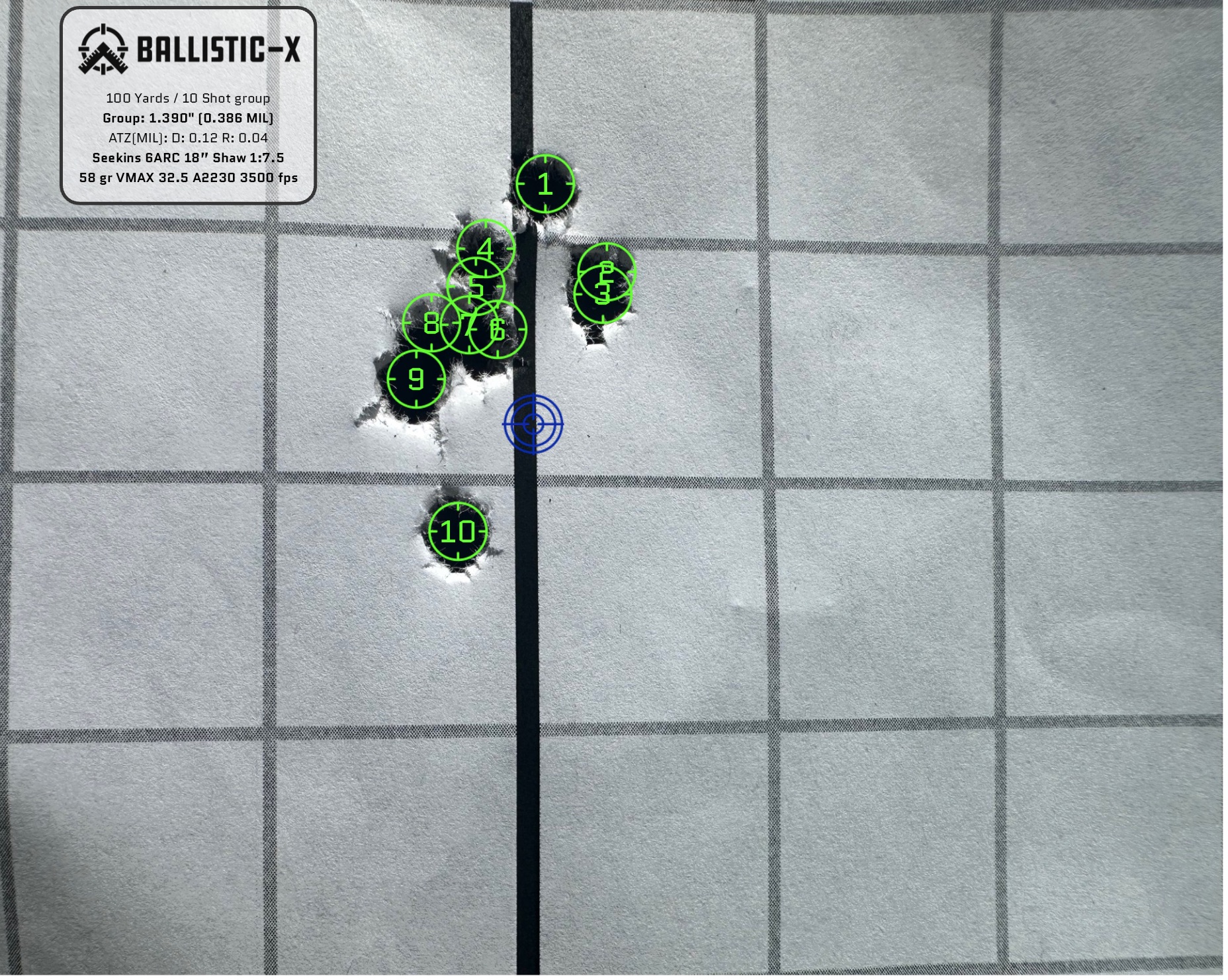

7/27/23
89F 53% 30.11 in
Hornady 58 gr VMAX
A2230 32.5
Hornady brass x 5
205M FGMM
BTO 1.6650
COL 1.4900
3501, 3494, 3496, 3486, 3503 SD 6.6 1” (4 were 0.5” mild pressure
3501, 3494, 3496, 3486, 3503,
3500, 3512, 3505, 3496, 3518 SD 9.1 1.4” (6 were 0.7”)
Ballistic-X-Export-2023-07-27 18:06:47.740985.jpg
Ballistic-X-Export-2023-07-27 18:07:57.817547.jpg

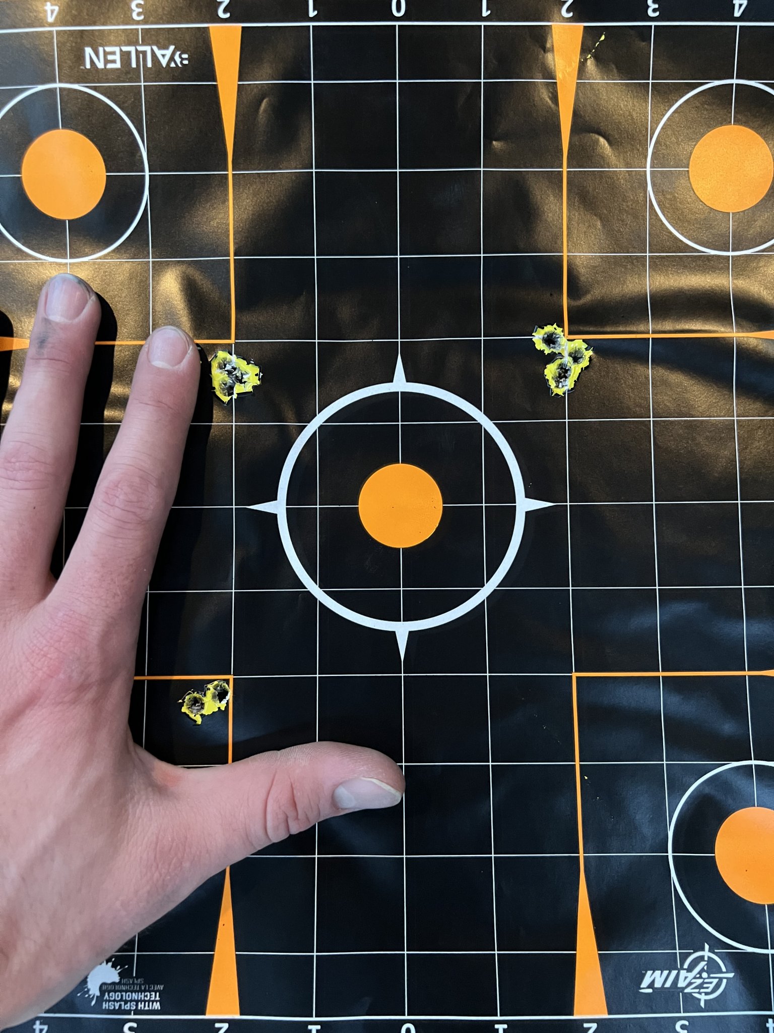

My 6 ARC data from the desert last night. I have struggled to find a load for this gun but I think this is close. Groups are all under .4 MOA. My pointer finger is covering a flyer that I pulled on my first shot… would’ve made the group .75”.
Rifle is all JP except for the barrel which is a 22” bartlein pulled out of a GA Precision 6 ARC.
103 ELDX Horn
1 x fired Horn factory brass
28.6gr CFE223 (max in Horn book, might try pushing this a smidge)
CCI BR-4 primers
My only grip is SD and ES are still not great. I’ve been able to get sub- 10 SDs with this powder charge but idk what is going on there… any comments on lowering SDs would be appreciated… I know that’s a broad ask but a man can hope.

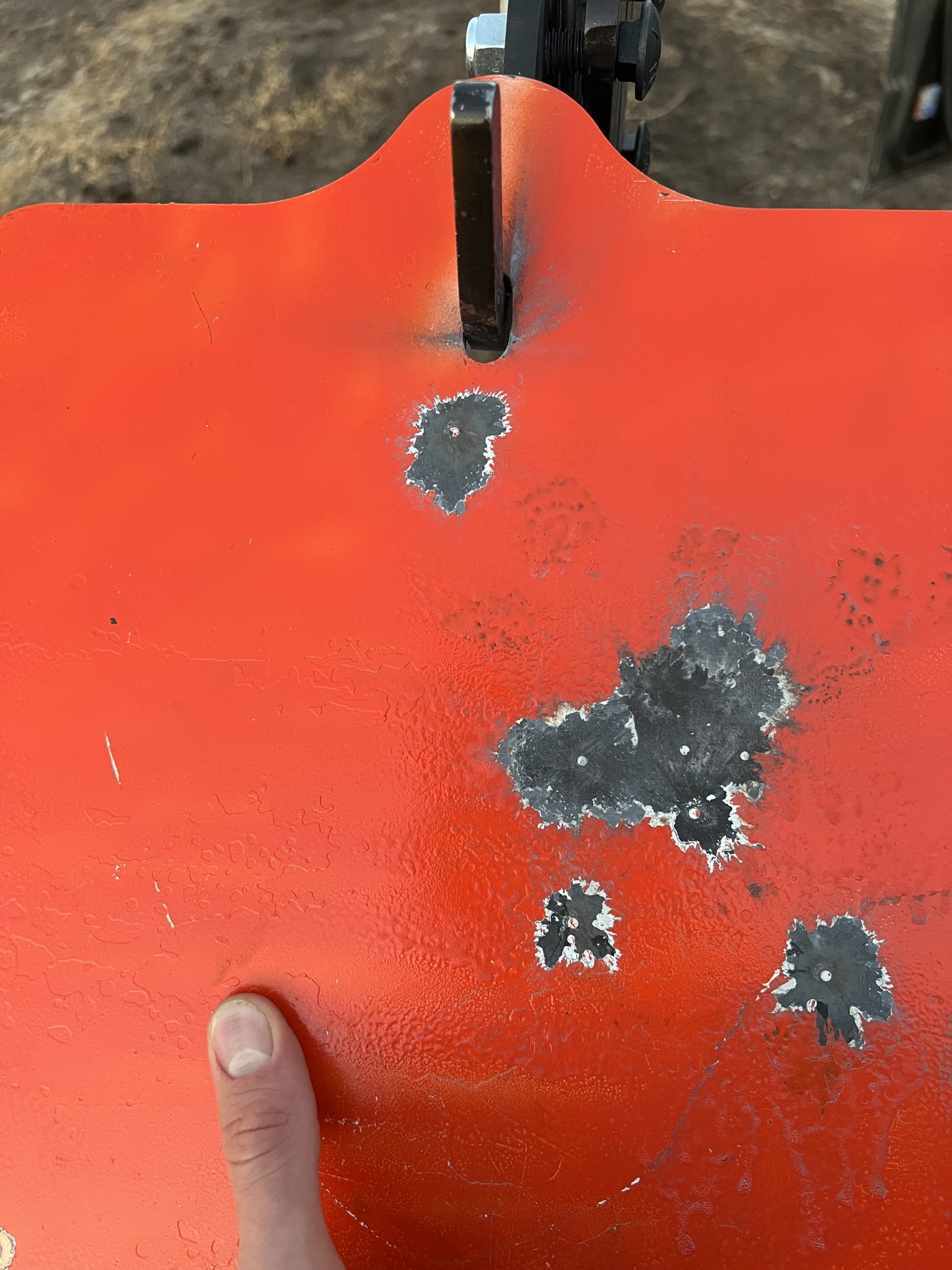

5 shot groups on the top and a 2 shot confirmation after going long. Below is the group I got at 630yds.

I actually switched away from Lever because of temp stability and larger SDs… like 18-19, but maybe I was missing something. I did love the speed. And I have switched to a much better scale so that might help with the SD part…
