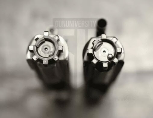

Scary. I was asking as the ARC bolt has much thinner walls than the 5.56 and when they fail, hopefully the damage can be resolved with a simple bolt replacement. Your Grendel experience suggests this is the case.
