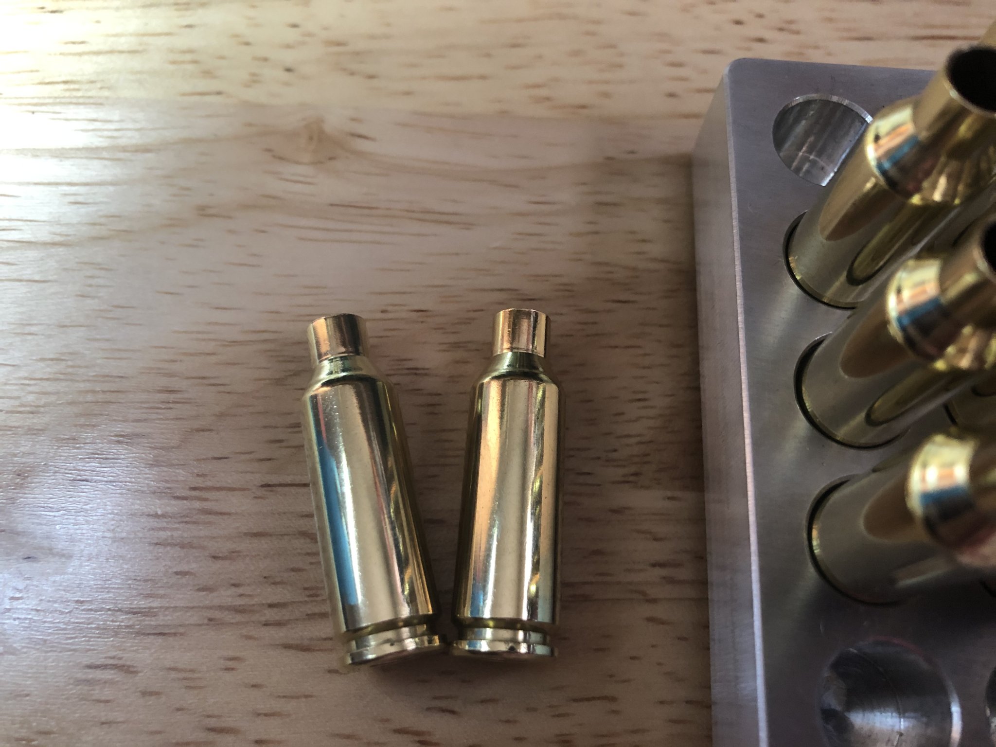

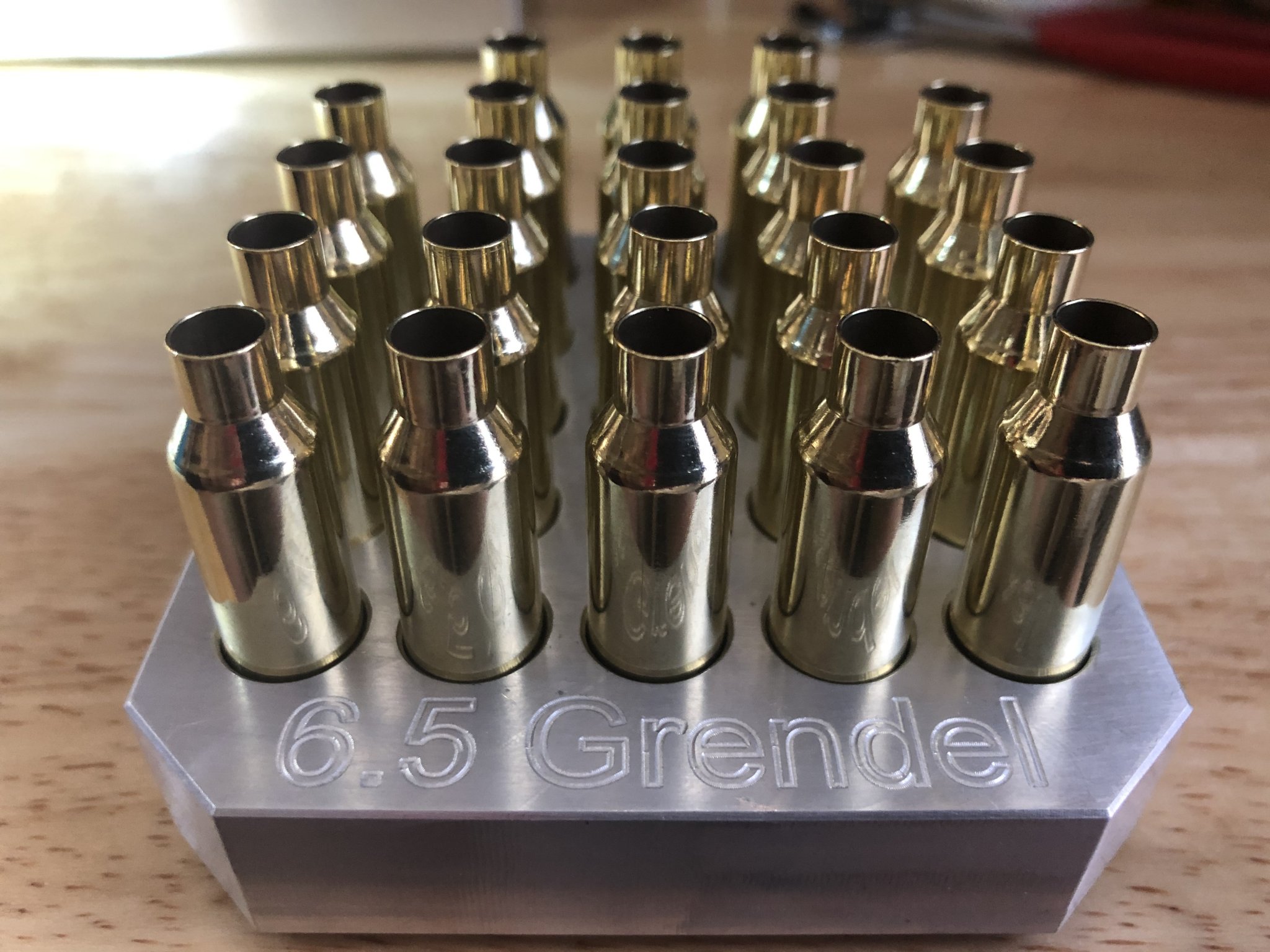

Well you guys were right. It was pretty straight forward. I took 25 Lapua Grendel cases (4x fired) and sized them for 6 ARC. After sizing I had to trim them quite a bit and I noticed some neck wall variations so I turned them, annealed, then steel pin tumbled. I’m going to cut open two of them just to be sure nothing unexpected has happened during the processing. Below is the result. I must say I’m pretty happy with them.

Before you load them try an empty case to make sure it will. chamber in your rifle. Had my ppc dies to bump shoulder .002 from fired case, when I made the brass from 6.5 the base and body was too large to chamber and had to reset dies a little tighter. Ymmv

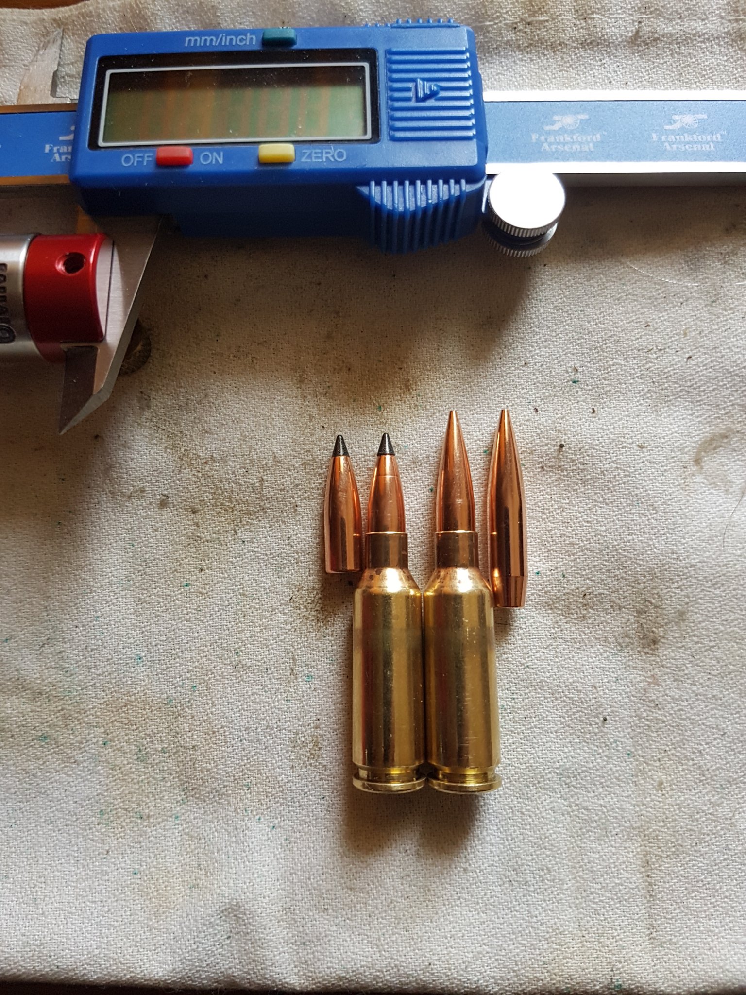

I'm running a cartidge very similar 6mm Chyeeta, and it basically uses grendel necked down to fireform, then just bumping the shoulder 3 thou after fireforming
