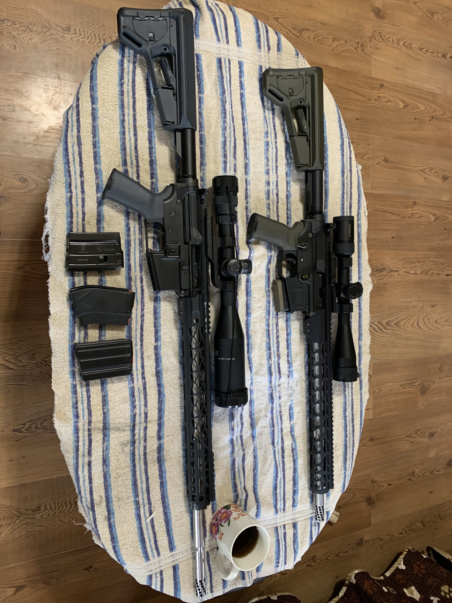

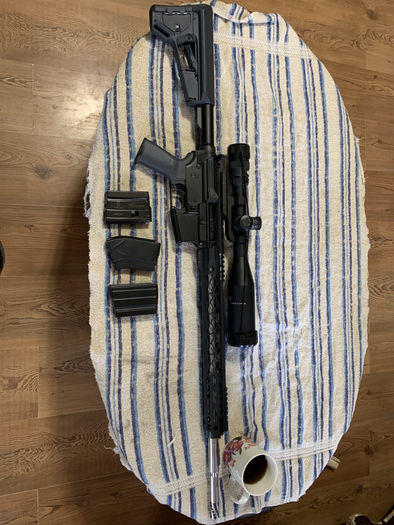

Yes I’m absent one Lancer mag now but there only for my 300 Ham’r so not a huge loss there. The Lancer spring also has less pressure on it compared to me a oversprung Elander, I even filled it let it sit for a month just to see if the spring would loosen up a bit. Maybe I needed to go 3 month? Who knows there, now I am also running a carbine tube and spring with a standard buffer so nothing fancy on that end at all. As for mags I have 3 dedicated mags it’s for the ARC a factory 6mm Stoner a D&H Tactical says 6.5 Grendel but works flawlessly however doesn’t like 2.260 OAL loads they just won’t fit and of course the modified Elander. I have also thought about removing the spring from a 10 round magpul as well just to test if things work out throw them Lancer back together
By the way the 300 Ham’r is one of my favorite 300 yard rounds mine shots sub .5 groups all day long pretty much with any hand load I throw at it.
I think I understand that you were trying to provide less upward push from the magazine to reduce the amount of resistance to stripping and chambering the top round. Correct?
Are you running your 300 Ham'R suppressed?
Yes and worked like a charm. I’m sitting at 13 months now waiting on my form 4 you have to love the ATF these days

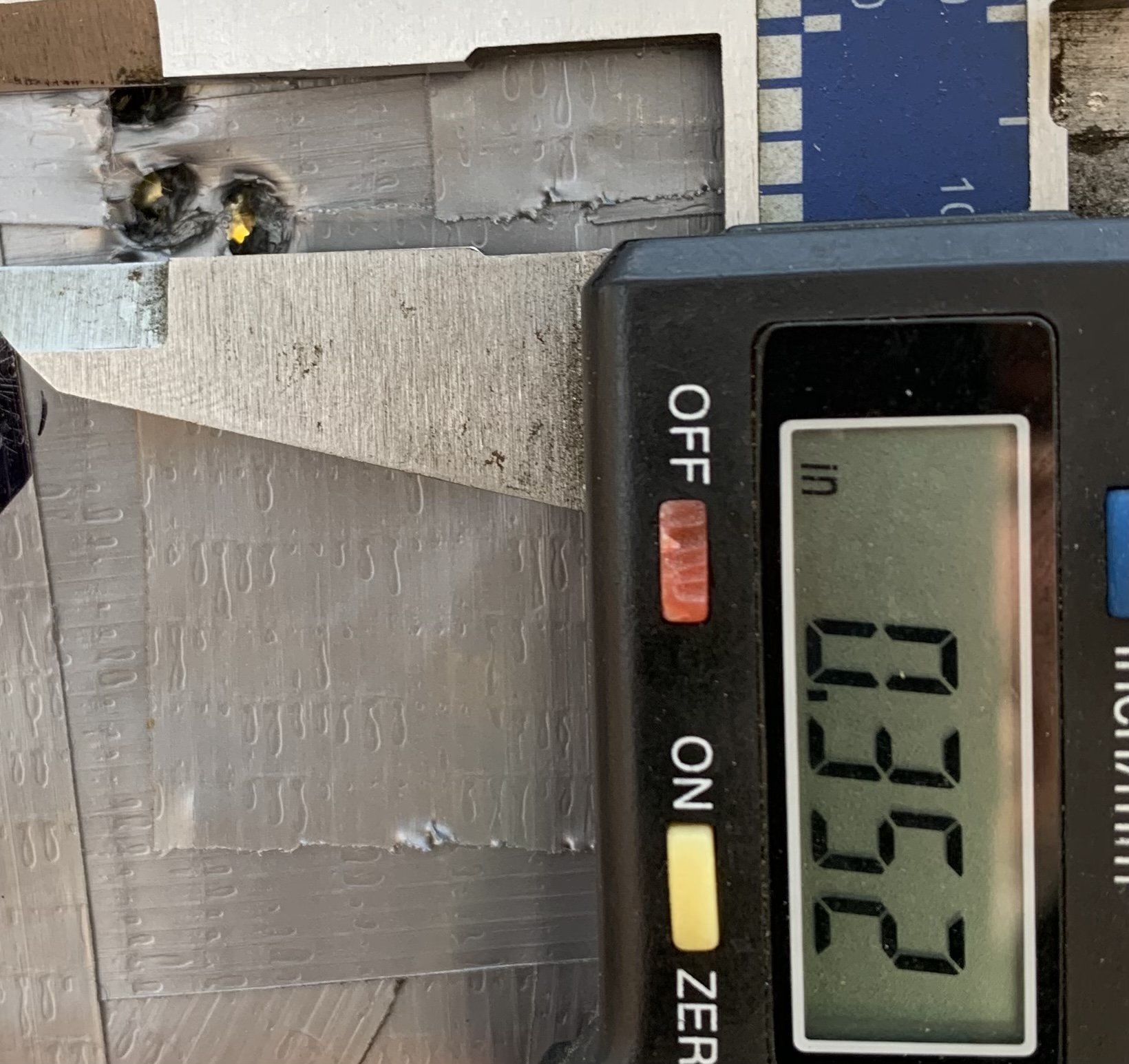

Tony:
I finally had time to check on the receiver and the ammo. The description says 18" barrel and mid-length gas. I used an Aero Precision M4E1 upper receiver with a 6.5 Grendel BCG and a Stag lower receiver. The buffer spring is a JP captured spring. What is the measurement for the gas tube to confirm whether mid or rifle?
If anything, I would have assumed over-gassed given the suppressor, but I was wondering if the reason to not close the bolt fully or to fail to pick up a round was because there wasn't enough forward spring pressure that I sometimes associate with not enough gas. I had a combination of 5 boxes of 103-ELD-X and 10 boxes of 105 ELD Black plus handloads using Berger 95 gr Match VLD and the once-fired brass. During barrel break-in, I used mostly the 105 Black. I was planning to run some load tuning rounds this weekend. I will take notes whether handloads or 105s are related to the failure to push a load home.
I will measure ejection distances this weekend, but I am guessing 6-10' for most.
How would I check on the mag interface slowing down the BCG forward momentum?
No AGB, just standard fixed low profile ordered from Aero. Can you install an RLGS on an 18" barrel? I can easily install an AGB from SLR or anyone else, and I can swap buffer springs. I would like this gun to feed reliably.
I'm running 24 round E-Landers with an 18" Proof. I've run it for the last 3 Quantified Performance matches. First match I had issues pop up where it would inconsistently fail to feed. From the look of things, it seemed like the magazine would get sluggish after so many rounds and not keep up with the BCG (and the rifle isn't overgassed). So after that match, I ordered some Wolff extra power AR15 mag springs for 3 of the mags (individual mags I knew I had problems with were in that group). Those 3 became my test bed and I used them exclusively during train up and during the match. Since then I have not had the issue repeat itself for 2 matches and practice sessions prior to. I've passed that fix along to others who were having E-Landers and it seems to have fixed their problems as well. Might be worth looking into.
What's the Wolff SKU? I called to order, and the person on the phone said AR15 mag springs was not on their list. Maybe it was a different vendor.
Tony:
....barrel measurements should be used to determine gas system type, not the gas tube length (especially if incorrect tube was installed/provided). With the barrel already installed you can measure the distance from the front of the receiver to the back of the gas block or rear edge of gas block journal to determine which gas system the barrel was ported with. This page has both a good visual and video on how to use this method >>> https://www.riflespeed.com/How-to-Select-the-Correct-Gas-Control-for-Your-Carbine_b_2.html
.... I would suggest that if you have a spare "regular" buffer spring handy or one you can swap from another known working rifle, you use it instead of the JP for your next test, especially if you are unsure of what "tune" the JP springs/weights are at. I also suggest you leave your fixed gas block in place during that test. Replacing too many parts at same time can lead to new/more issues and not reveal any solution to the original issue. Eliminate issues one at a time until you have reliability, then you can "upgrade" as desired but armed with specific knowledge to use in your upgrade selection/configuration.
...ejection direction is more relevant than distance. A 3-4 o'clock pattern is desired, forward of 3 is indicative of over-gassing and as it moves closer to 1 indicates amount of over-gassing
....magazine interference/drag might be indicated by excessive scrape marks on the tops of the feed lips of the magazine, follower or casing bodies. The other method is by "feel" when manually manipulating the charging handle, which is really a subjective thing and not overly reliable.
...ANY type of gas system can be ported on ANY barrel length, but a "Rifle Length Gas System" is the typical type used for 18" barrels.
EDITED: You may also want to check the end of the gas tube that enters the BCG's gas key for any wear marks indicating it is "rubbing" excessively (canted, not straight) and slowing it down or "peening" at end (too long) preventing full closure.
