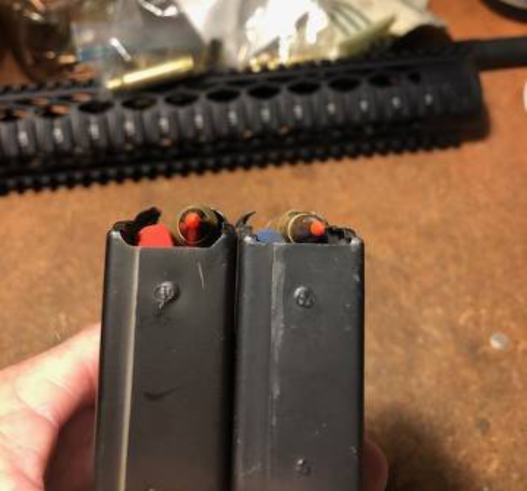

Might also be worth trying a different magazine for the heck of it. 6ARC seems to be a little finicky with that.
It's been a while, but I remember a thread over on ARFcom where a guy was having feeding issues with 6ARC out of grendel mags. Around that same time, the mag manufacturer (I believe it was Duramag) released a 6ARC-specific mag. When he compared them, the 6ARC mag presented the cartridge much higher and had a deeper cut in the front panel. That solved his feeding problem.

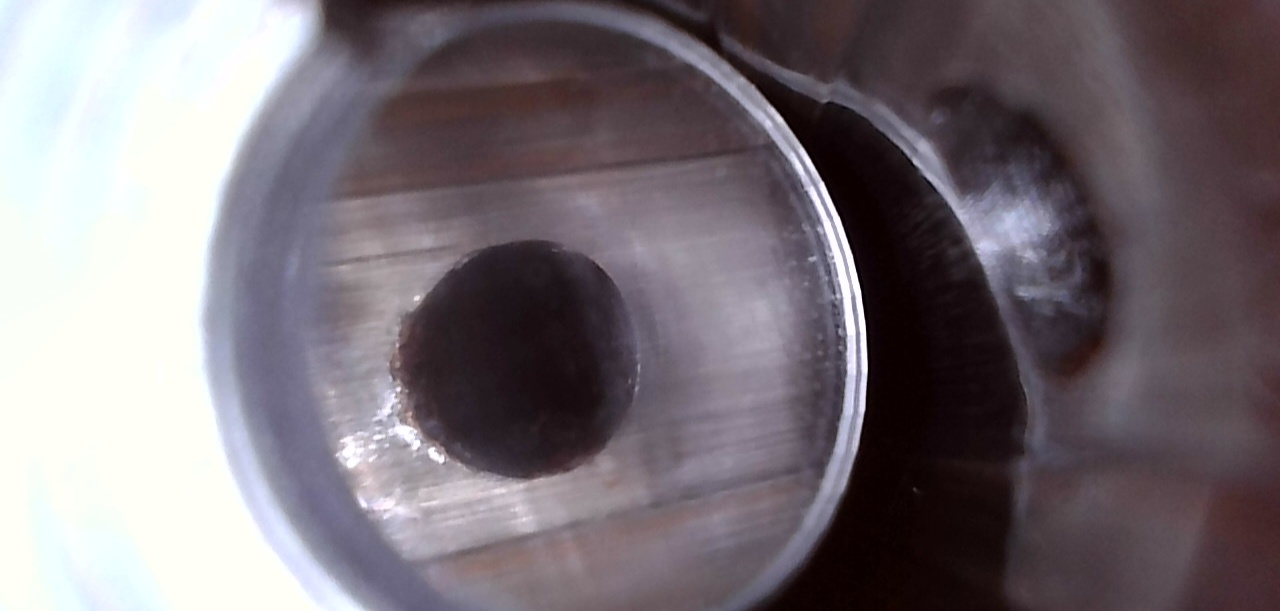

Took a scope to it, looks aligned and I can clearly see the screw go in and back out.

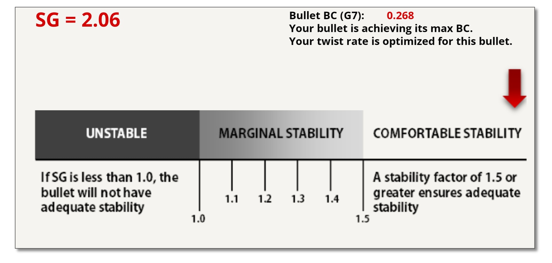

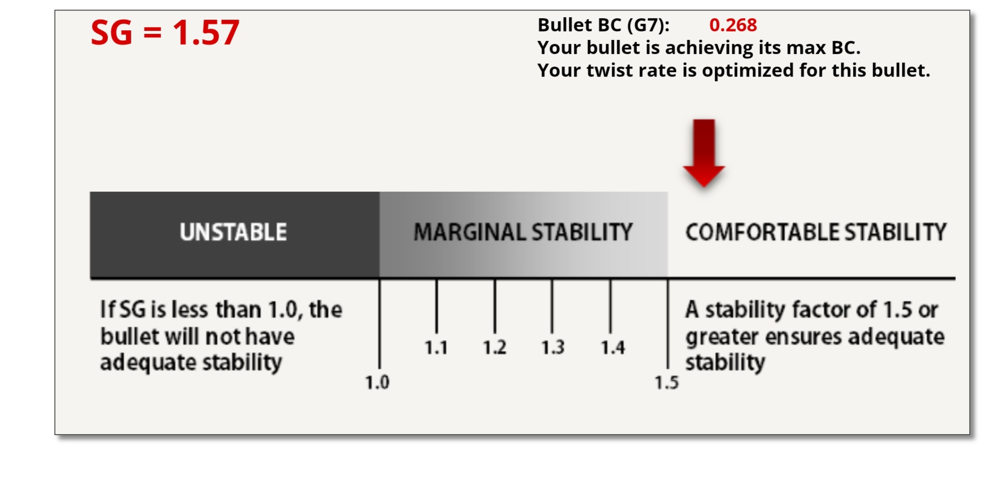

You can play around with the Berger twist rate Calc if you're interested. I just did a quick comparison of 108gr at 1:8 and 1:7.5 and they both fell in the stable range.
Here's 108gr @ 1:8
And here's 108gr @ 1:7.5
