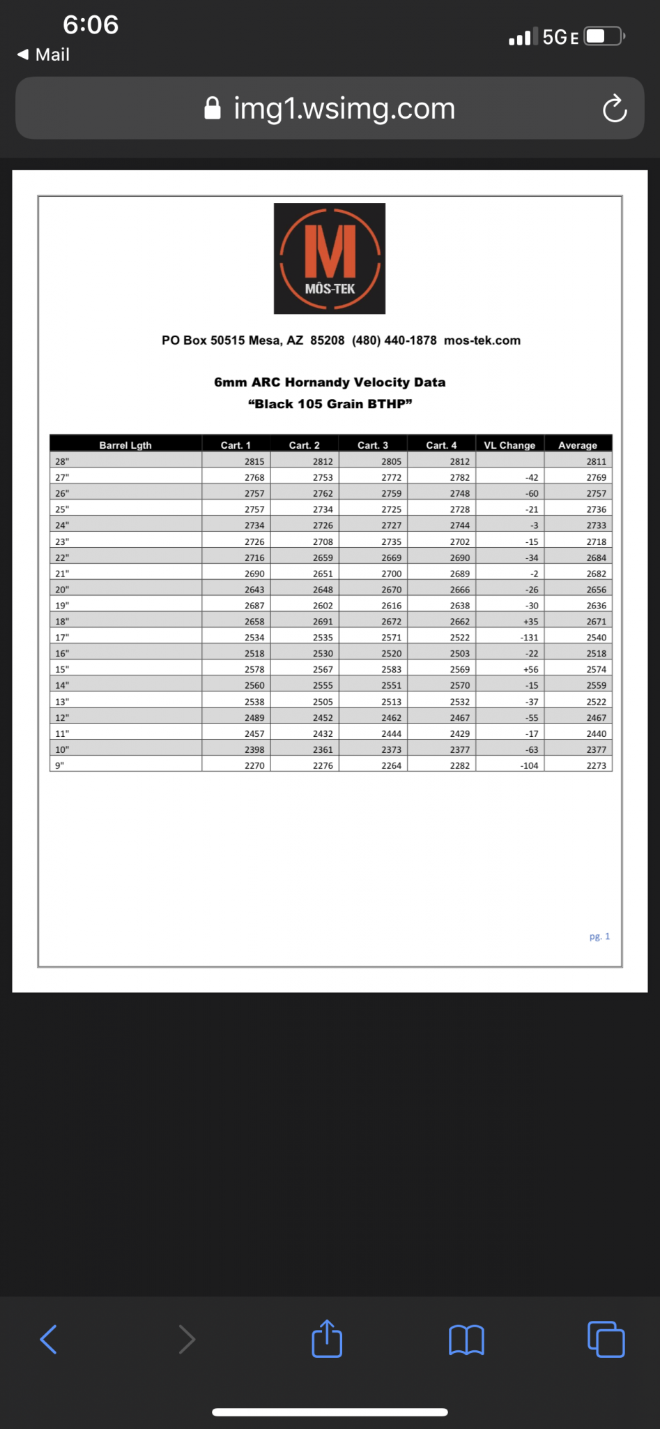

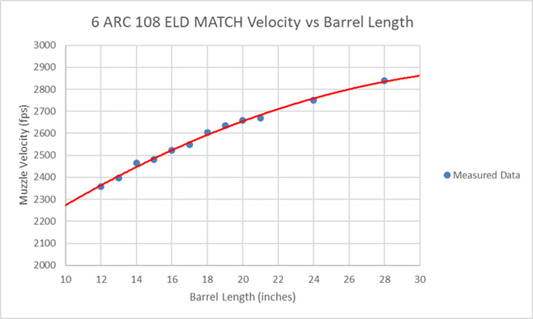

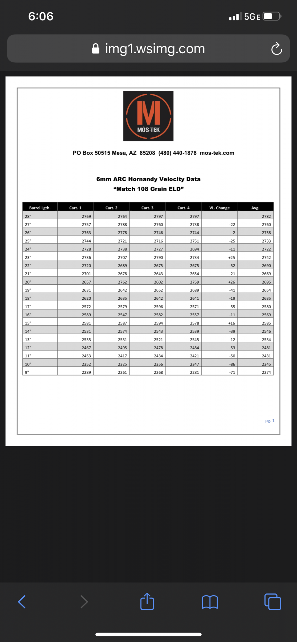

This was somewhat close for me, my 10.5" was at 2320, 18" at 2643 with factory match 108gr ELD-M. Keep in mind I have Bartlein barrels, and these seem to be pretty quick at that. 20" should get you somewhere in the order of 25-50fps over the 18".
Love the updates. I was kinda on the fence between 18 and 20 myself until I saw this data that Mos Tek published. Could have been the particular barrels they used for 19 and 20 data points, but it seems like diminishing returns imo.
Put together a 12" ARC Pistol upper recently. 2330fps Avg with 108 factory. No optic yet for groups, just got it together and chrono'd my rounds adjusting the gas block open.
Reactions: Cornerstonearmory
Love the updates. I was kinda on the fence between 18 and 20 myself until I saw this data that Mos Tek published. Could have been the particular barrels they used for 19 and 20 data points, but it seems like finishing returns imo.
Based on those charts, it hardly seems worth it to go with a longer barrel.
My thoughts exactly. I’d rather keep the compactness of a traditional gasser and make up for whatever ‘projected’ velocity loss with a hotter load.
I did this simple chart to help understand the ballistic impact of MV differences. This is at 700yds, for a Berger 105gr Hybrid, all at the same environment. They are referenced off the 2700fps results... so the 2500fps will have 20% more drop, 13% more wind deflection and 18% less energy at 700yds than the 2700fps MV, whereas the 2800fps will have 8% less drop, 6% less wind deflection and 10% more energy.
If are you aren't shooting out as far as 700, maybe this doesn't mean as much to you.
MV fps of 105grdrop at 700wind at 700 Energy at 700
250020%13%-18%
26009%6%-9%
27000%0%0%
2800-8%-6%10%
3050 (my 6x47L bolt gun load)-26%-17%35%
