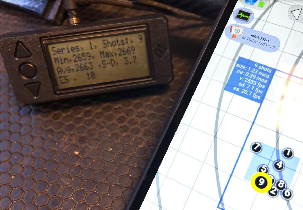

I’m using RCBS SB/TC dies and just lubing and running. You will have to trim a bunch. My reformed cases were 1.512” and I modified a lee 6mm PPC case gauge and trimmer to trim to 1.480”.
I have used #400s and Br4’s but now I am mostly using #41’s.
The 400s showed some occasional cratering and once a pierced primer with my load (29.6 of Leverevolution). The 41’s seem to be just as, if not more, accurate for me than 400s with no such problems. No issues with the Br4s - just don’t have that many and they are more expensive.

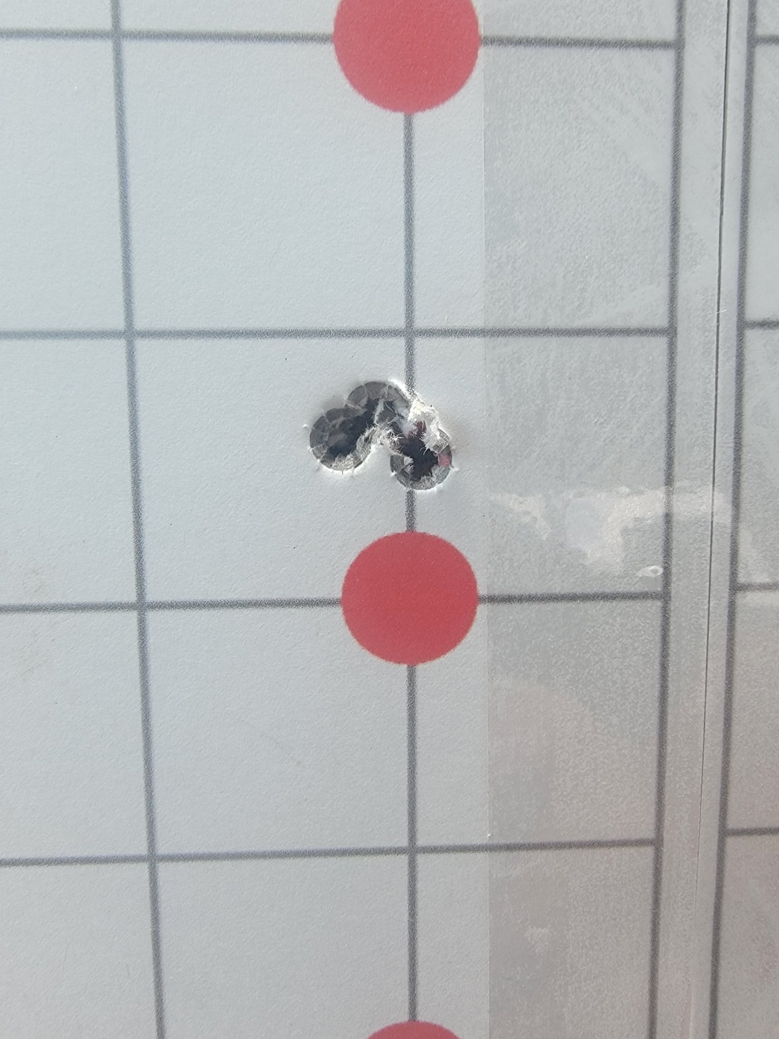

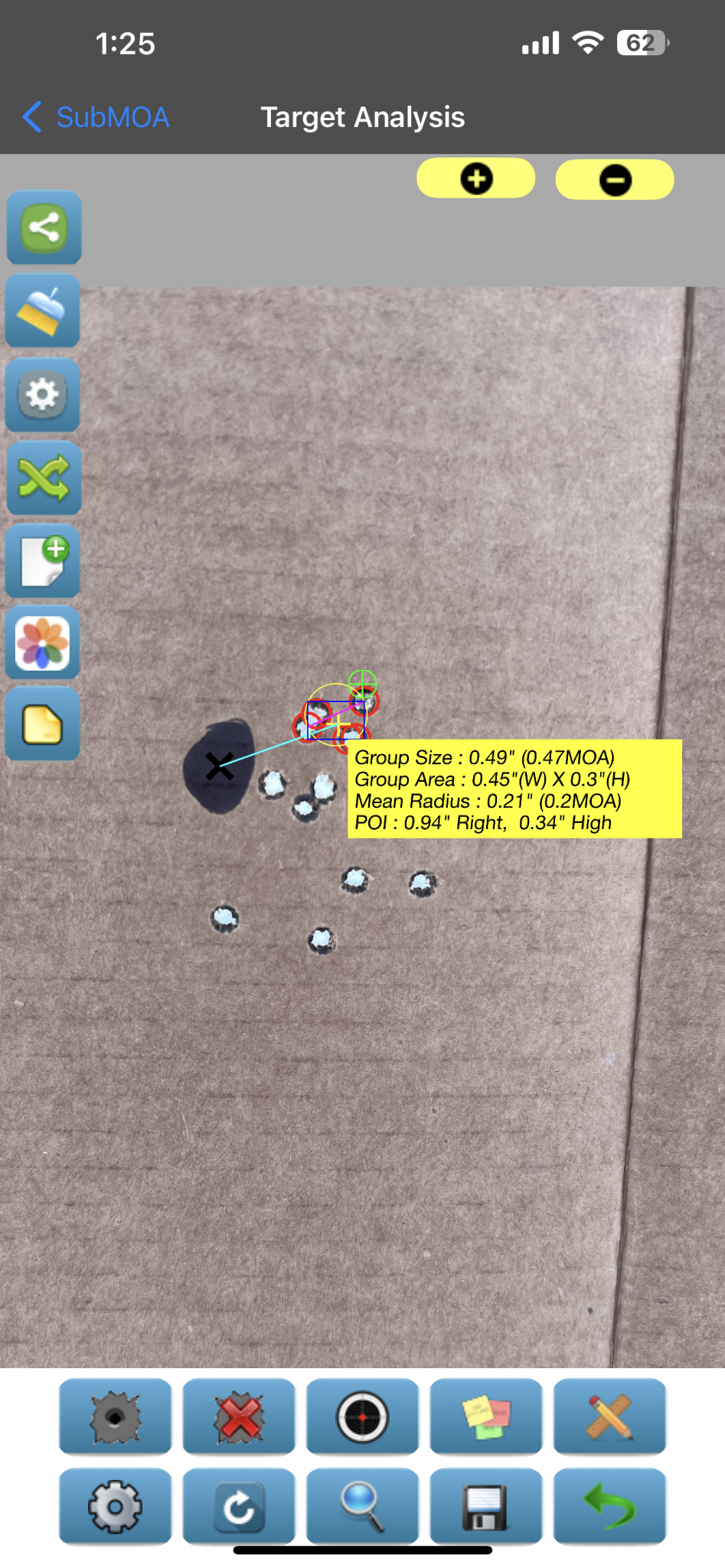

Shot this group with hornady black 105’s today in 5 degrees and howling wind. They are 0.2 mils lower than my 100 TGK handloads. I was holding on the left side of the marker dot at 100 yards. So hopefully when it warms up and the wind subsides I will see if I can repeat this group. The other rounds were in the pic were from a clean barrel and also the wind was gusting hard. The last five were when the wind was consistent.
Reactions: skyrep

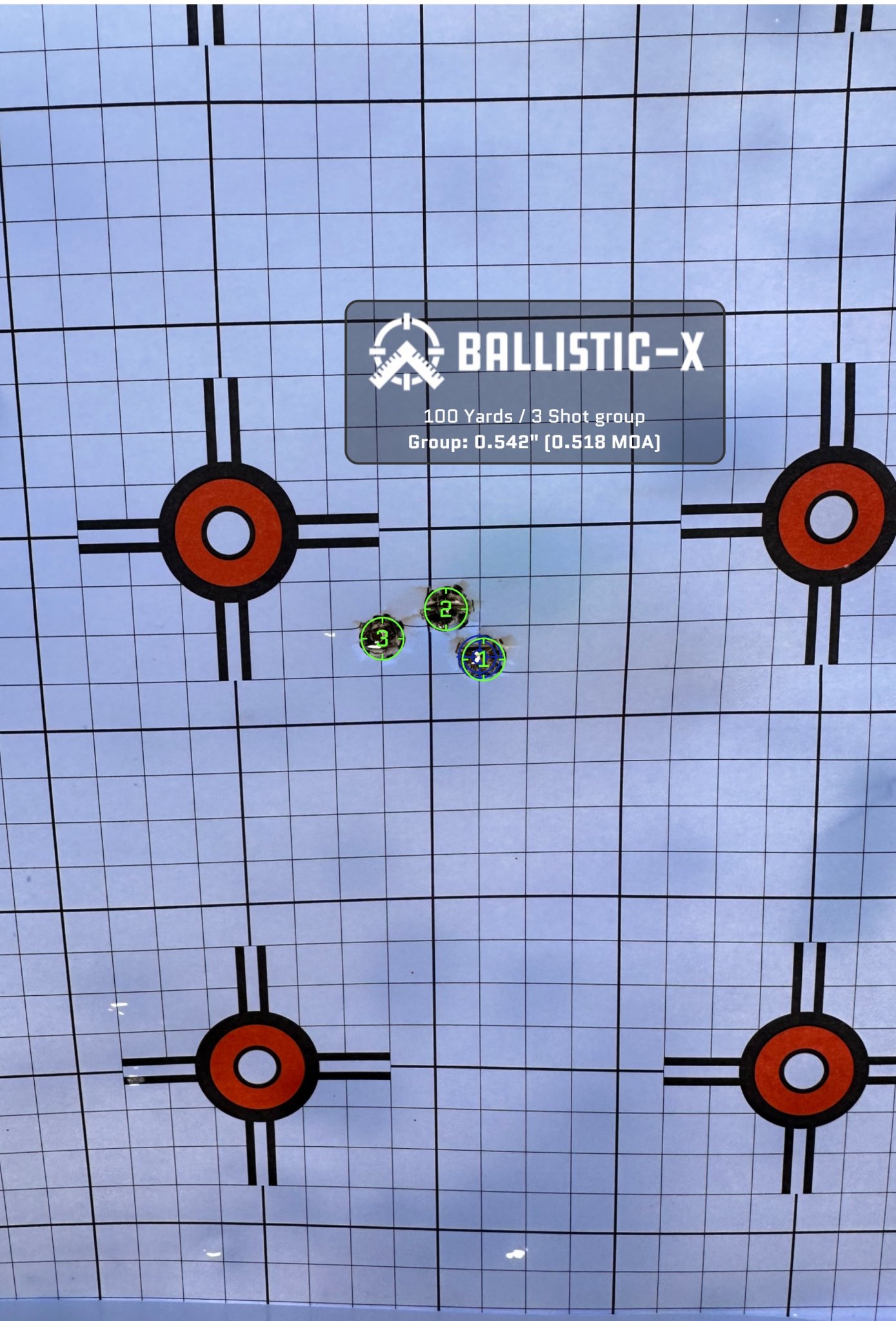

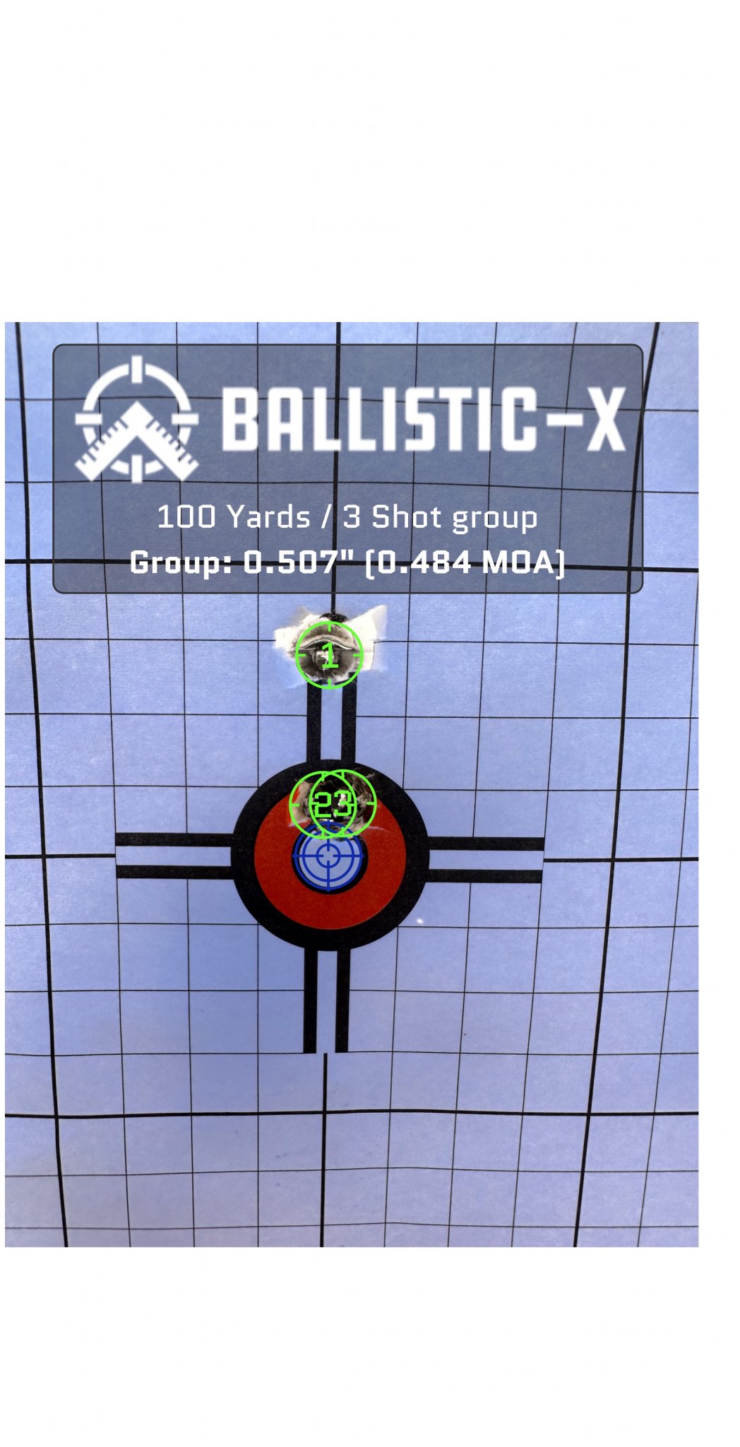

Shot another group at 100m yesterday. 3 shots touching and a couple wild ones. I think it may need cleaned. Lever that dirty? 50 shots and accuracy goes to crap
Edit: Wow, yeah let it soak for half hour with Hopps oil. Patches were dark dark. Ran some clean through, mopped out the chamber and accuracy was back.

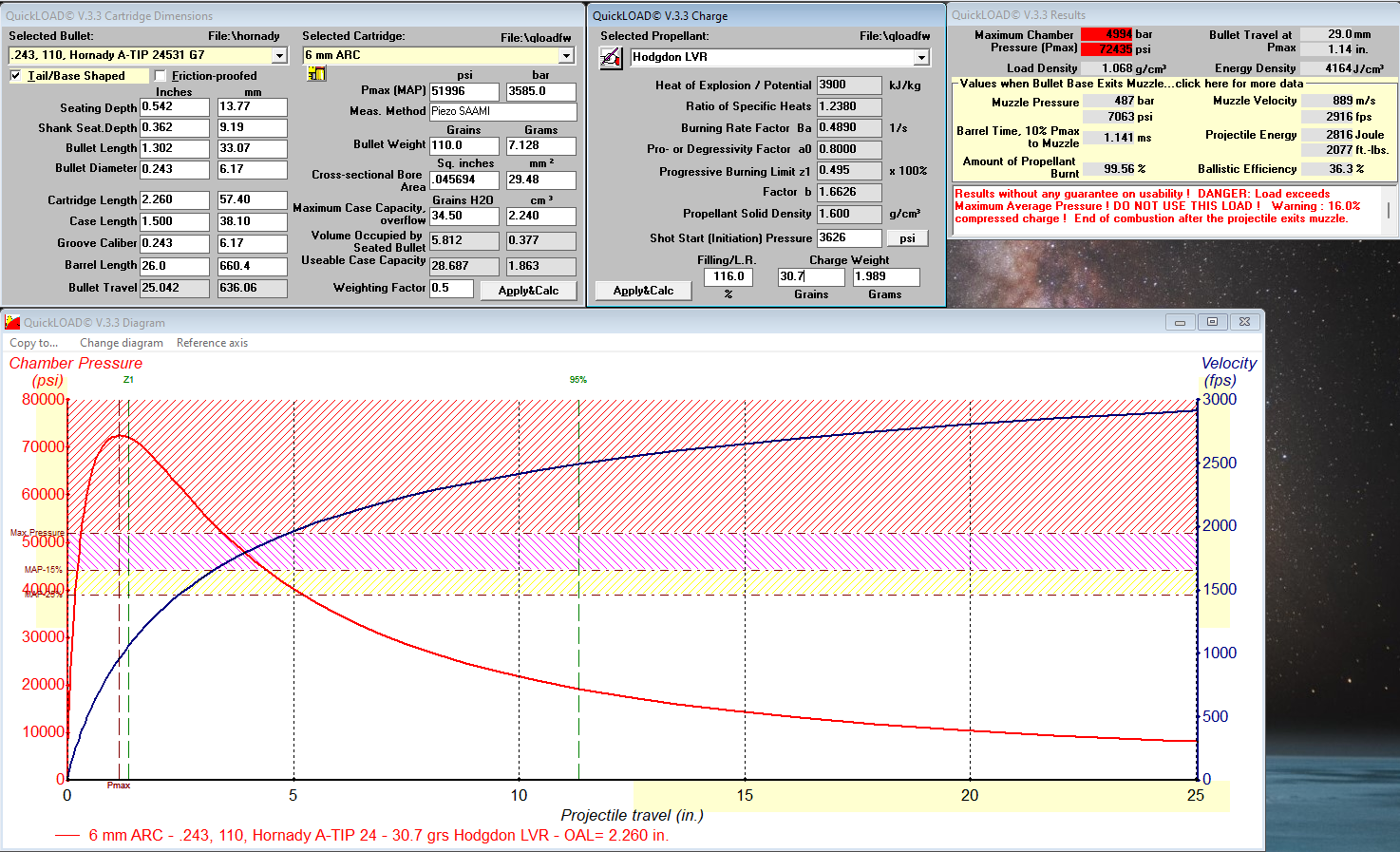

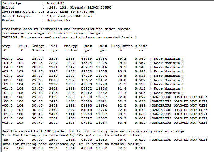

I'm starting to think QL's burn rate for LVR must be off. I tested some more 110 A-Tip loads, shooting 10-shot strings of 29.7, 30.2 & 30.7gr charge weights at 2.26"
Still no pressure, but it was getting really compressed with 30.7gr. QL says I should be way out of bounds with these, but yet I'm not. No flattened primers, no ejector marks, etc. On top of that, even out of a 26" barrel I'm not getting the velocities I'd expect (ex 30.7gr @ 2731fps avg). There's now 124 rounds through this barrel, so there's still a chance I'll see a speed-up soon, but it still feels kind of odd.
That said, groups were pretty nice and SDs were low-to-mid single digits, so this is clearly the powder.

Just got a 20" proof stainless barrel and I have been very happy with it it.
The barrel has maybe 100 rounds on it and it shoots the 103 gr eldx consistently sub MOA, usually around .5"
Once i had some spent brass, I tried some Hornady 80gr CX monolithics over CFE223 and found a really sweet spot at 31grs of powder and 2.095" COAL. Velocity was 2940-2950 10' out using one of those old style chronographs.
Going to see how it works on hogs as soon as I get a chance.

Finally had the chance to run my 20" proof barrel with factory Hornady ELDX ammo and also some hand loaded 87gr VMAX out to 1000 yards.
I'm super excited about this rifle. It is way more capable than I was expecting. The 87gr vmax holds the same dope as my GT out to almost 500 yards. The 103s are just stupid accurate inside 700 yards. Makes me question even trying to hand load 103s, but I think I can squeeze some more velocity out of them with LVR.

Anyone have any velocity data with a 14.5"? I have done quite a bit of looking and have only found a graph of what factory Hornady match ammo ran at different lengths.
Reactions: Dogtown
Not specifically, but here's a ballpark of what kind of velocities QL predicts using 103s with LVR
