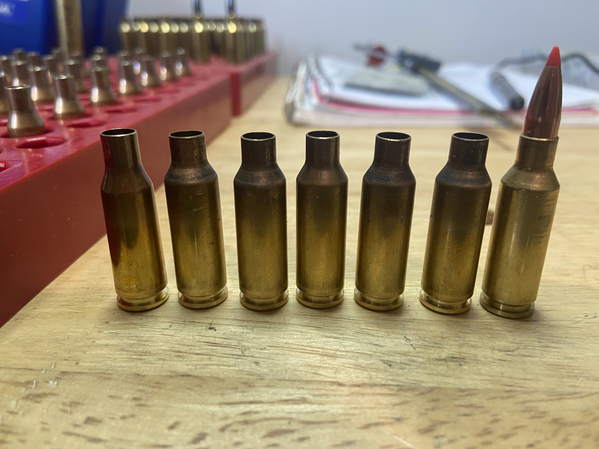

If you’re going to start reloading what have you found as far as brass bullets primers powder?
Brass is hard to locate. I just formed these from 220 Russian, there are several videos on YouTube. 220 Russian on the left five fire formed cases in the middle the finished product on the right

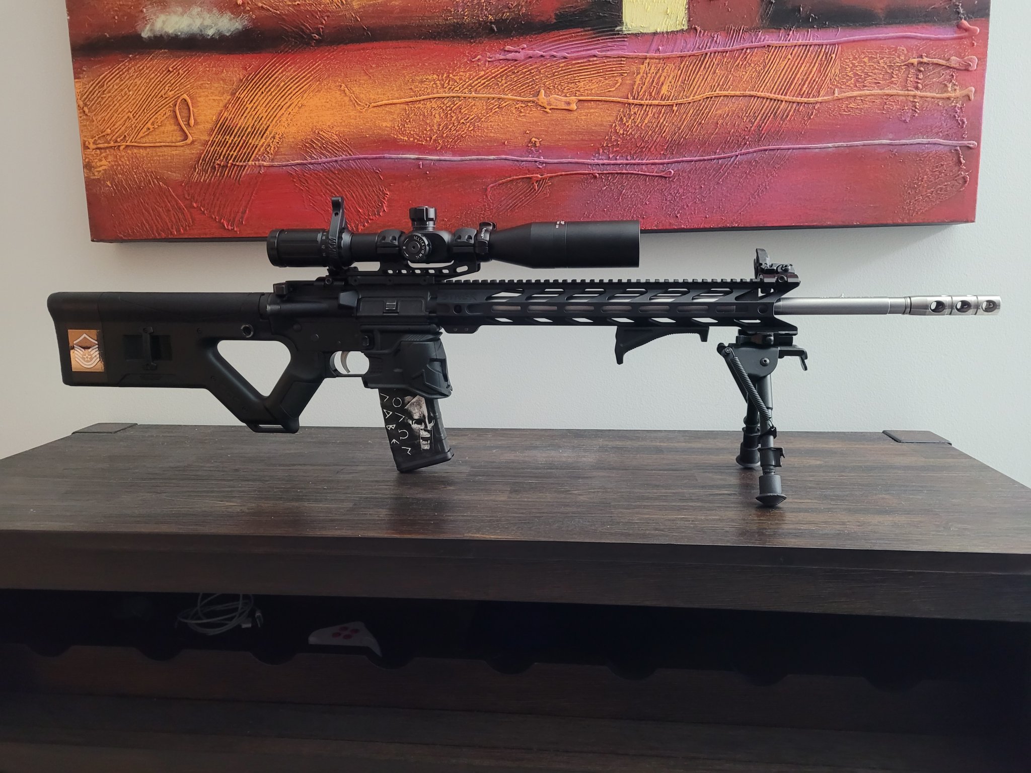

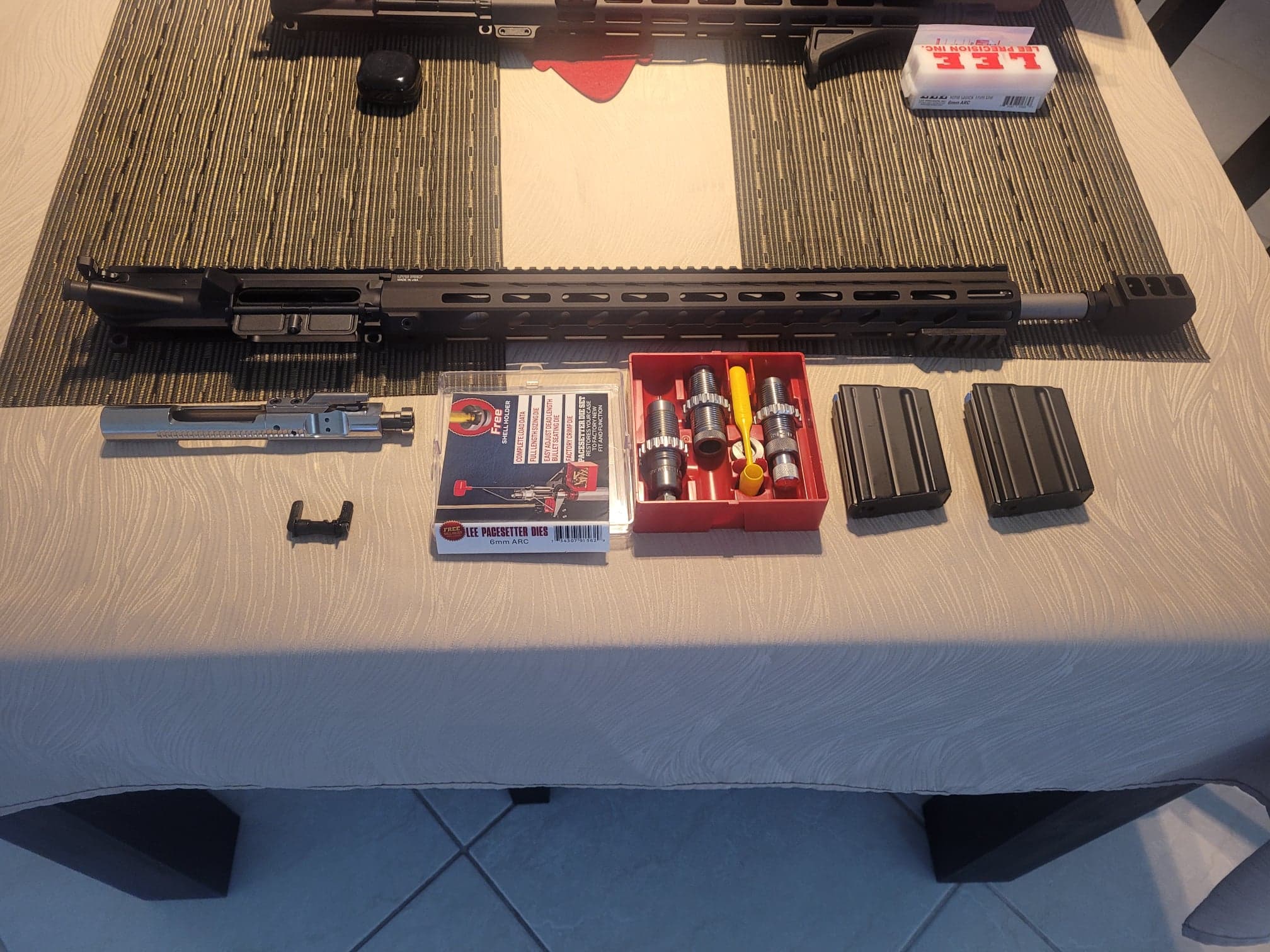

Today is my 60th birthday and the day I registered here. Why? Well I committed in assembling a 6ARC upper, waiting on a my scope to arrive sometime this weekend I hope. I have experience reloading .223. Now I took the deep dive with this cartridge. So far, I see the shortage of once fired brass nation wide, bummer. As I continue to do research I found out about the neckdown on the Grendel brass so I know it's another choice. How difficult it is to neckdown 6.5 grendel brass? I have all dies that I can think of. I had close to 2K for my birthday present and the blessing from the misses to blow it off what ever I wanted LMAO. Anyway, here is the list of parts that I assembled.
20" SS416 R Ballistic Advantage barrel with all components needed to assemble the upper, it looks really good. I imagine everyone did well.
My lower is well assembled with a 3lbs 2 stage trigger smooth as butter. Here is a pic of the lower with my 20" .223 Wylde upper and the other pic is the 6ARC upper and and all the rest.

I think 6.5 Grendel brass is the easiest to form because the dimensions are closest. I just run it through a 6ARC die and trim accordingly.

You can also fire form it from 220 Russian or 76 2 x 39 for my brass i fire formed from 220 Russian it’s very simple run through the arc die to expand from 22 caliber to 243 caliber load long jamming the bullet into the rifling and touch it off then they will need to be trimmed etc.
