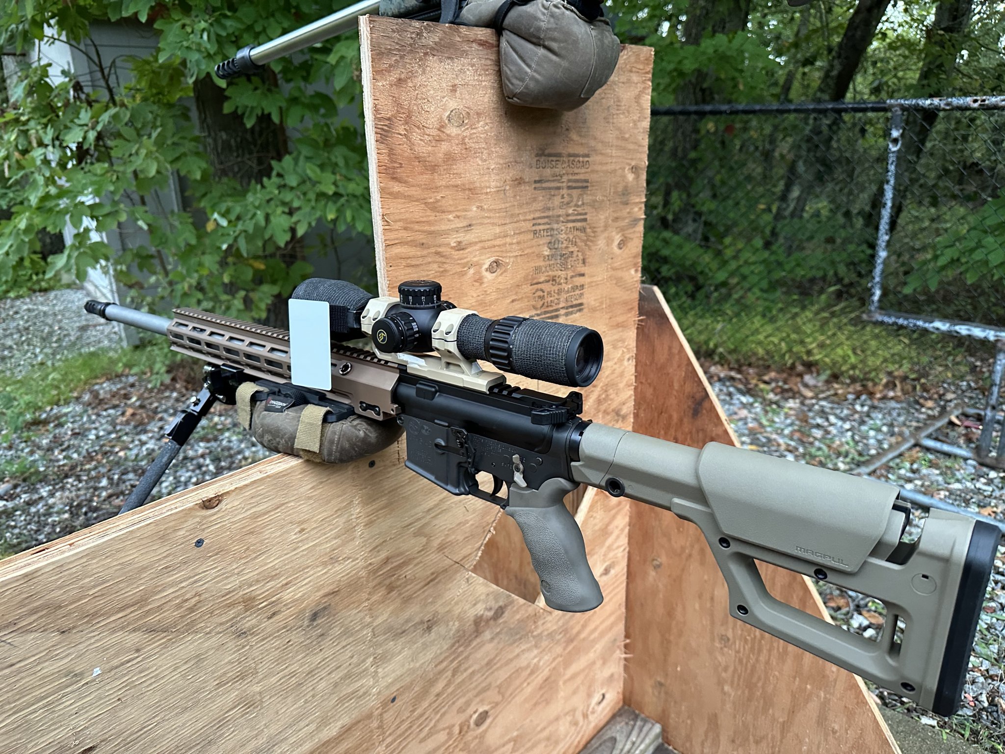

We need a stickied 6arc thread for reloading data. I'll start with my current load development and gun setup.
I built a 24" ballistic advantage 6 arc gasser, barrel is 1/7t, with rifle length gas system. I started with some hornady 108 eld match ammo, shooting 2642fps average, and my groups were about 1 1/2" at 100 yards, which is not good enough for me.
So i bought some Hornady match grade dies with micrometer seater, prepped some of the once fired brass and loaded up some 112gr barnes match burners. I am switching to the match burners for my 6gt, and i want to try and keep both the 6gt and 6arc running the same bullets.
My starting loads was using cfe223, br4 primers, 112gr match burners, and once fired hornady brass.
27gr cfe223, br4, 112gr MB, 2414fps average velocity
27.5gr cfe 223, br4, 112gr MB, 2460fps average velocity
28gr cfe223, br4, 112gr MB, 2507fps average velocity
Hodgons app says 28.2gr of cfe 223 is max load, i am showing no pressure signs at 28gr, and the gun seemed to group the best with this load. My Kestrel is showing the bullet going transonic around 1200yards.
