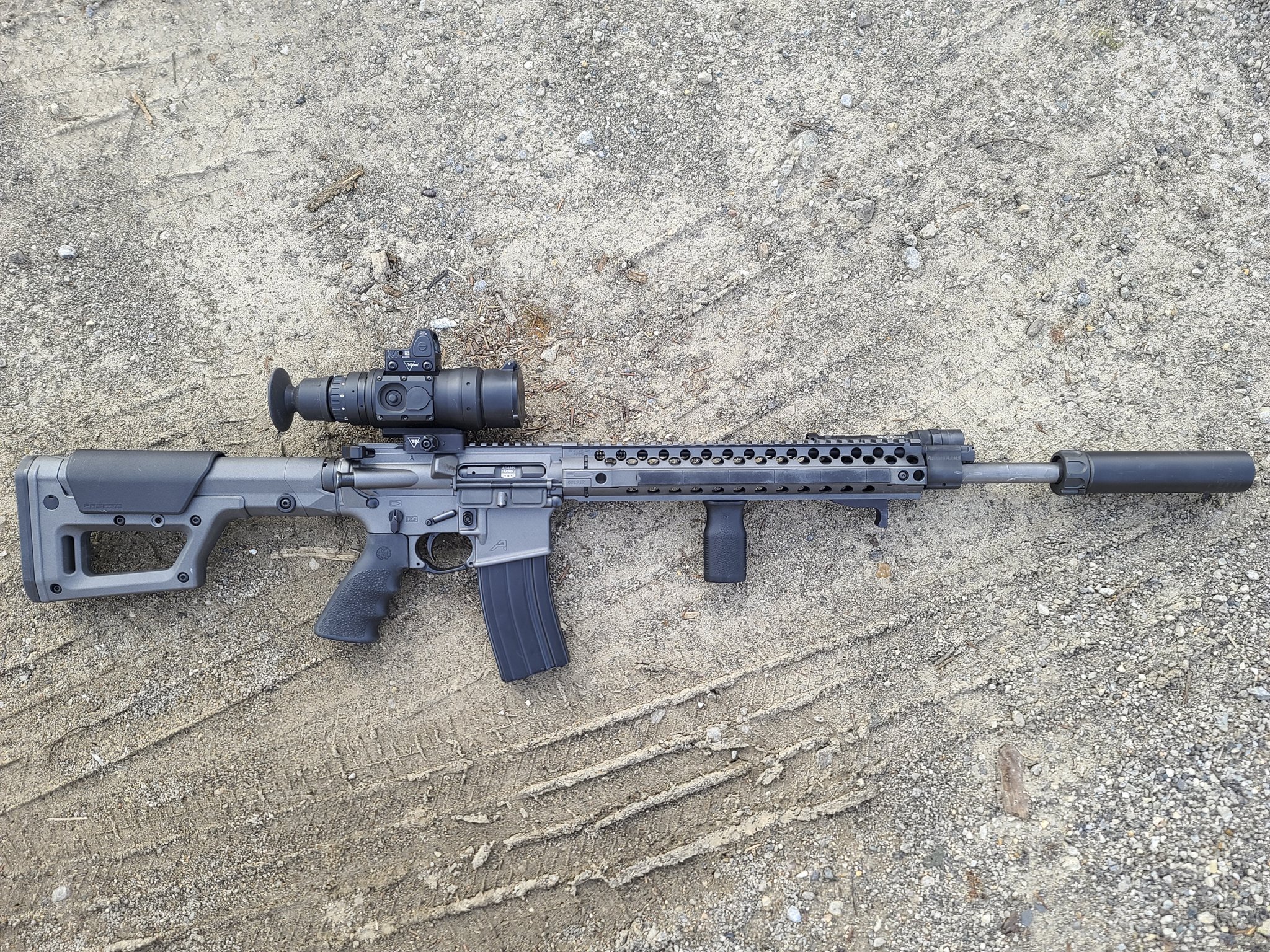

Just new here. Wanted to share the Frankenstein that's shooting pretty good. I've got a gas issue to try and work out. So I was only shooting 3 shot groups to start and then moving to 5. The squares on the paper are 1x1". Ammo was Hornady Black. Shots taken off Magpul bipod with rear bag. Pics of the rifle to come soon. :)
Build:
Aero Enhanced Upper and 15" Enhanced rail
Aero M4E1 lower
Aero Adjustable gas block
Aero melonite gas tube
Shaw 18" straight fluted barrel
Dead Air single port brake
Dead Air Sandman-S
LaRue MBT-2S
Stoner Lower parts kit
Stoner buffer tube
JP silicon buffer spring
H buffer
