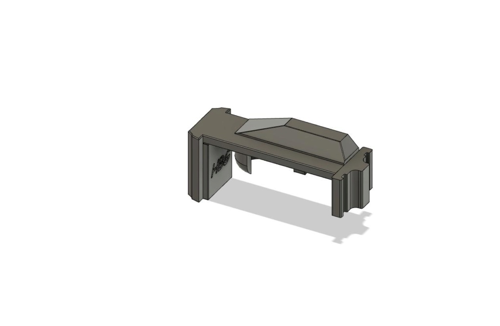

I have make some modification for PMAG 10 rounds with my 3D print. It's for AR10 in 6 BR or 6 dasher. It 's work fine, and you must install a metal sheet (0.5mm ) on the top of the front wedge (i'm french so sorry for my bad english)
It doesn't work in a Ruger RPR (simply use the standard Pmag with no modifications on this rifle). It's just for AR10 system.
