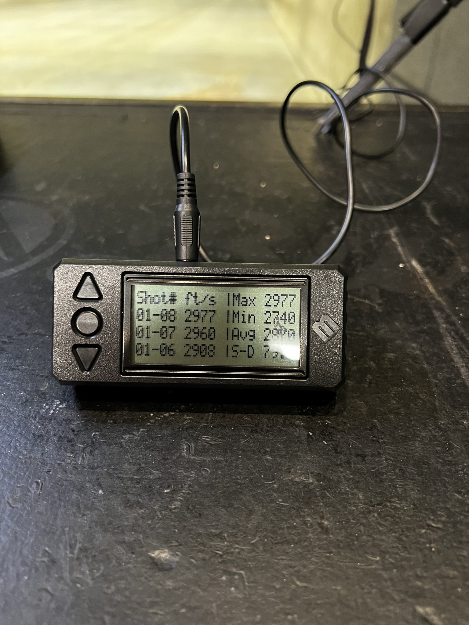

Looking for a little advice on a 6mm BRA load development before I go ahead and start cranking out a match load. I built a 6 BRA on a LP Fuzion action with a 26" Rock Creek barrel. I'm currently using 107gr SMKs, Alpha Brass, 205M primers, and loading .020 off the lands. All shooting I've done so far has basically been done in 29-35 degree weather. In regard to use case, this is primarily a PRS match type rifle so my load doesn't need to be screaming fast. Just reliable, consistent, and 1/2 minute or better accuracy.

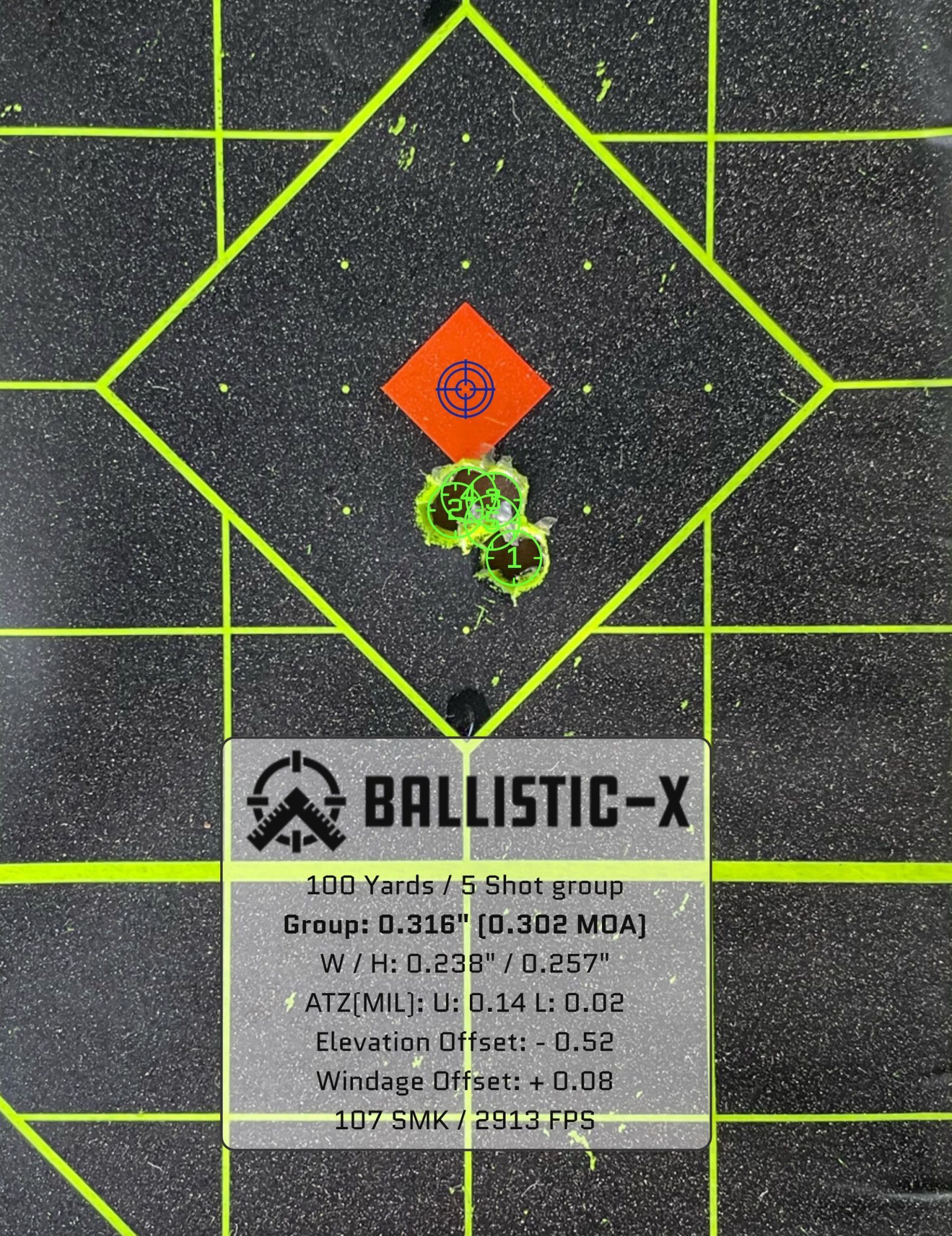

During the break-in process I loaded 30gr of H4895 which got me 2913 fps and shot unbelievably well as shown below. My only hesitation on this load is that I did see initial signs of pressure.
The primers show slight signs of pressure I was catching the ejector imprints on almost every case head. I was thinking that given I was in 30 degree weather, during the summer time this load would cause problems.

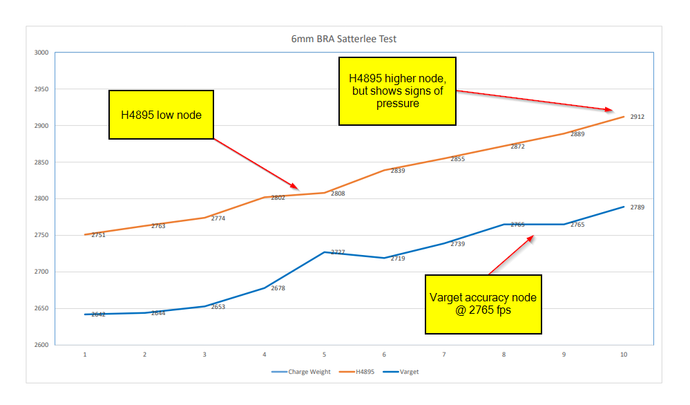

I decided to try doing a couple of the velocity node tests to find 'flat spots' and find pressure for both Varget and H4985. The odd thing here is Varget is way slower than I thought. Even at 29.8 grains, Varget was only producing 2789 fps and showing signs of slight pressure.
It seems like H4895 is the way to go for this barrel. 28.5gr / 2,800 fps is going to be the lower node, which performed very well in regards to accuracy however I was hoping to be around 2,850-2900 fps in velocity.
Given this data, what would you guys do:
- Load 28.5gr of H4895 and play it safe?
- Live dangerously and run 30gr of H4895 and figure it out later in the summer time when it warms up?
- Try again with Varget and see what happens if I push it a little harder?

I would probably redo the varget ladder and see if you can ramp it up a little. You should be running too hot yet. Im working with n-140 and got up too 3000fps. It’s a hot hot load, but found a node in the 2870-2880 range and another 2920-2930 range but figured It might be a little hard on brass so starting with the 2880 node

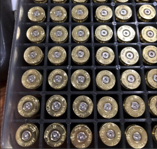

A 6BRA group I joined mentioned that everyone running Alpha 6BRA brass gets premature pressure signs on the case head. Guess I should be using the primers as a primary indicator of pressure. I’m planning to keep my H4895 load as is and probably work up a faster load with Varget.

Stop worrying about nodes.

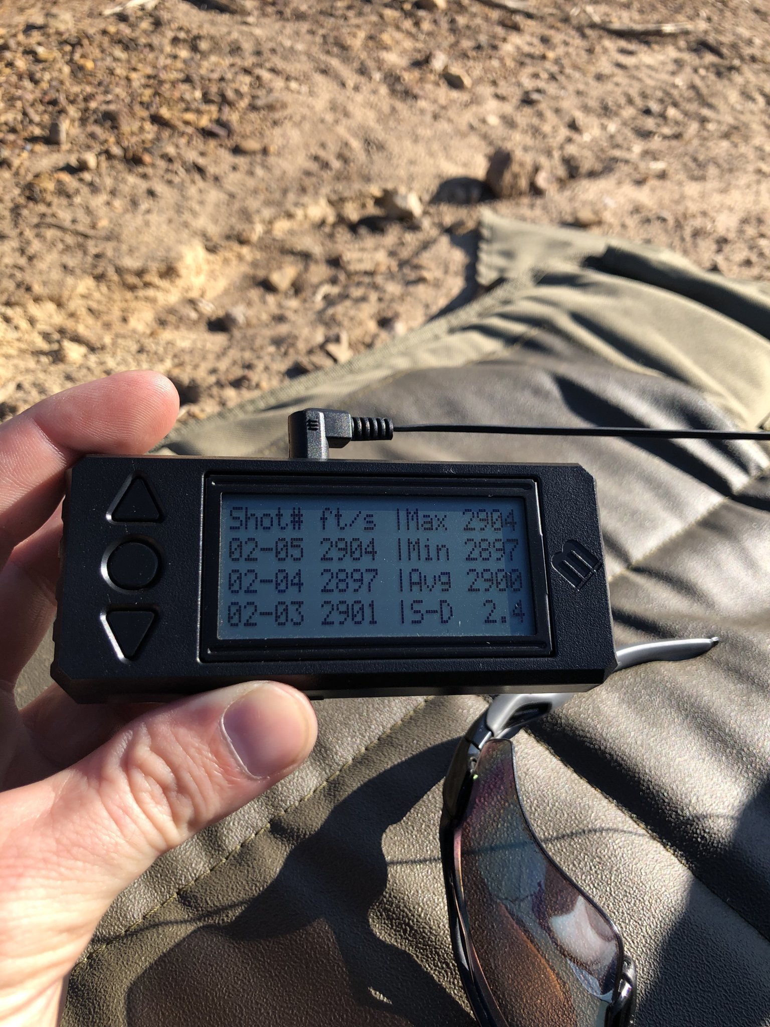

Upon taking some advice from a few other guys, I found that my load is actually just fine. I put a piece of new brass that was fully prepped into the chamber and closed the bolt and found that just doing that was leaving the ejector imprint on the case head, this I was misreading my brass and there was no pressure signs at all.

You’re dead on. I was just concerned because I though I was seeing pressure at 2,800 fps, which should be a super conservative velocity in BRA. I typically run a conservative load, just in this case I was reading my brass wrong. My intention was to be around 2,850 since most of my shooting is around 600 yards at matches with the occasional long bomb stage.

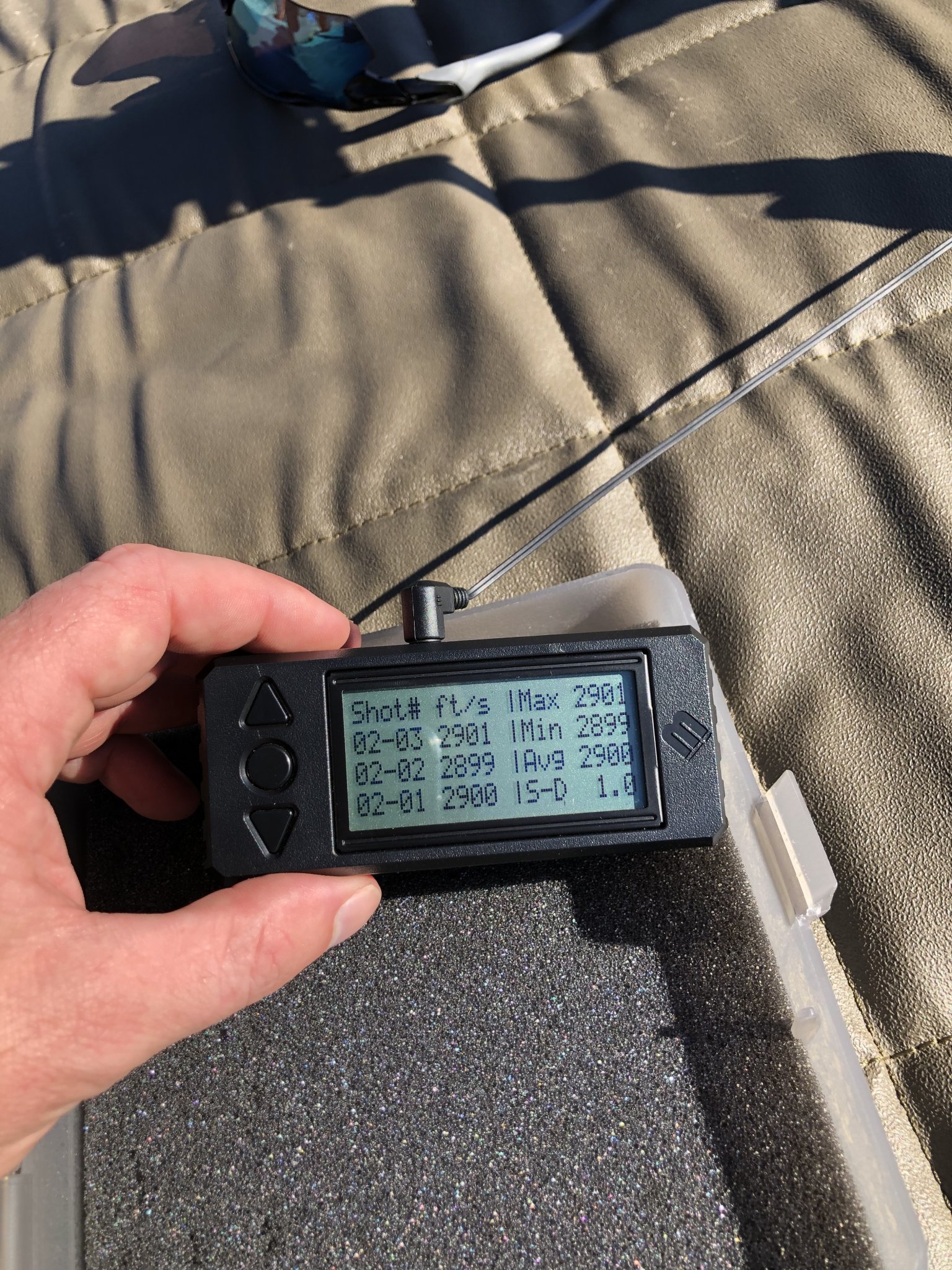

I'm running 2900 with 30.8 varget and 2915 29.8 h4895 in Lapua out of a 28" Krieger. I would guess you too will settle in around 2900 or just below.

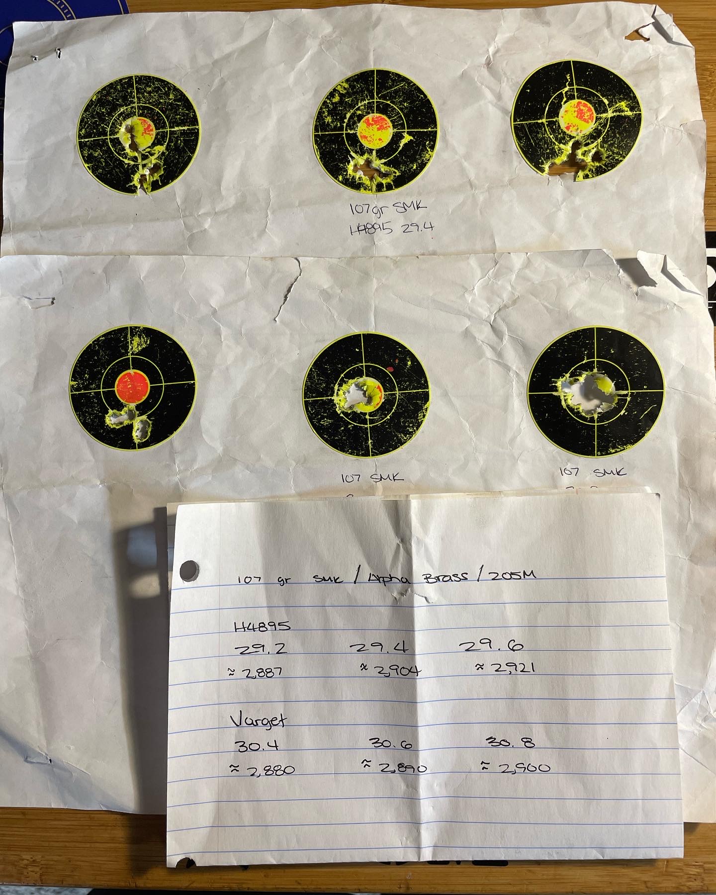

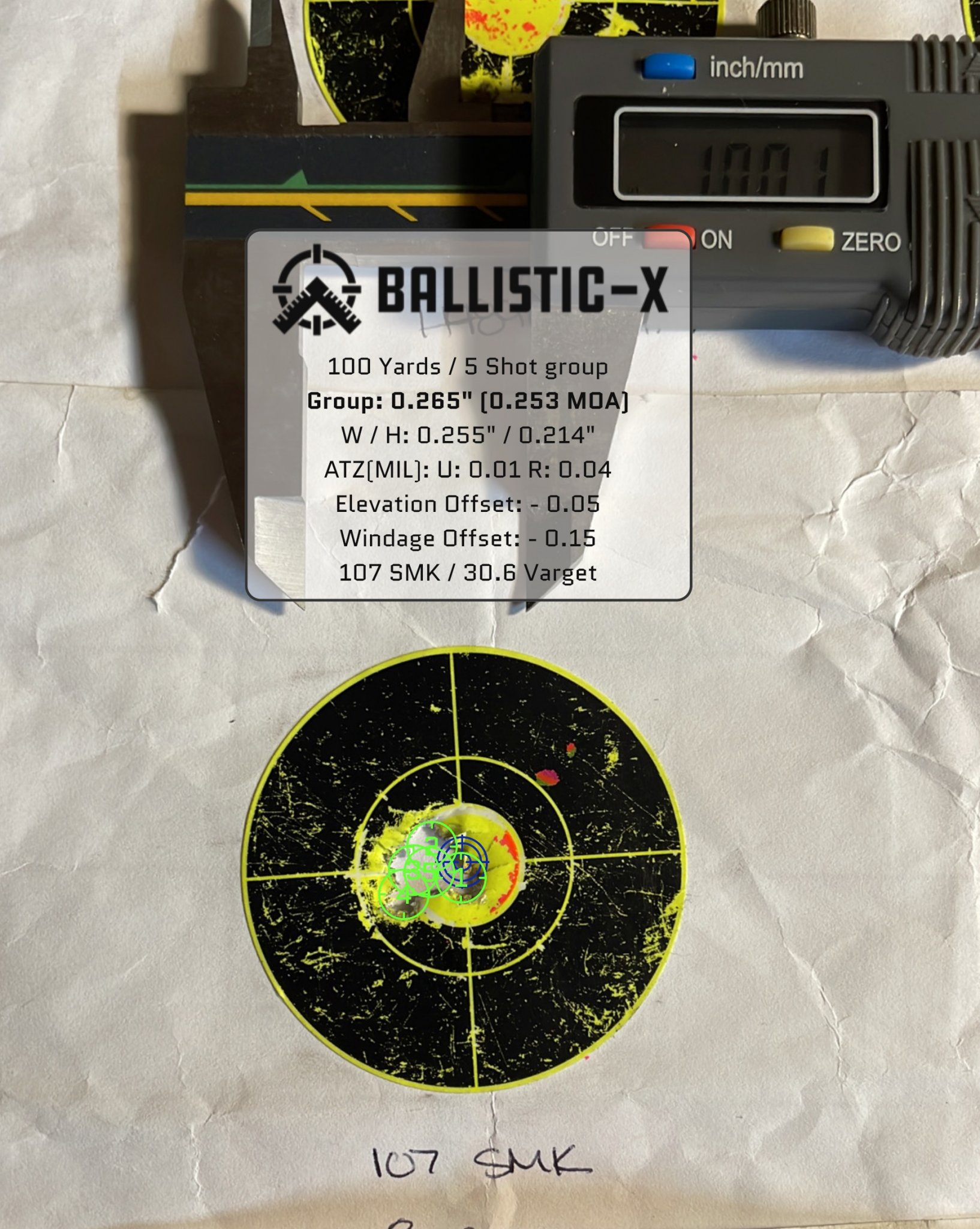

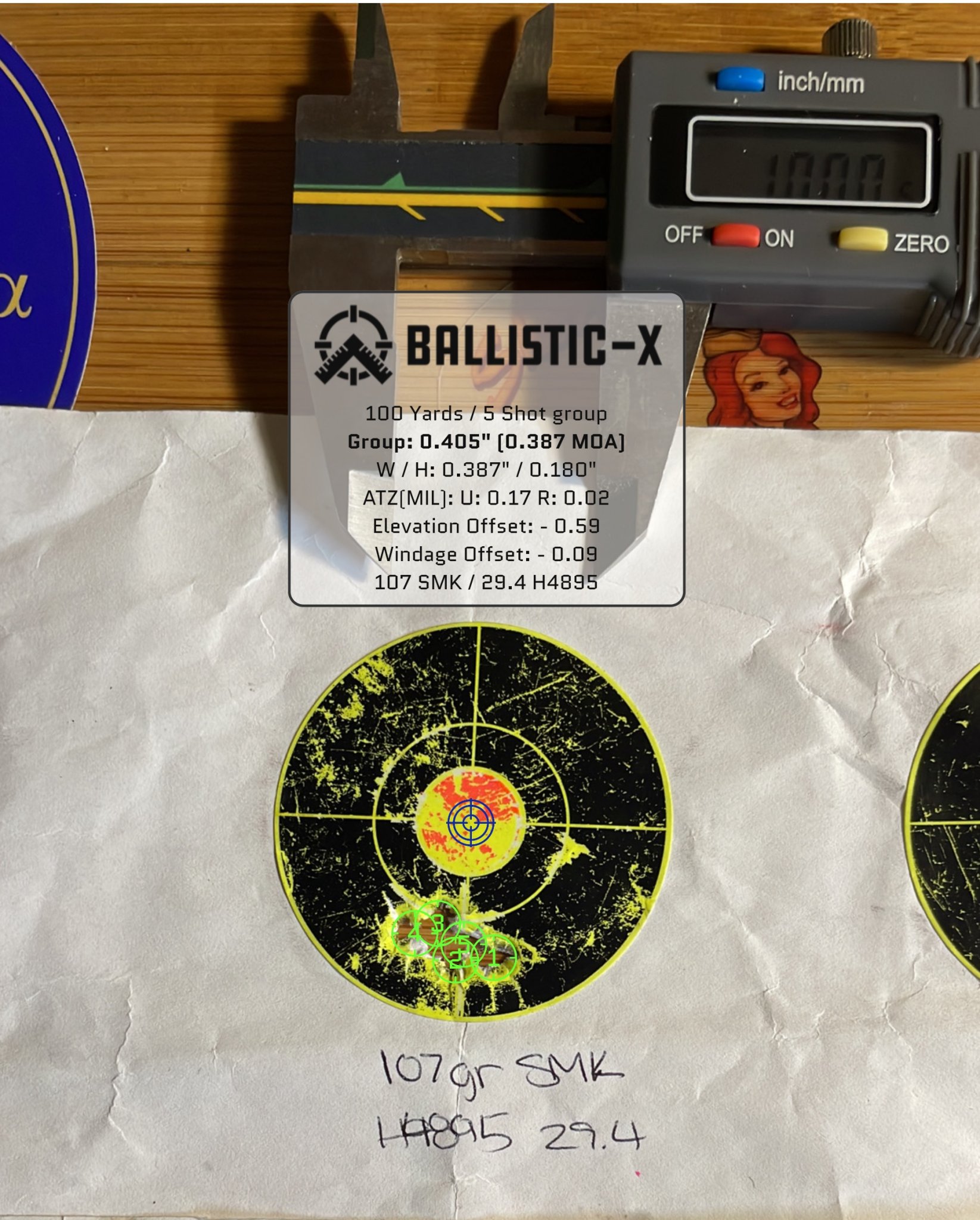

I finally got around to doing a proper load development for my BRA. Listened to everyone's advice and just got to 200 rounds down the tube at a conservative load. Right at 200 rounds my barrel picked up about 40 FPS that's why I decided to redo load development. Looks like my PVA prefit likes both H4895 and Varget. I was running 107 Matchkings, Alpha Brass, 205Ms, 0.020" jump and ran ladders with both Varget and H4895.
The 0.253" group was 30.6 grains of Varget. I'm going to run 29.4 grains of H4895 for now, since I have a bunch of it laying around. 29.4 gr H4895 produced 2,897 fps and SD of 4. No pressure issues at all. Considering it was less than 10 degrees out today, windy as shit, and I was shooting with heavy gloves - I'll take these groups and call it done 🥷🥷
The 0.258" group was 30.6 grains of Varget. I'm going to run 29.4 grains of H4895 for now, since I have a bunch of it laying around. 29.4 gr H4895 produced 2,897 fps and SD of 4. Pressure issues seem to have gone away too. Considering it was less than 10 degrees out today and windy as shit, I'll take these groups and call it done 🥷🥷
