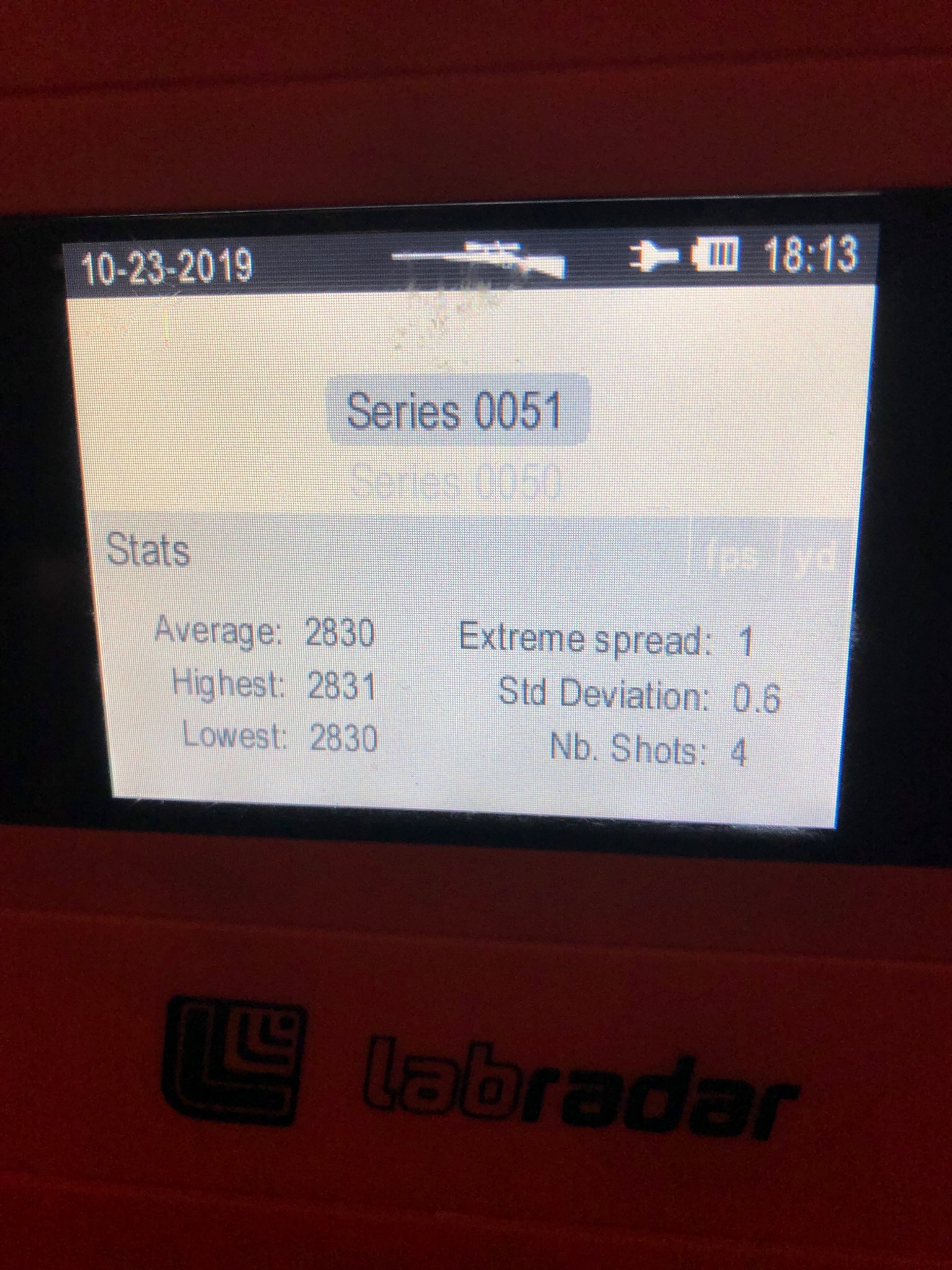

I use Whidden dies for mine. I'm still doing load development - can't seem to zero in on the sweet spot. Though this string from last night has me wanting to play with a lower powder load...
