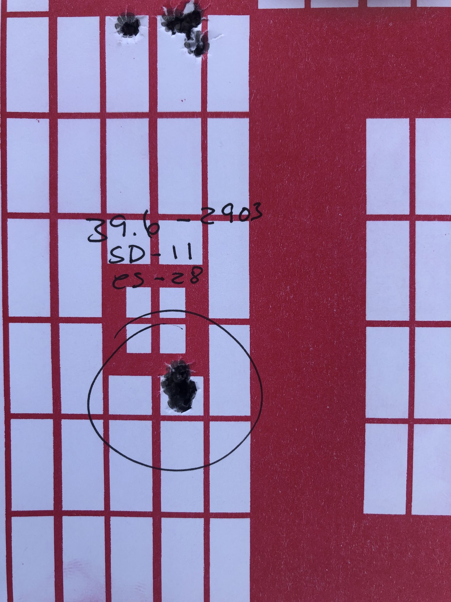

I’ve played with IMR and H4350. Pretty much identical. My node is 39.6 gr Cbto 2.178, running 2920 fps out of 26” bartlein 1/7. MY take on it is I’ll gladly give up a little speed for consistency and maybe a little more barrel life and less recoil.
