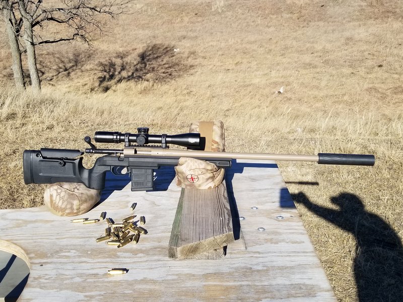

Here' my 6 creed coyote rifle.

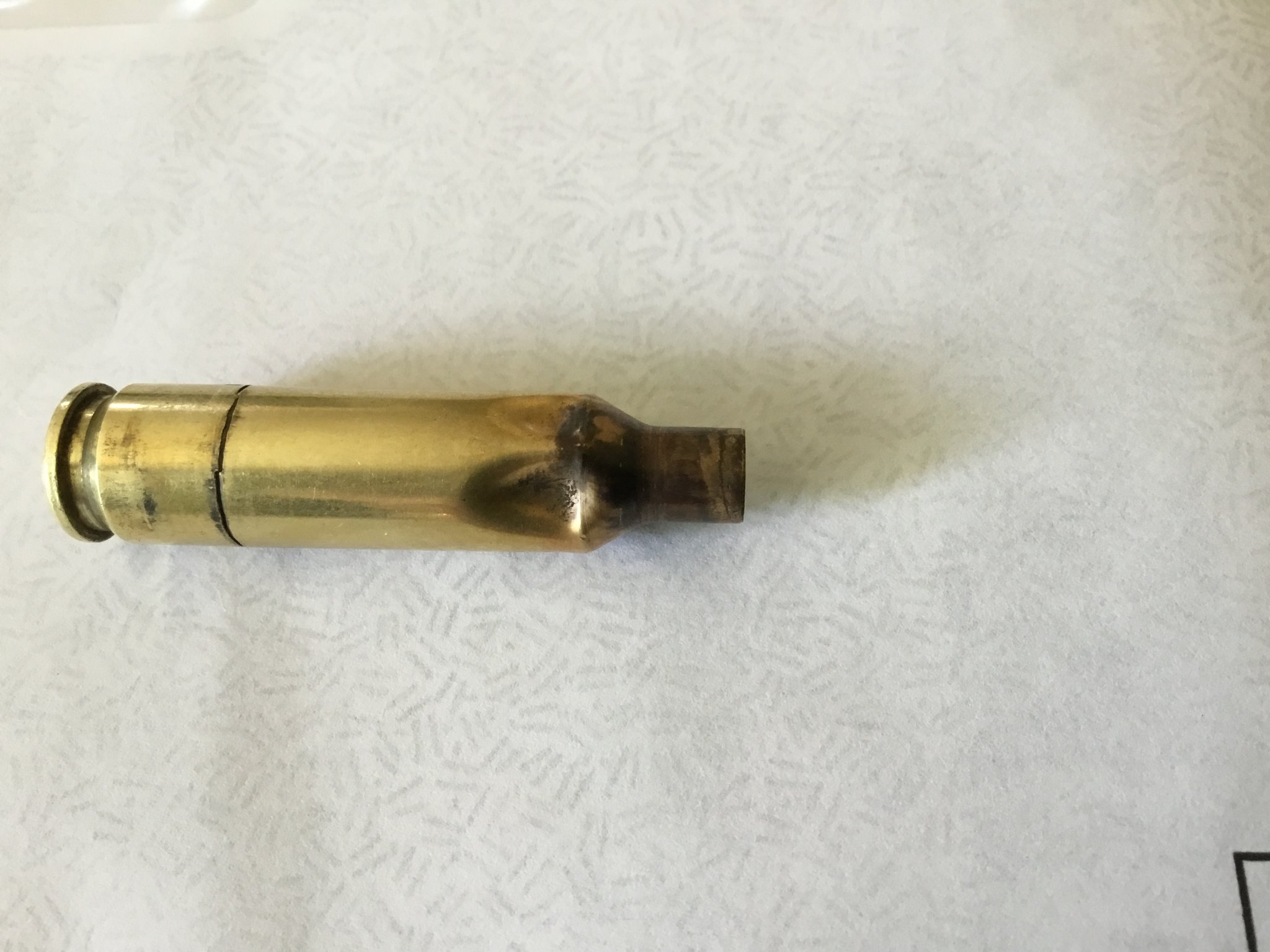

I think my 6cm barrel just went south during our match today, 1600 rounds. What a let down, I was really feeling good going into this match having scored very high scores in the last 3 matches with my current load. I think chasing the lands finally caught up to me.
time to build a 6.5x47 B....i shot 5 6CM barrels and the most i got was 1700 and that barrel was pretty loose...1400 to 1600 is pretty much the norm and why i went back to a 6.5...and you shot a pretty decent score with the issues you had going on....ive never seen brass do that.

whats strange is the dent in the neck/shoulder area....any ideas why/what causes that? ive blew several cases apart but ive never seen one do that.
