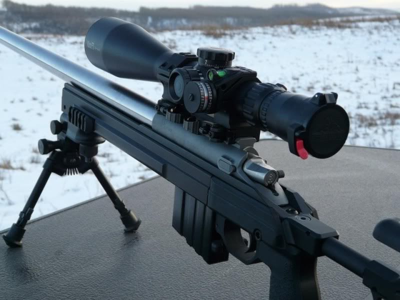

So this has been slowly coming together for the last 6 months. Surgeon came in to replace a Nesika KT action that was having issues. Originally had an AICS 2.0 but sold that to try the KRG. Loved my AI, but really liking the KRG. Distributed had a 6mm 1-8 twist Benchmark with a small scratch on it so I scored a deal on it. Couple minutes on the lathe and voila, no scratch. The 6mm crusader has been sitting for a while brand new and waiting to be used. My friend ordered it and just never got around to it. To many other projects. Anyways I figured I have been shooting 308 religiously for the last 4 years, lets try something different. Sold by NightForce NP-R1 (nothing wrong with it, served me well) and jumped up to a March 5-40x56 FML-1 first focal. Little bit of a change as I have very much been an MOA guy but want to challenge myself with more unknown distance stuff and filling so figured this was a good time just to do it. Only thing left to do know is Cerakote. Going to do a base in desert sage and then go from there and see what happens.

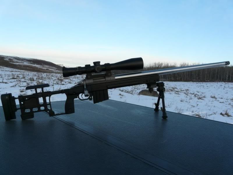

Barrel is 27 inches, little bit of a pig but the next one will be a medium or heavy Palma. This one is a heavy varmint profile. Also started shooting it without a brake and then thought, what the heck so we threw one on. I could watch my impacts before and now it just doesn't move so its easy peasy to see hits, and misses and make corrections.

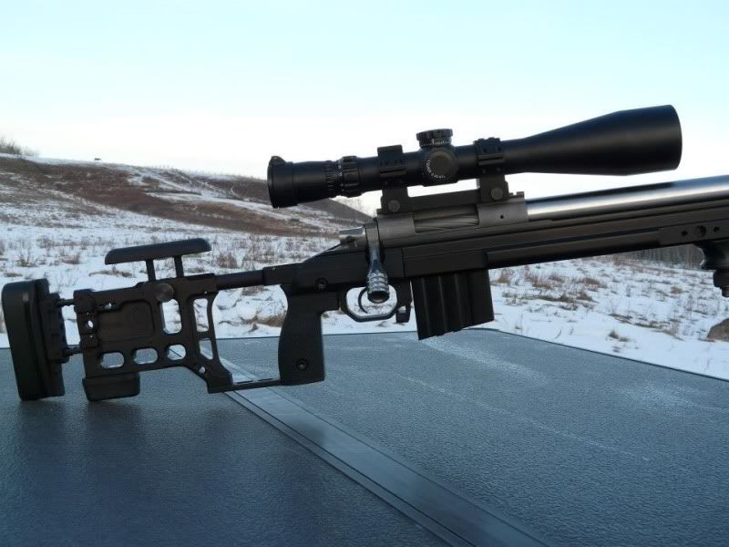

Overall I am pleased with every part of my build and hopefully I can get a range report (pics) up here soon. Doing a load work up using 117g matrix VLD's great bullet and a little easier for me to get then Dtacs so we will see.

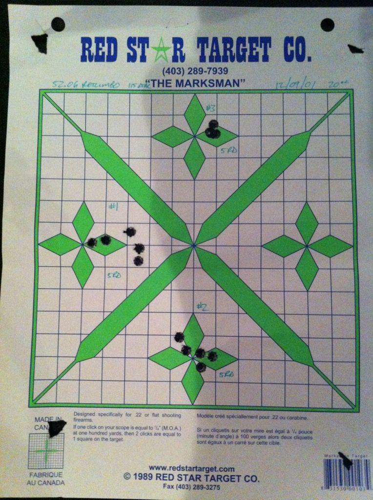

This was my first shoot at 100m with fire formed brass. I shot this on a hotter day with mirage and my eyes don't like the green. Washed out. Last group I got smart and dialed back my power and tinted out much better.

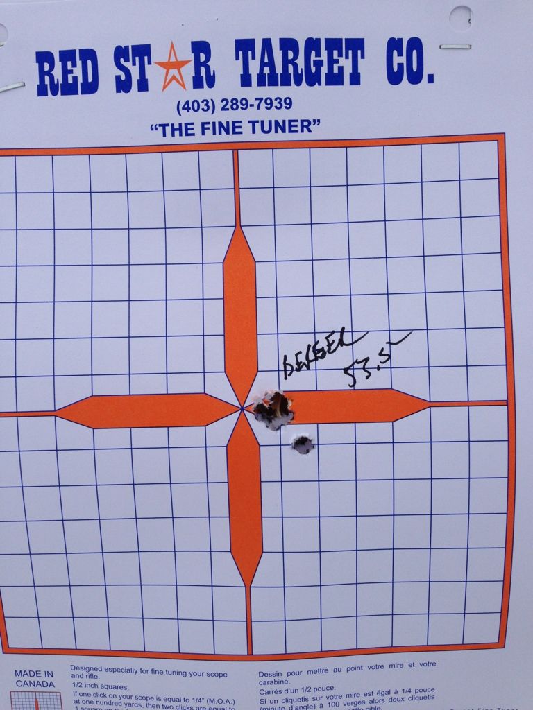

Next was some load work up at 130m. Was what I could get. 100m was in a dip and then past the 130m the hill dropped of so I was SOL.
