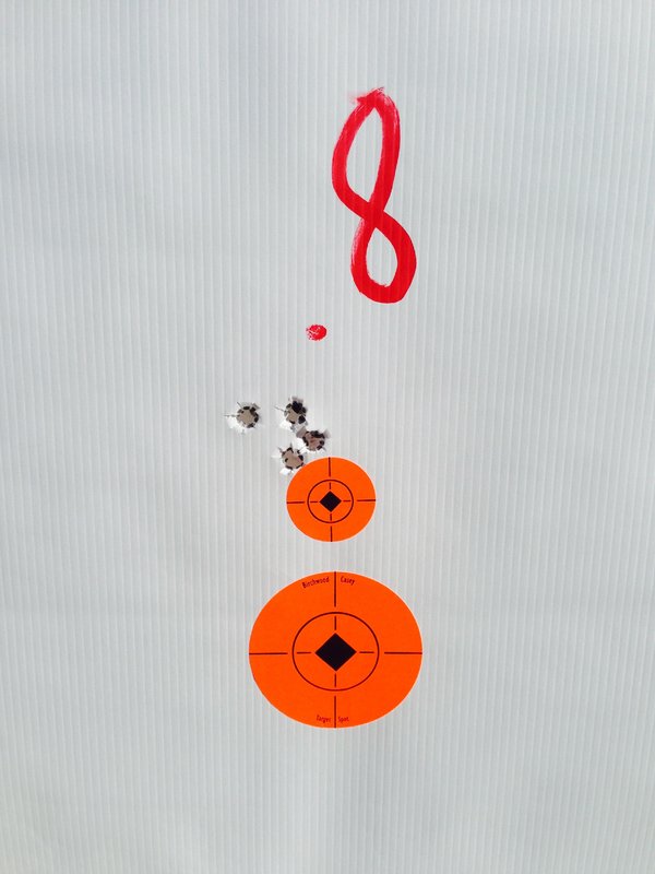

Shot with a modest 31.5 grains of IMR 8208 XBR with 80 grain flat base bergers at 240 yards. Got 3105 fps and shot half MOA. At 100 yards we stacked bullets on top of one another. We just used this load to fire form our lapua brass. Can't wait to shoot the 105s to see what happens. I wonder if you give up barrel life to the IMR XBR vs Varget? Any thoughts or experience?

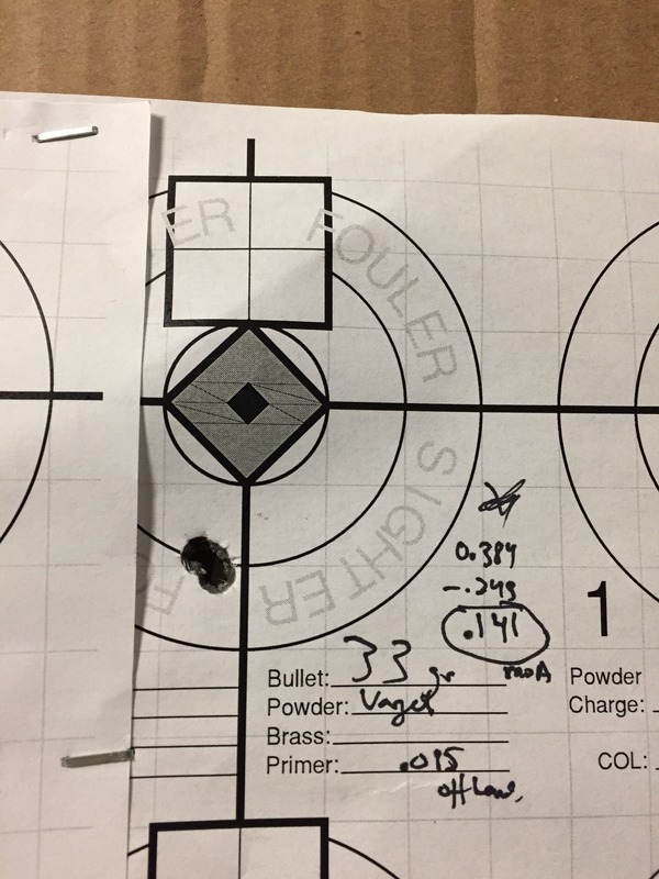

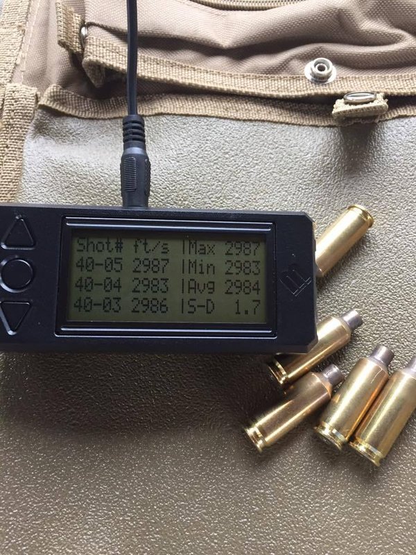

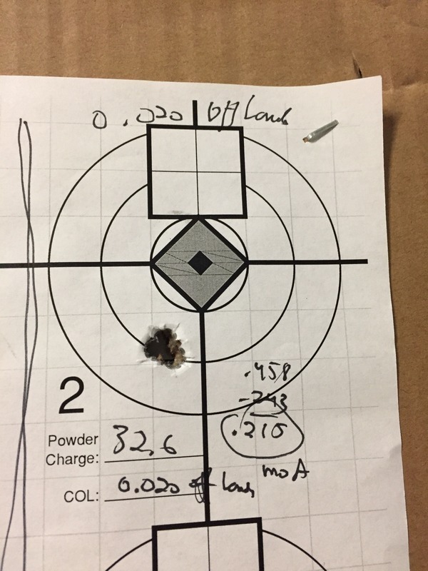

Specs:
26 inch bartlein barrel
1.555 chamber
272 no-turn neck
104 freebore
Defiance Deviant action
Primers CCI450
False shoulder formed brass
105 hybrid seated 0.015 off the lands
32.6 gr of Varget = 2978 fps (on average) SD 4.2
33.0 gr of Varget = 3006 fps (on average) SD 5.4
On a colder day 33 gr varget 2984 fps SD 1.4 ES 4
