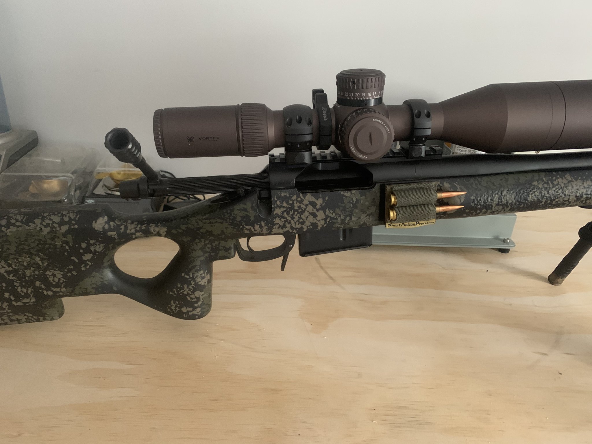

I’m running 87 gr Berger VLD’s at 3150 FPS. Rem 700 243 with a 21” barrel TBAC can. It’s a coyote smacker for sure. You also might look into the 6 Creedmoor Couple guys around here using them on coyotes with good luck.

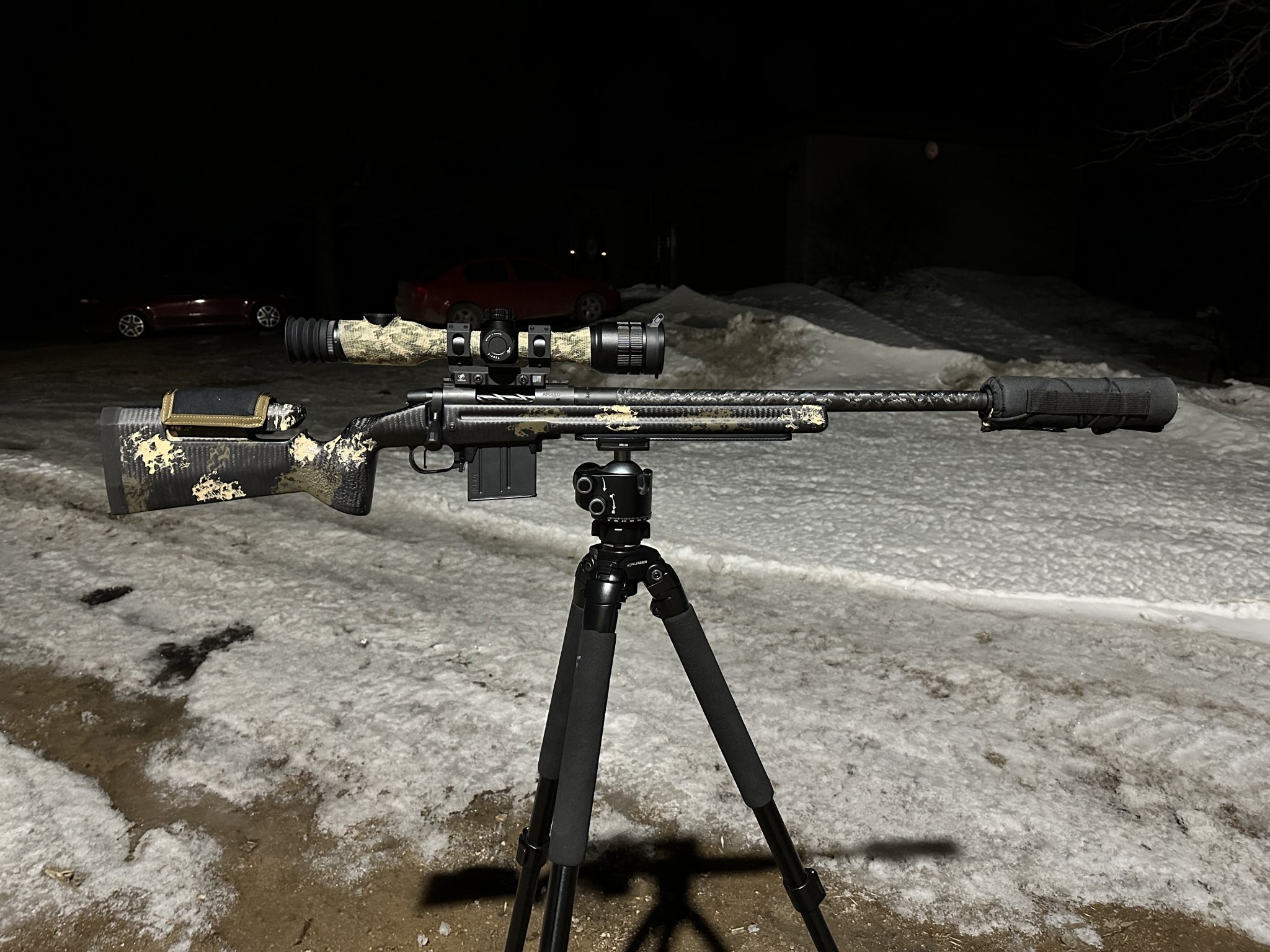

I’m sticking with the 6 creed. It’s pushing 87vmax pretty dang fast and I think it’s the a sweet spot between speed, recoil, barrel life etc.
