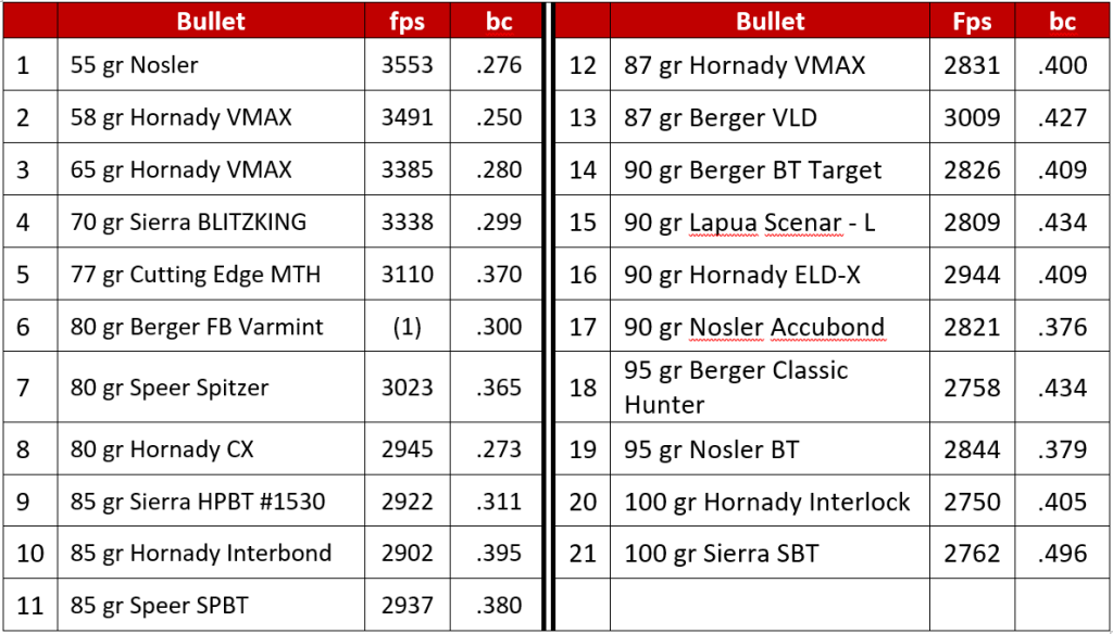

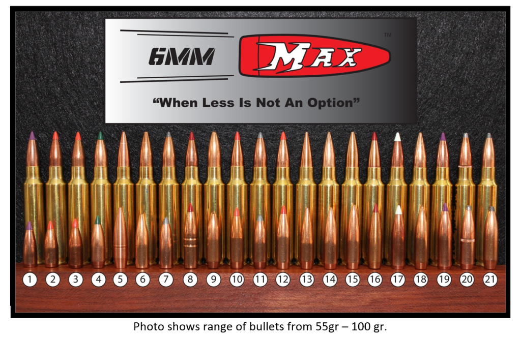

The 6mm MAX velocities/load chart can be found on 6mmmax.Net

This appears to be about even with the ARC @87gr & may be better with under 87. It's a varmint round. I mean cool if that's what your after, but I like heavies.
This is the 6Max load for 95 Berger's from a 24" barrel. 100gr is the heaviest projectile they list.
My 6ARC with 30.4gr Lever & Berger 95 VLD's runs 2933 from a 22" barrel. That's the lightest projectile I've run in the ARC.

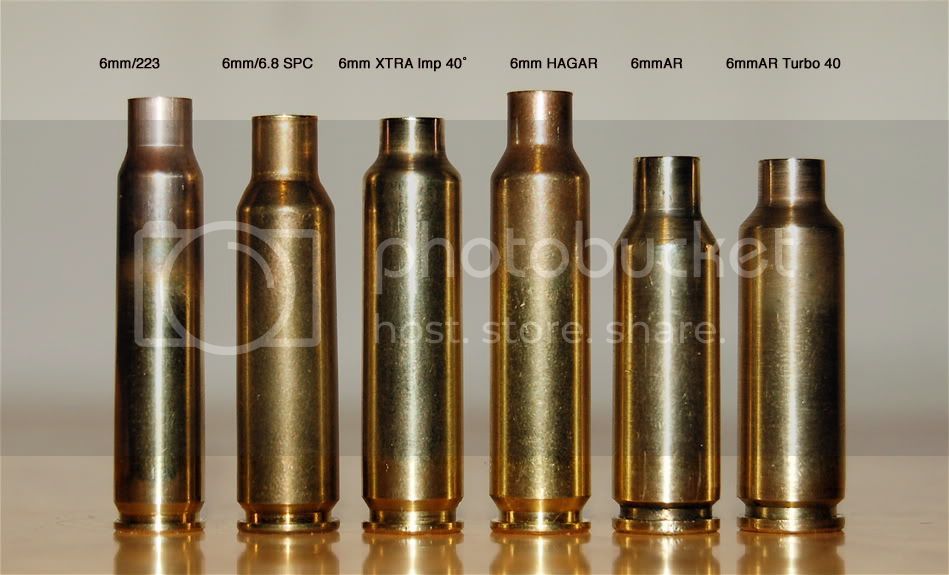

6mmARTurbo 40 is about max you can push 6mm within Ar15 mag limitations has about 4+ grains on 6ARC case volume , and unlike many smaller rim cases it doesn't burry the bullet deep in the case.

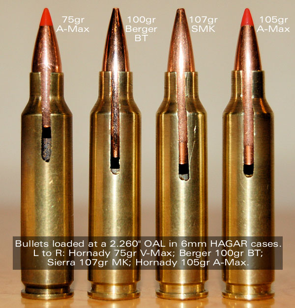

I agree they should have shortened that neck some to take advantage of the heavies too.....not like it aids in case capacity.
I made a wildcat of a wildcat to toy with in the AR myself. My reasoning is because i'm a cheapass lol. I like 223 brass as it's virtually free and LC brass is decent stuff.
I made the initial cartridge to be a full length 1.75" case and setup for the 105 class as a cheap cartridge to let my kids shoot and possibly build them a howa mini as their first deer rifle with it.
Took the AI concept but with a 30' shoulder then built the rest around the bullet. I have yet to spin up a barrel for the full length but did make a 14" barrel for an AR. And it's not too shabby. I got 2380 ft/sec but will likely throttle it down to 2350 as a buffer (live in AZ where it get's hot as balls)
I need to finish doing load dev and start shooting it more. I just have a couple oh I dunno 2-3 (ha!) irons in the fire :LOL:

6mm Hagar (screamer but no high BC bullets)

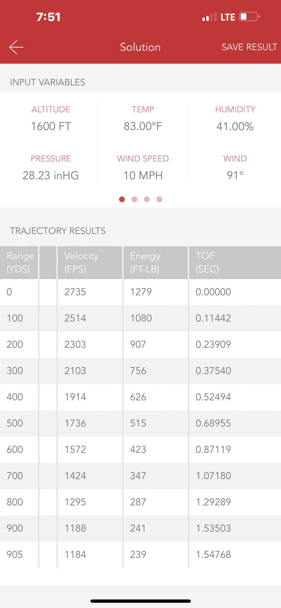

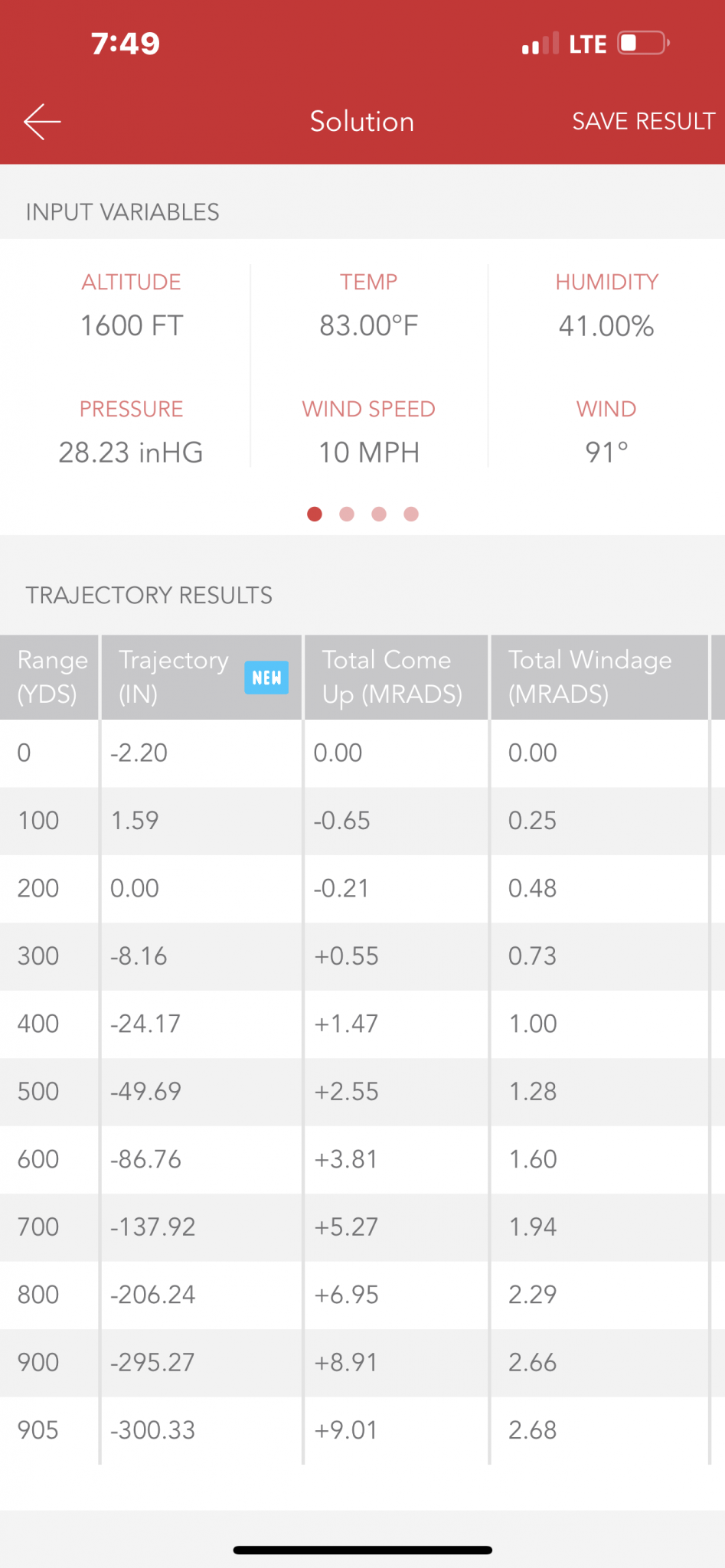

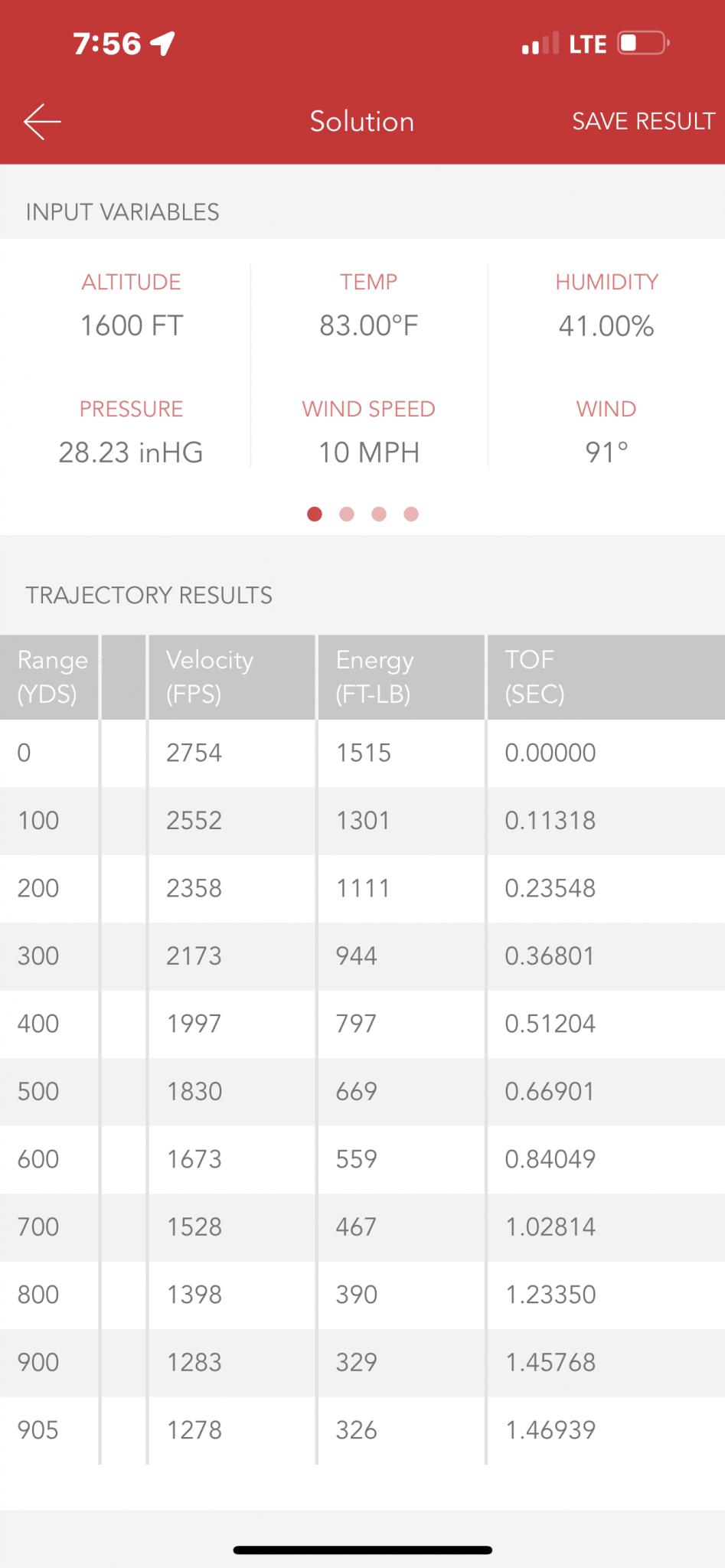

90gr ELD-X from an 18” will be doing 2754fps avg based on their 24” published data.
Using Hornady’s doppler program with that bullet, it goes subsonic between 850-875yds.
With 90gr Berger (same published BCs as the 90gr ELD-X), they showed 120fps mv slower than the Hornady bullet.
90gr 6mm, .409 G1 BC reference (actual doppler track data used), 2754fps mv

77SMK IMI Razor Core drop test today with these atmospherics: 905yds test
Switch to 6mm Max inputs same atmospherics:
