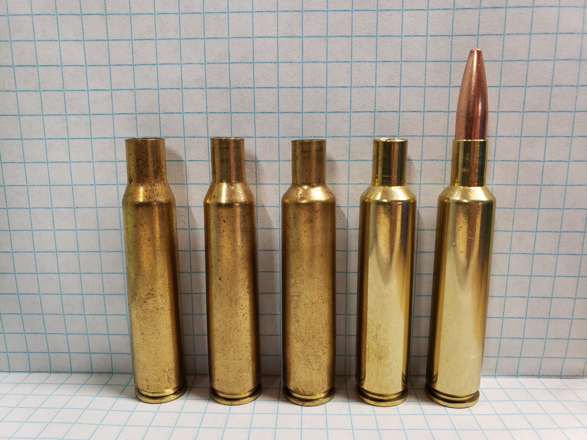

6mm AI was one of my first wildcats, and is the only one I still have.
I start will 7x57 and run it in the 6mm FL sizer. Fireform with cream of wheat, then neck turn.
I have a tight neck chamber, so I have to turn before loading and firing a full load.
Quite a bit of work, but I like the process...
It's a hunting rifle that doesn't even get used every season, so the original batch of 50 pcs will likely last my lifetime.
