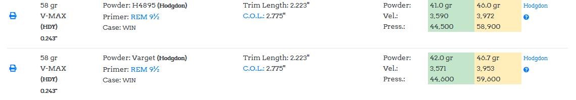

    I'd pick something in the lighter, shorter bullets. Probably closer to 60ish grains. Like this

    I thought I remembered reading that the 6mm rem was designed to shoot the 90-100gr bullets? I wouldn't want to shoot deer with a 55gr bullet. I'm sure they will die eventually, but it wouldn't be ideal..
