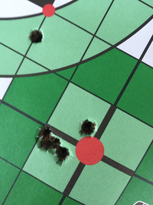

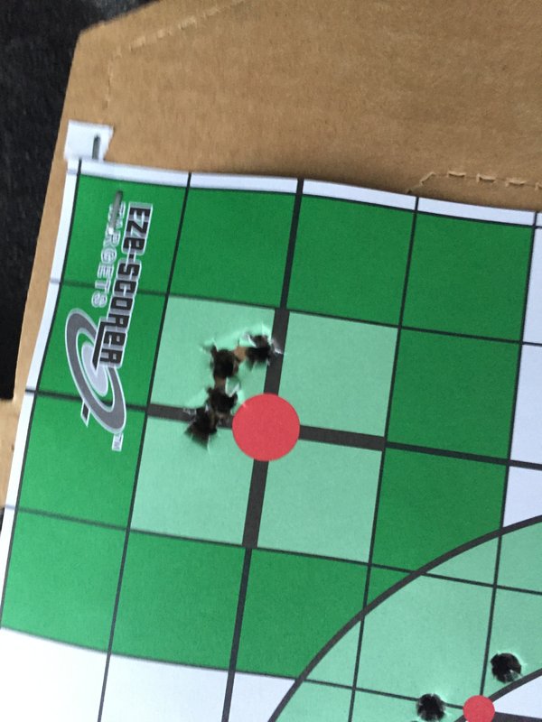

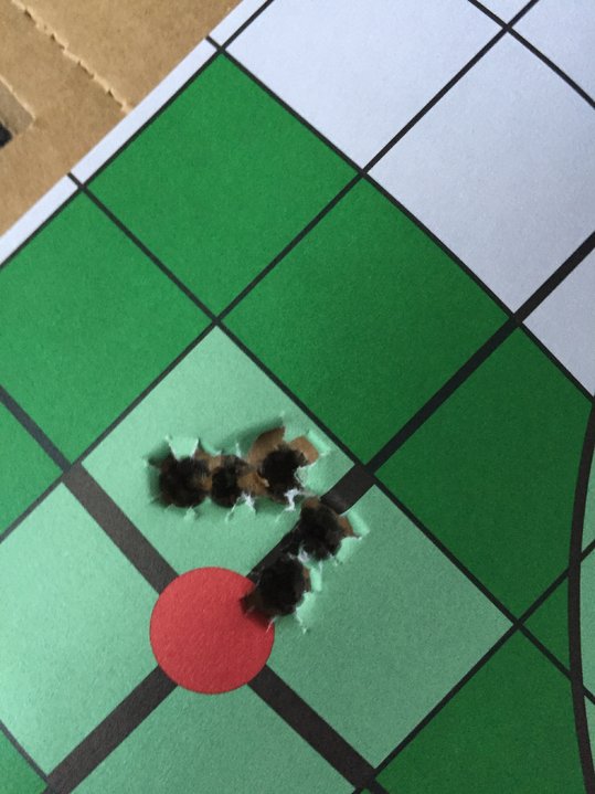

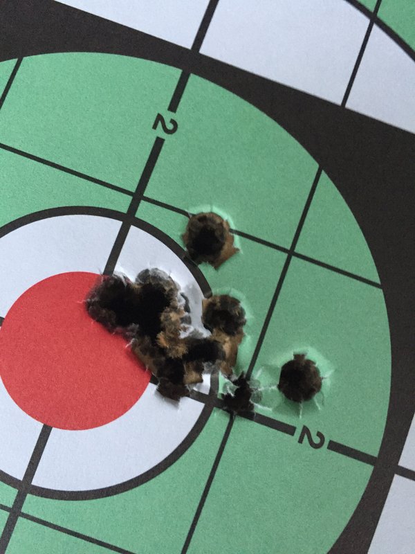

    I made it out...
    105 RDF's/28.1 grains RL15/2620 FPS (slight case swipe, primer is perfect) 1 moa pretty consistently
    85 smk/28.8 grains RL15/2780 FPS (no pressure) .5-.7 moa.
    I'm done with the 105 class projectiles. 85-95 class projectiles are what I'll load for here on out.

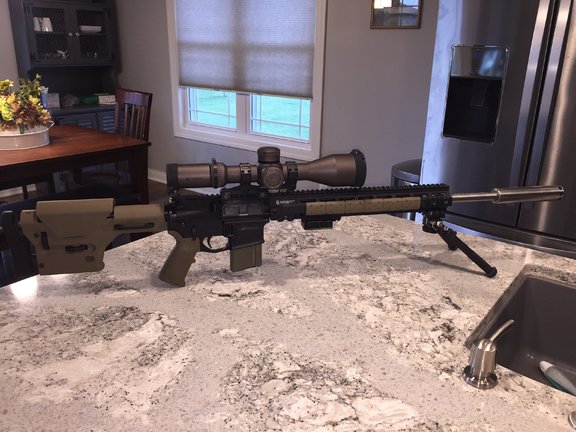

    27gr of reloder 15 in Norma brass with a 107smk and wolf sr primer. 22" BHW 243 LBC Barrel with a silencerco specwar 7.62. Have shot groups in the .2s (admittedly very few) but it consistently shoots .75 MOA.
    85 smks, shoot just fine... may use them on coyotes.

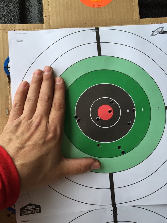

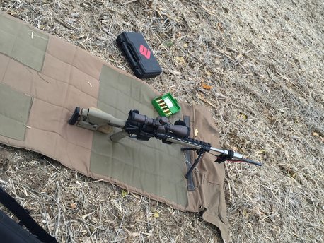

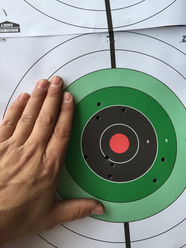

    Why are so many people worried about speed? I go by how accurate the load is from 100 to 850 yards. I will put my Fat Rat up against any bolt rifle, one good thing I enjoy in the matches is I can see all the bullet strikes and misses. These guns have almost no recoil with using a adjustable gas block and a silent capture spring.

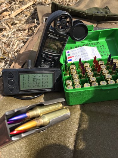

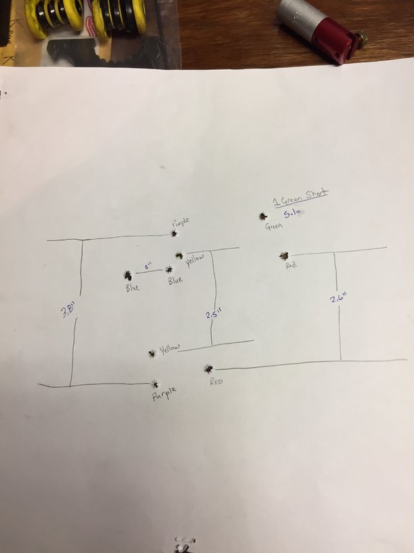

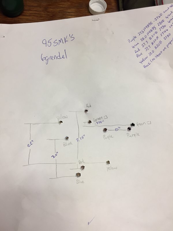

    300 yards. 95 smks loaded with various charge weights to check vertical dispersion. 300 is not be enough to really tell the tale. Limited on time and land.
    Dope on gun- 1 mil/.7 wind (14 mph wind)
    27.5 h4895- 2761 FPS SD 5/ Es 13
    28.0 h4895- 2801 FPS SD 5.3/ Es 13
    27.5 8208- 2730 FPS 5.9 SD/ Es 13
    27.7 8208- 2746 FPS 14 SD/Es 38
    28.0 8208- 2780 FPS 12.4 SD/ Es 33
    28.5 8208- 2816 FPS 7 SD/ Es 18
    I agree. A 6.5x47 is no speed demon but is a great cartridge. Most the team AI shooters run 140's at a modest 2700 FPS. I'll take a consistent load over an erratic speed demon any day.
