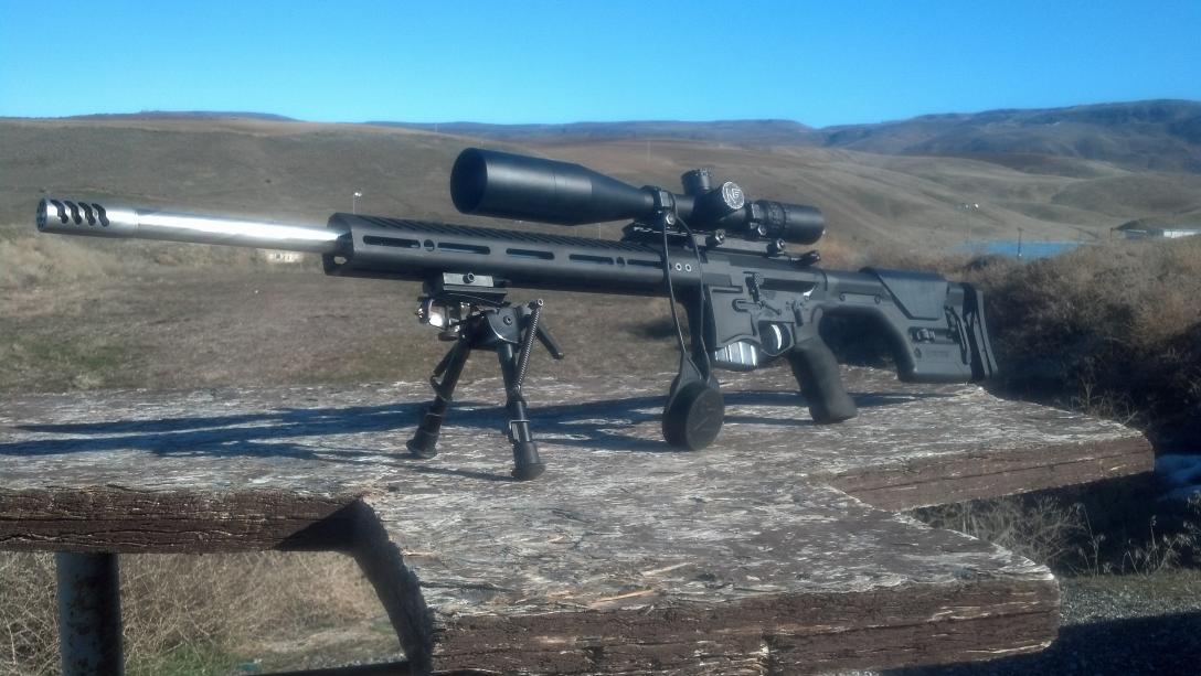

Been thinking about building a 6BRX for a few years and i just decided i didn't have time to make brass, so i did a standard 6br. Plan on running it at a few comps this year that are 600yd or less. Phoenix next weekend being the first. It shoots 95gr SMK's allot better than i can drive it. 10 shot groups are much impressive... This is with 33.5gr of superformance powder and 205m primer. I have not put it over the crono yet, but no pressure signs at all so ill probably stick more in. Anyone else play with this combo for anything? Im looking for as much velocity as i can get and i tend to be on the..hot side of things usually.
Specs case your wondering.
Our billet AR15 lower, 3gun upper/15" rail
National match trigger
Magpul PRS stock
22" Rock Barrel. 1" from upper to rifle gas block. .75 gas block and .74 to muzzle. 1" section is radial fluted. deep at the gas block and shallower as you get to the upper. Looks pretty wicked!
our adjustable gas block, Melonite gas tube
our 5/8-24 30cal comp
1.26" 34mm rings
Leupold MK6 3-18 with Horus ret.
Cant remember where R-bros got the bolt and extension from?? its BIG lol
11.5 lbs loaded..
