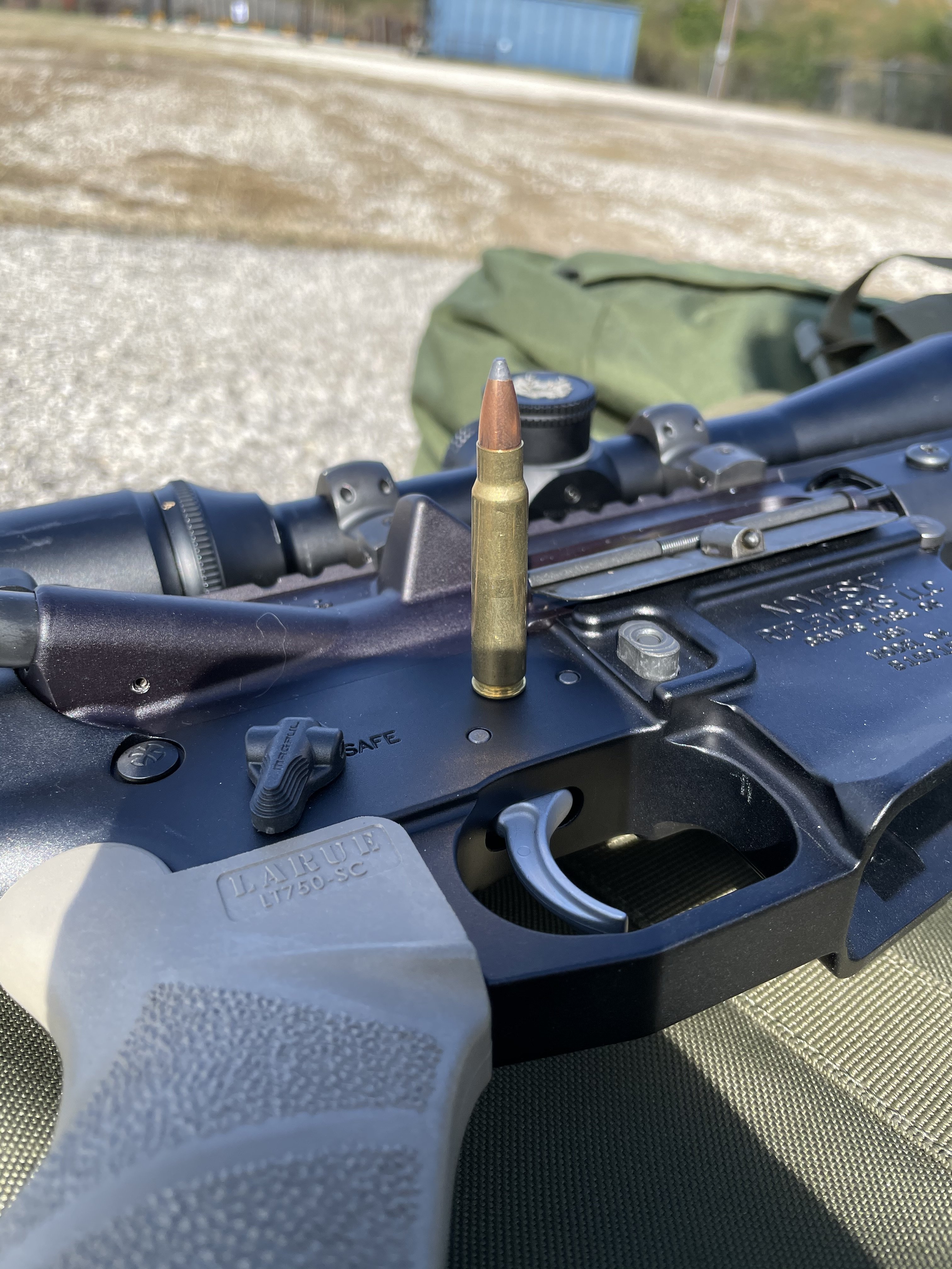

I enjoy 6x45. Have a few carry handle ARs in it and a old Steyr scout for when I’m predator hunting in the PNW. Not the greatest caliber but its fun enough to try out. Shoots far faster than normal .223, but the option to have heavier slugs drew me to it.
Practical sense tho, 6ARC
Reloader sense, 6x45 or 25x45

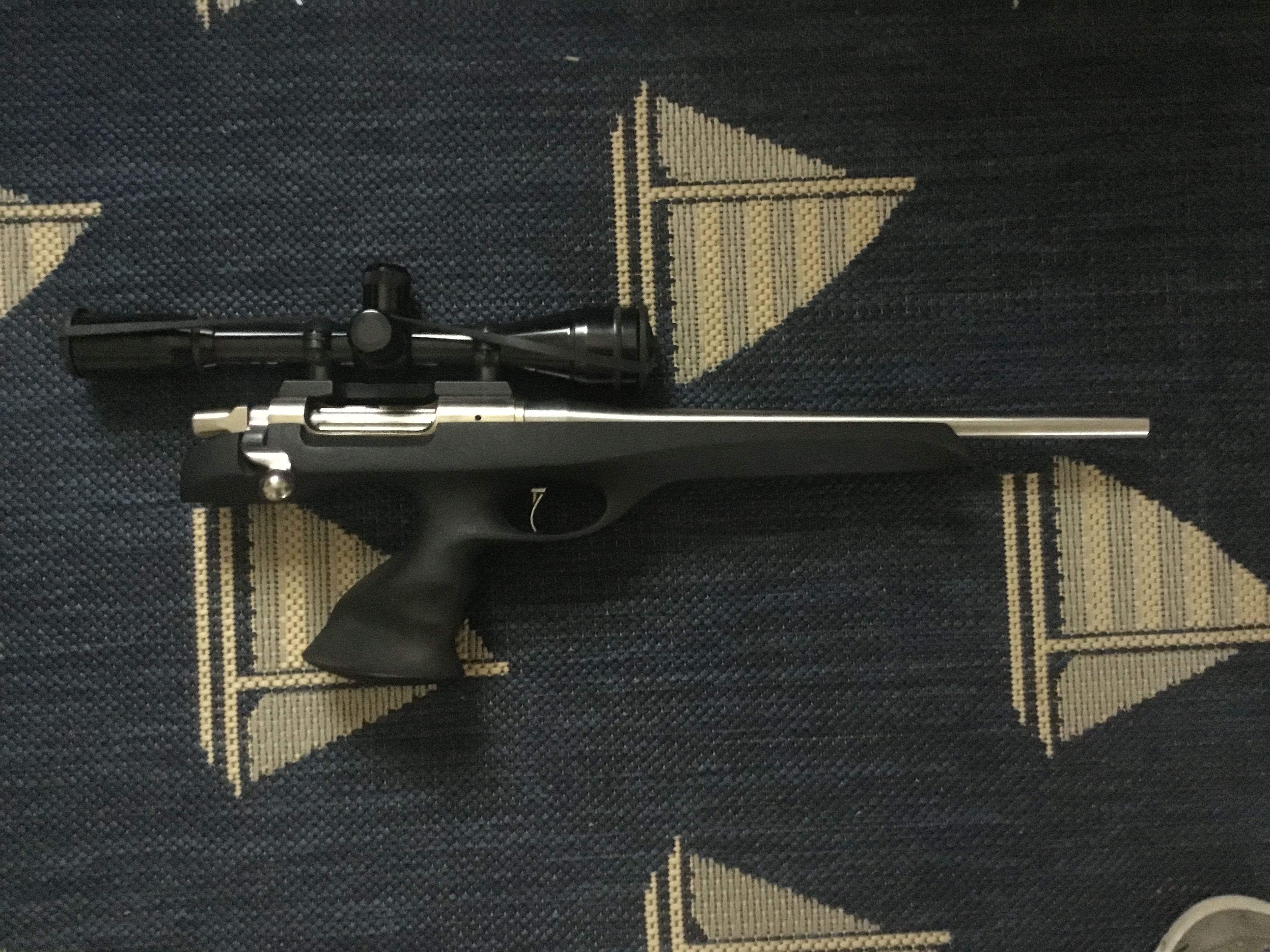

The 6x45 and its cousins the TCU series, 6, 6.5 and 7, are all really good rounds. Exceptionally easy to make (though through the years, I seen multiple people do their very best to make it difficult). Back in those years, we didn’t even use expensive brass. Winchester brass lasted as long and shot as good as Lapua. Load the rounds on a progressive press on Saturday, shoot a 40x40 on Sunday
One pass though the resizing die, fireform using match capable loads, and never have any issues. Brass lasts forever, Barrel life, for these rounds, barrel life is not defined in Websters.
I’ve owned a 7TCU for decades. Purchased it from a friend. I can’t imagine how many rounds have been though that barrel. Obviously thousands, with the number on the far left being at least 5 or larger. Shoot’s shockingly good groups, like something around an inch at 200 meters. (Still).
Almost want to make a Precision Rifle in 7TCU, add roughly 300-400 FPS with a 26 inch barrel over the 15 inch barrel, which still gives a rainbow trajectory, but heck, that’s what they put those dials on the top of scopes for. (And bases/rings that are 20MOA and greater).

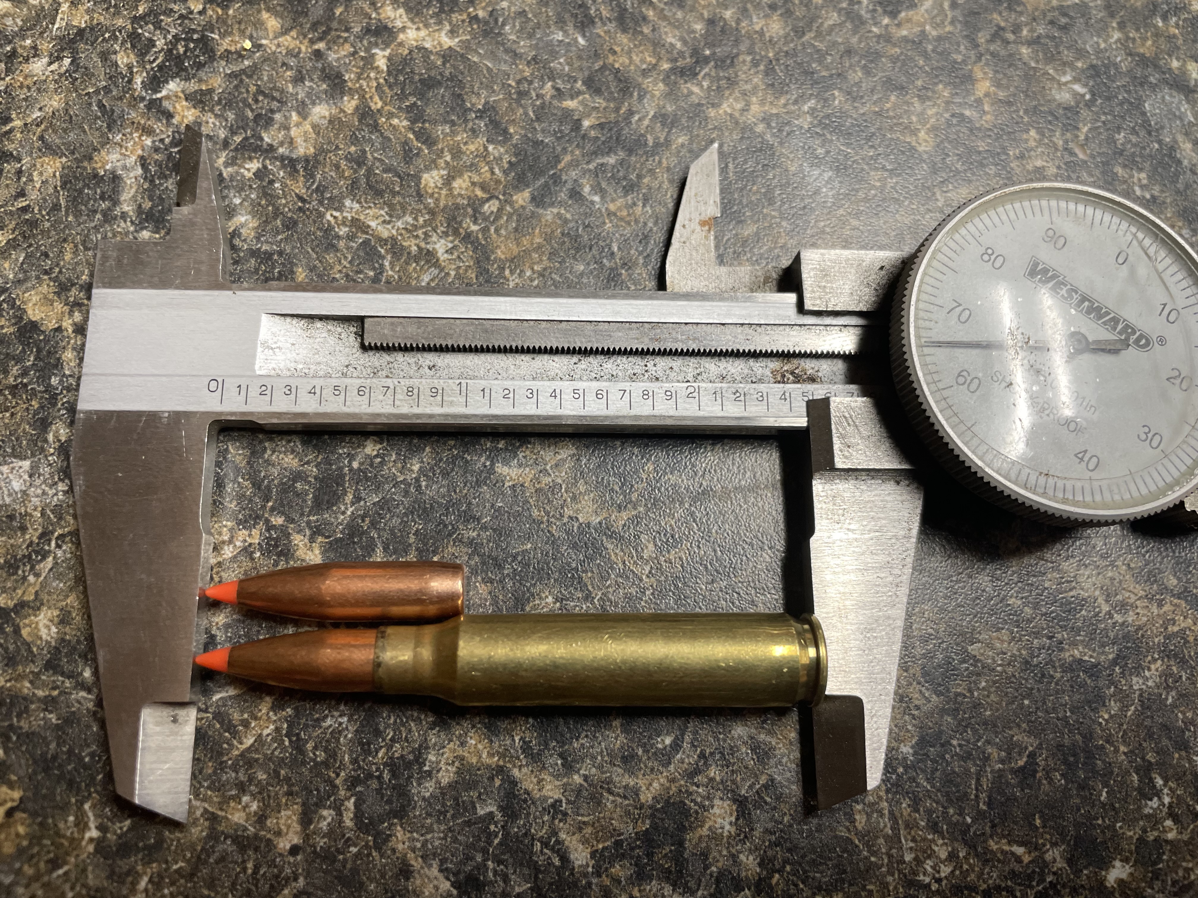

Can you get a long bullet in your mag and seated out far enough to give decent powder space? I am all for anything that can be made with 223 brass. That stuff is practically free. 🤣
All of ours were single shot, however, several years ago Reloader magazine published an article on the 7TCU in a bolt action rifle.
