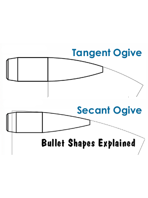

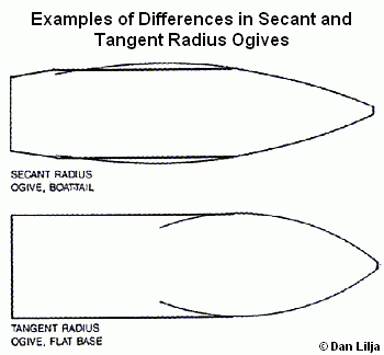

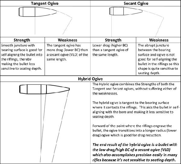

The vld is a secant design, the hybrid is a well... hybrid of the secant and tanget designs.
The secant design has a pointier nose but if you were to continue the curve of the nose it would extend past where the bearing surface cuts it off. It makes a shaprp transition. Since its sharp its more sensitive to where it actually hits the lands (seating depth).
The tangent design has a nose in which the curve smoothly transitions into the bearing surface. Since its smooth it is less sensitive to where it touches the lands.

On another note, what advantages does the hybrid have over the vld that might make them not a choice for a PRS application?
As for why they hybrid would not be a good choice? There isnt really one. They are a great choice if you dont mind paying berger prices.

About the hybrid over the vld, you find a seat depth that is satisfactory with a hybrid, you could toast your barrel w/o ever chasing the lands like you will with a vld.
Accuracy and consistency (for me) with the 47 is best when you keep them at dasher speeds. You can hot rod it and still shoot good groups, but day in / day out consistency will suffer. And yes, hybrids are the easy button.
