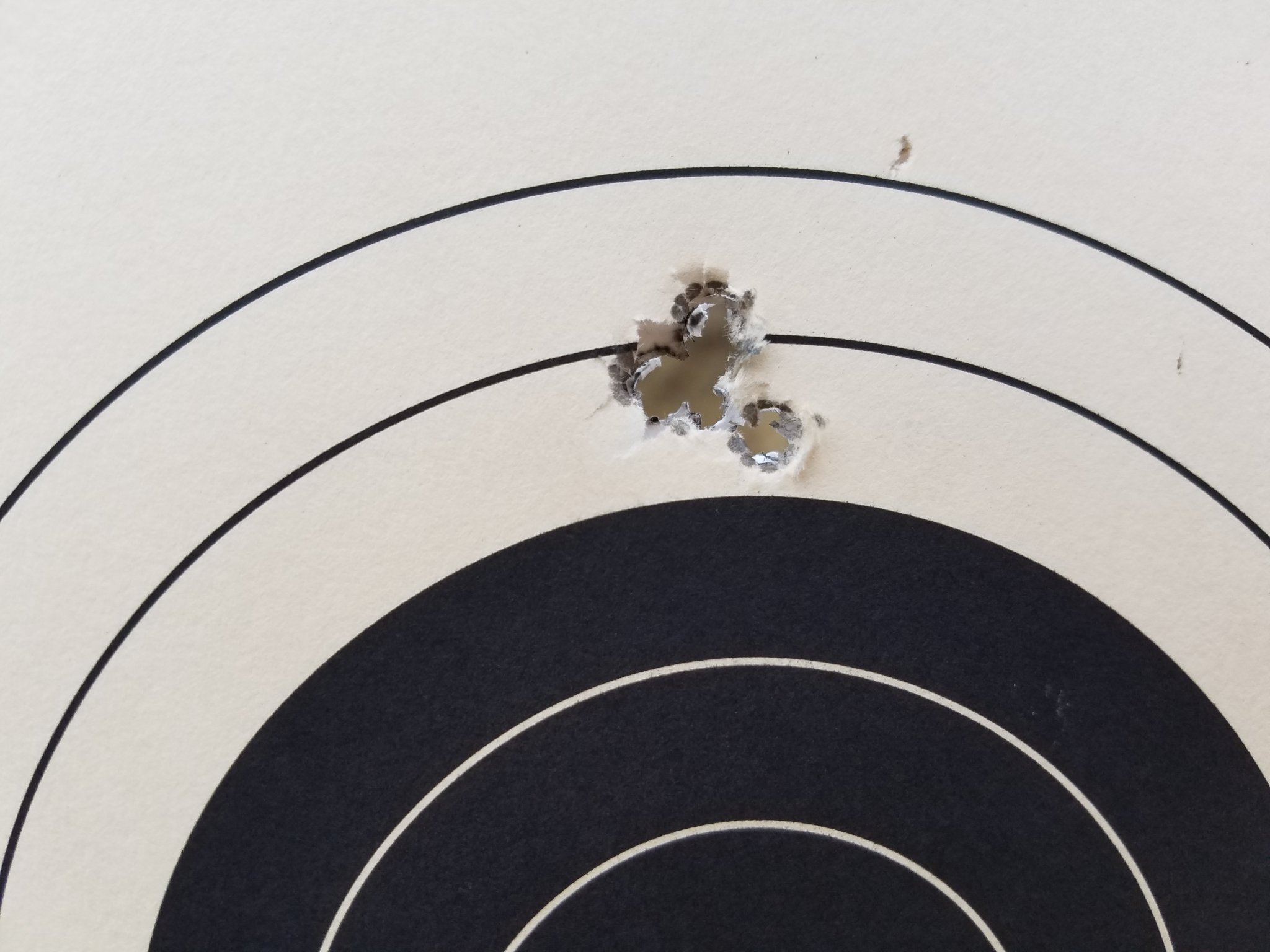

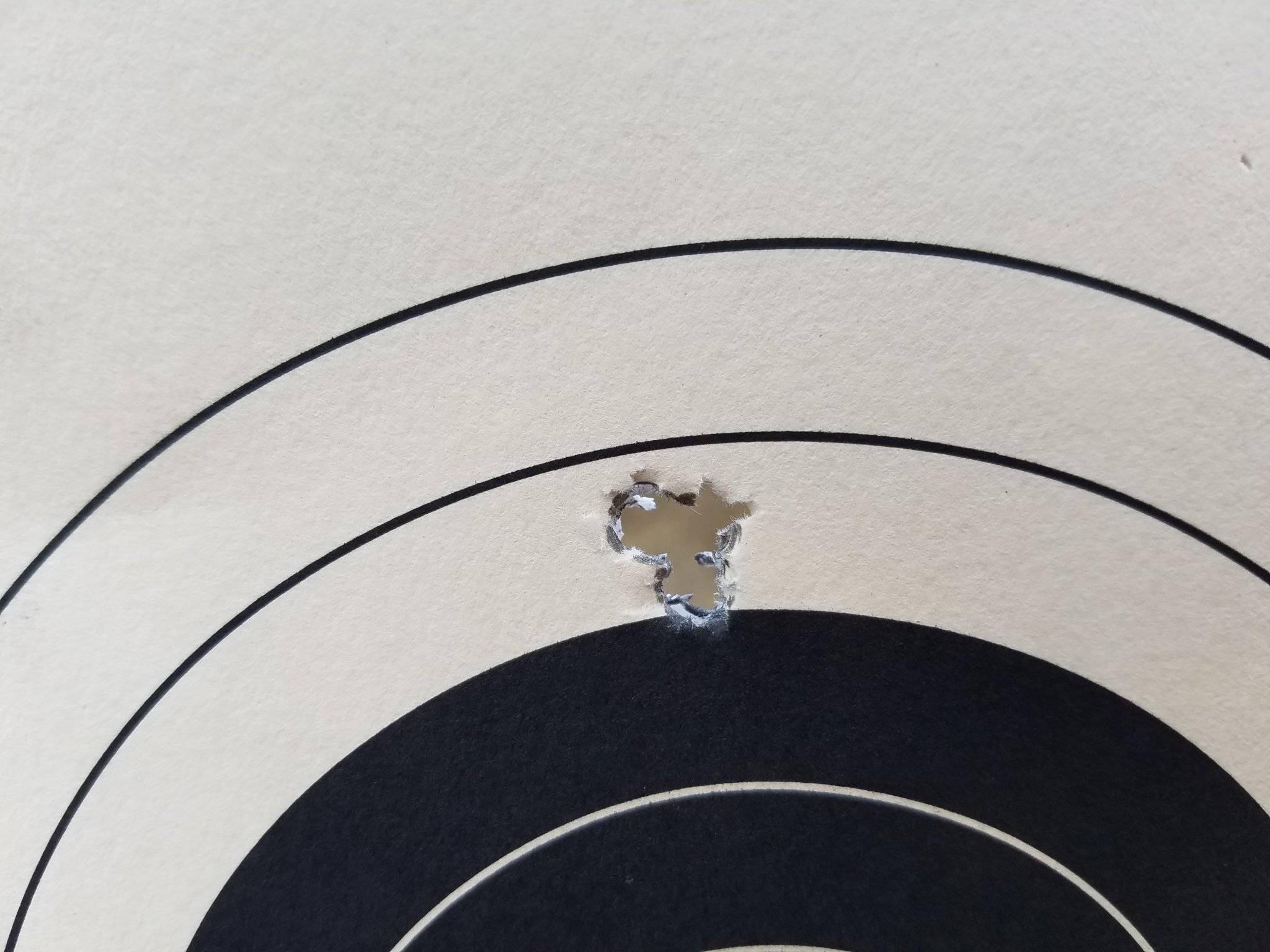

Preliminary results, as I'm still testing seating depth, but so far
22" Kreiger 5R 1:8
105 hybrid
39.8 gr of IMR4451
3040 fps with single digit SD's
groups were in the high .4's and that was with zero seating depth testing, and on virgin brass IIRC after checking the chamber they were jumping about .060" I'm hoping to get those groups down into the .3's consistently by messing with the seating depth. time will tell.
This is a brand new rifle and caliber for me so this is pretty early, I tested H4350, IMR 4451, and H4831SC got similar results from H4350 and IMR4451 so decided to go with the IMR since I can actually get it in 8lb jugs and I'm down to my last jug of H4530.
EDIT: Update with 400 rounds on the barrel the above load has now increased in velocity to 3120 fps and retains a low SD however it's on the edge of pressure issues when it gets hot. I've seen the exact same thing happen in my 260 with H4350, so I don't take this as an instability issue with the powder, it's just pushing the load a bit too hard.
I've reduced the charge to 39.5 gr and I'm still getting 3060 fps with an SD of 5 and grouping in the .3's

Got my 6x47L load shook out well enough to share it. It's right in the wheelhouse with some others posted...
23" Bartlein 5R .237 bore, 1:8 twist, 150 rds on it.
Berger 105 Hybrid
2.660" (.015" jump)
39.3gr H4350
CCI 450
3000 fps (2998 avg for 10 shots), 11fps ES
Temp 50 °F. DA -230ft

Thought id touch back, final load development with tbn coated 115dtac&4451 .015jump
bartlein .237 25" gain finish around 7.77tw
ran it @ 41.3@3040 for 500rnds with great results but decided i was pushing the top end.
dropped to 40.2@2940 only loosing 2.7" drift@1000yd super stable load
again running coated 115dtac, 450rnds without cleaning and still shooting1/4moa

Just started into loading for the 6x47. I’m wondering what some have seen if anything from a velocity or accuracy shift between necked down brass first firing with false shoulder to second firing after it has been “formed”??
Just got this barrel and did some velocity ladder tests for max load even though I’ll need to run again after it speeds up, and working on seating depth right now with 110 smk. Using necked down lapua brass and varget. So far pretty pleased with initial results but wonder if I will have to make any adjustment to load after brass all has 1st run on it.
I'm seeing a 30-50 fps reduction on the 2nd firing.
24" 1:7.65 Proof Barrel
205M Primers, 105g Berger Hybrids
37.2g Varget - 3,098 fps 1/4 MOA
40.5g H4350 - 3,130 fps 1/4 MOA
Single digit SD's, occasional single digit ES ...
H4831SC: not enough case capacity to get these moving well but SD's and accuracy good ... stopped testing ..
Note : 39.8g - 41.0gr H4350 shoots 105's, 107 SMK and 108g ELD very well ... from 3,070 - 3,150 fps
Reactions: goin_long
26" Bartlein 1:8
CCI450 primers, 105 Berger Hybrids
39.1 RL16 - 3020 1/4 MOA
SD's usually ~ 7.
26" Bartlein 1:8
SD's usually ~ 7.
How many rounds are on your barrel? I also have found ~39gr to be the sweet spot for RL16.
