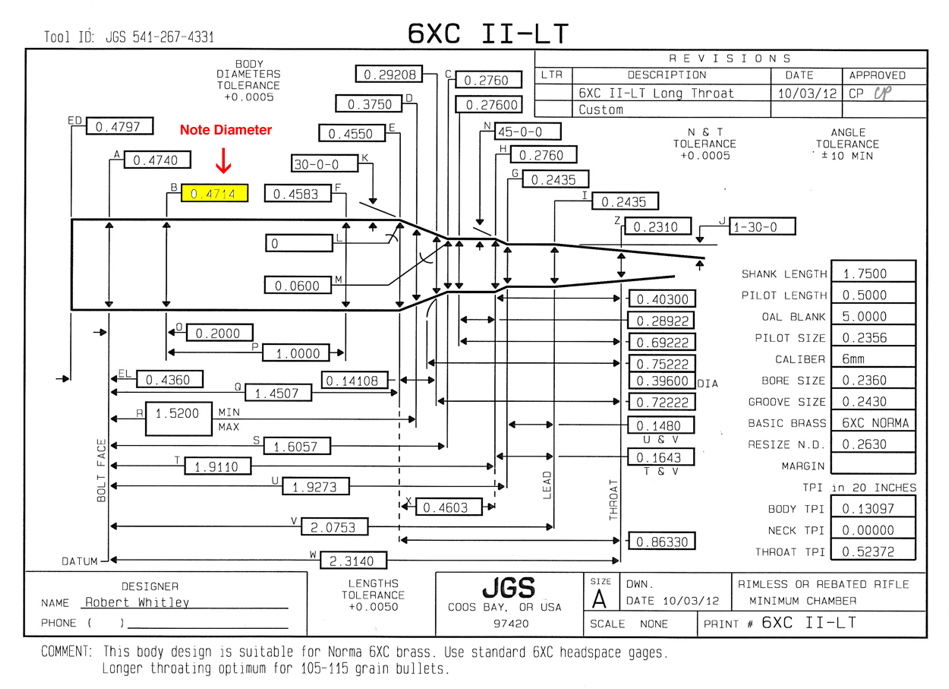

.472 is larger than even the 6xcii proper should allow.
7057842
Ok..measured at .2000 as per the diagram, it is actually .471. Definitely a XCII chamber, was cut by PVA.
