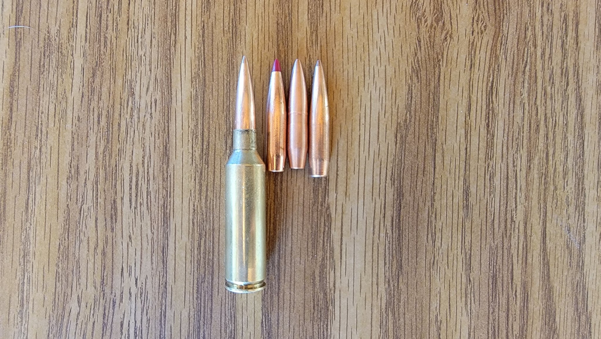

I did one, a 7mm-6.5 PRC. Well, I guess the appropriate way to say it is "doing" one since the barreled-action has been at the Cerakote guy for like 5 months so I haven't fully put the rifle together yet! Mine was designed to use a SA (I had just traded for an Archimedes so I just switched the BF to 0.532 and off we went) but the bullet I originally wanted to run, the 190 Hybrid, was way to long. I switched to the 180 Hybrid and, while sitting a little deeper than I'd like, it's acceptable at just below the body/shoulder junction. I know, not ideal but it'll work. I'm also building a little stock of 166 ATips. They're of course lighter than we want to see in a SAUM-ish case, but they performed well in a 7mm-08 I had and out to a mile I think they'll do okay in this new gun. Plus, I can get them far more readily than the 180s. Actually, given the 2.95" OAL restriction of a binderless SA magazine, I pretty much think of this as a grownup 7mm-08, and I'm okay with that for now. I may sell this in the future and move to at least an XM so I can really get all the ability of the case. I may also do a single feed-only 190 Hybrid load but we'll just have to see.
7mm-6.5 PRC: 180 Hybrid > 166 ATip > 7mm08 w/ 166 ATip

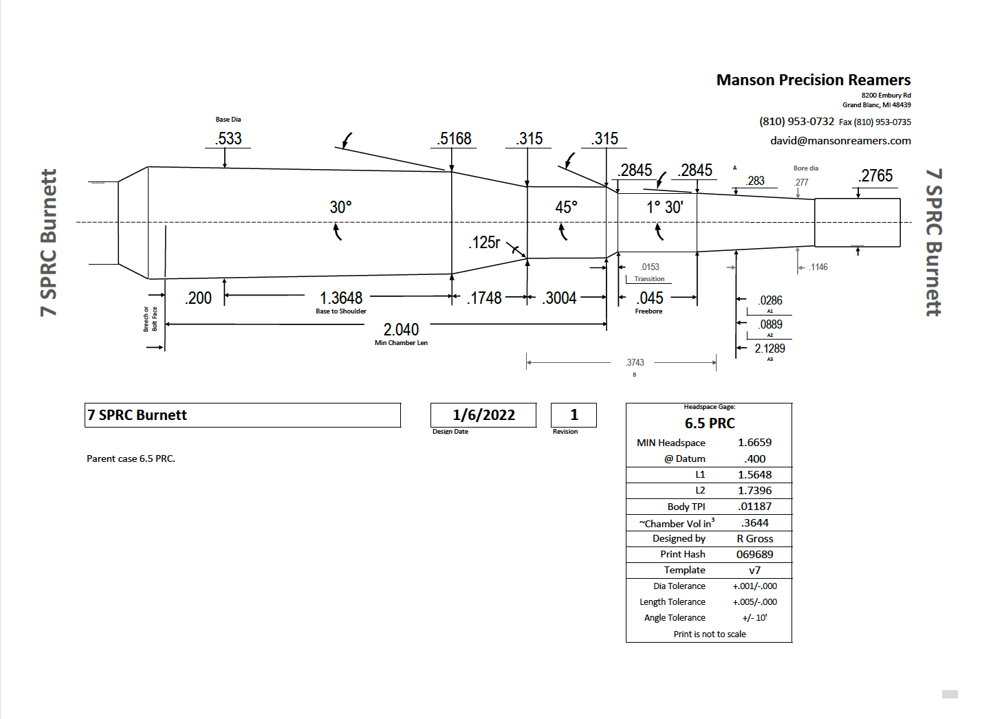

I modified the 6.5 PRC reamer print and included the slight body diameter modifications to prevent sticky cases. I also left the neck near 7mm SAAMI spec as to avoid turning brass. I will likely need to turn shoulders after the first or first couple firings.

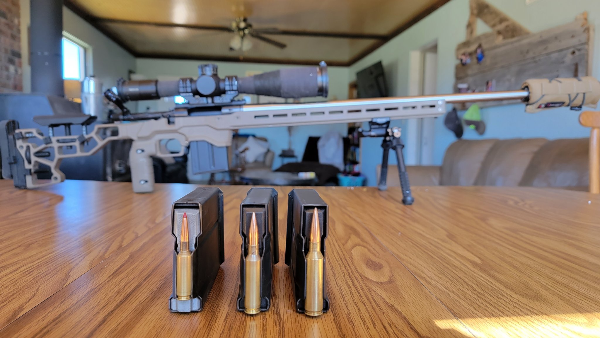

Again this would be in an MDT short action mag. 2.955" max.
Any other bullets worth looking into? I think that 180 is pushing it in a short action but I'm not sure what else is even worth looking at.

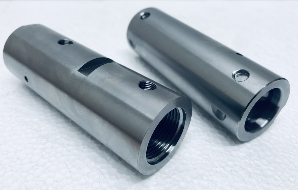

First question: How many rounds do I need in the magazine with an overbore barrel burning magnum for hunting or elr?
If 3 rounds are enough a Blaser R8 is a short "223 micro action" that will handle 338LM, 375H&H and 500 Jeffery.
The R8 will handle anything from 22lr to 500 Jeffery.
Measure the distance from trigger to the muzzle and compare the R8 with any traditional bolt action. The R8 is about 4" "shorter" than a traditional long bolt action. The R8 can have a 26" barrel compared to a long bolt action with a 22" barrel when both rifles have the same OAL.

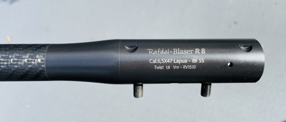

These barrel extentions cost app $250 and any barrel and caliber can be fitted to the R8:
Here's a custom IBI carbon R8 barrel made with a barrel extention:
Here's a R8 in 338LM. Notice the distance from trigger to chamber end of the barrel. The R8 is effectivly about 4" shorter than a traditional long bolt action

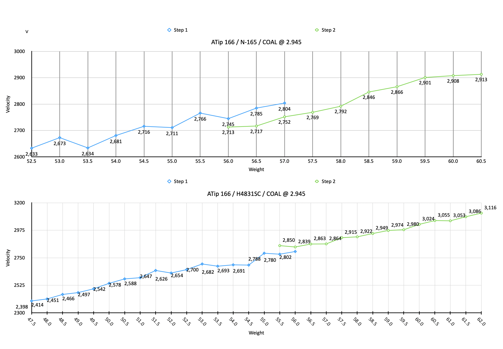

I was able to further test two bullets (180 Hybrids and 166 ATips) and two powders (H4831SC and N-165) today. I liked what I saw. Out of my Archimedes SA and 28" barrel, I got the 180s up to 2876 and 2935 with N-165 and H4831SC respectively. That said, I'm starting to think the real unsung hero with this cartridge is the 166 ATip. I was able to push it to 3116 with H4831SC and with a little faster powder I think there's still meat left on the bone. But even down around 2900/2950 it's winner. I had 3 or 4 hits on an IPSC today at a mile with no load development, just barrel break-in. I'll soon take it to 2k. With the slightly reduced case capacity of the 7mm-6.5prc compared to the SAUM/WSM, the ATip is a quality option

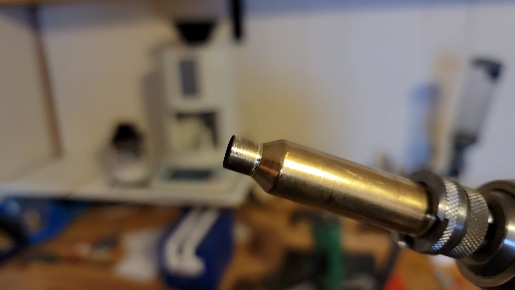

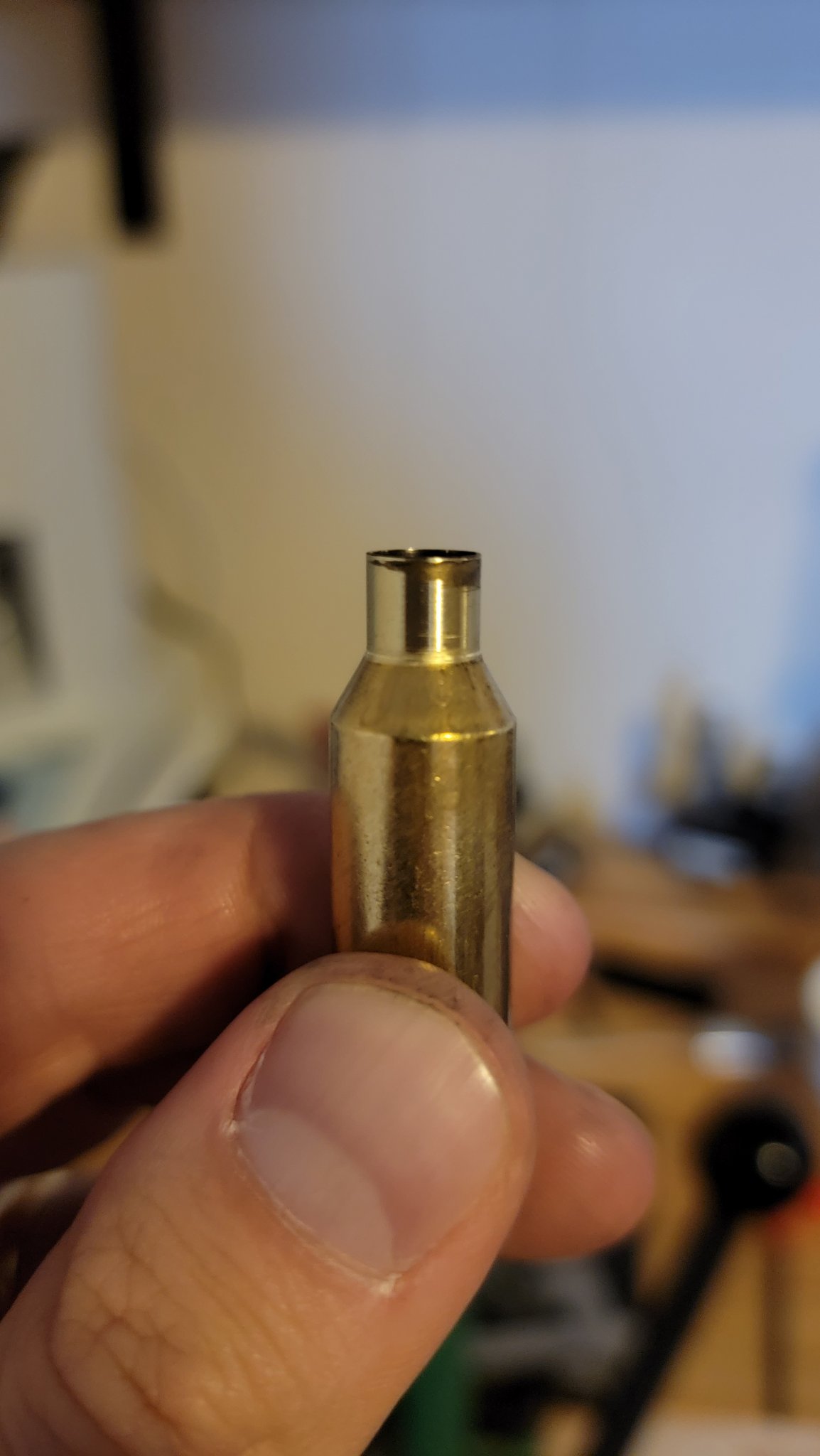

Alright, I've got my neck turning tool in from sinclair. It's not fancy but it'll work. I'm glad I got it. There is clearly a doughnut that's bigger than I thought. Set the cutter really shallow and ran some norma brass through just to get a feel for how this thing works. Now I've gotta figure out how much I want to "touch" the shoulder.
I'm about to feel really guilty about turning some lapua brass...
Cleans up good though.
