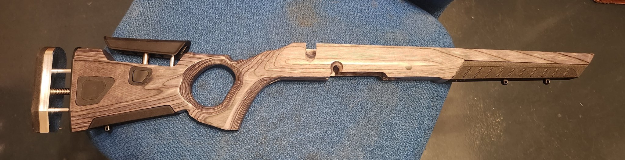

After a bunch of consideration and opinion shopping I settled on this Boyd's "At One Thumb-hole" stock (AR-mag version) . Looks brown here but more grey/white laminate (called Pepper) . Almost went with an MTD chassis but was going to be some pretty serious bucks to get something that could have 10-round mags. Plus would still have to get a pistol grip and a buttstock. The original Ruger stock and magazines were so clunky and rough I'm hoping this will be a better solution with AR mags. The Boyds stock comes with mag well / trigger guard assembly included.
