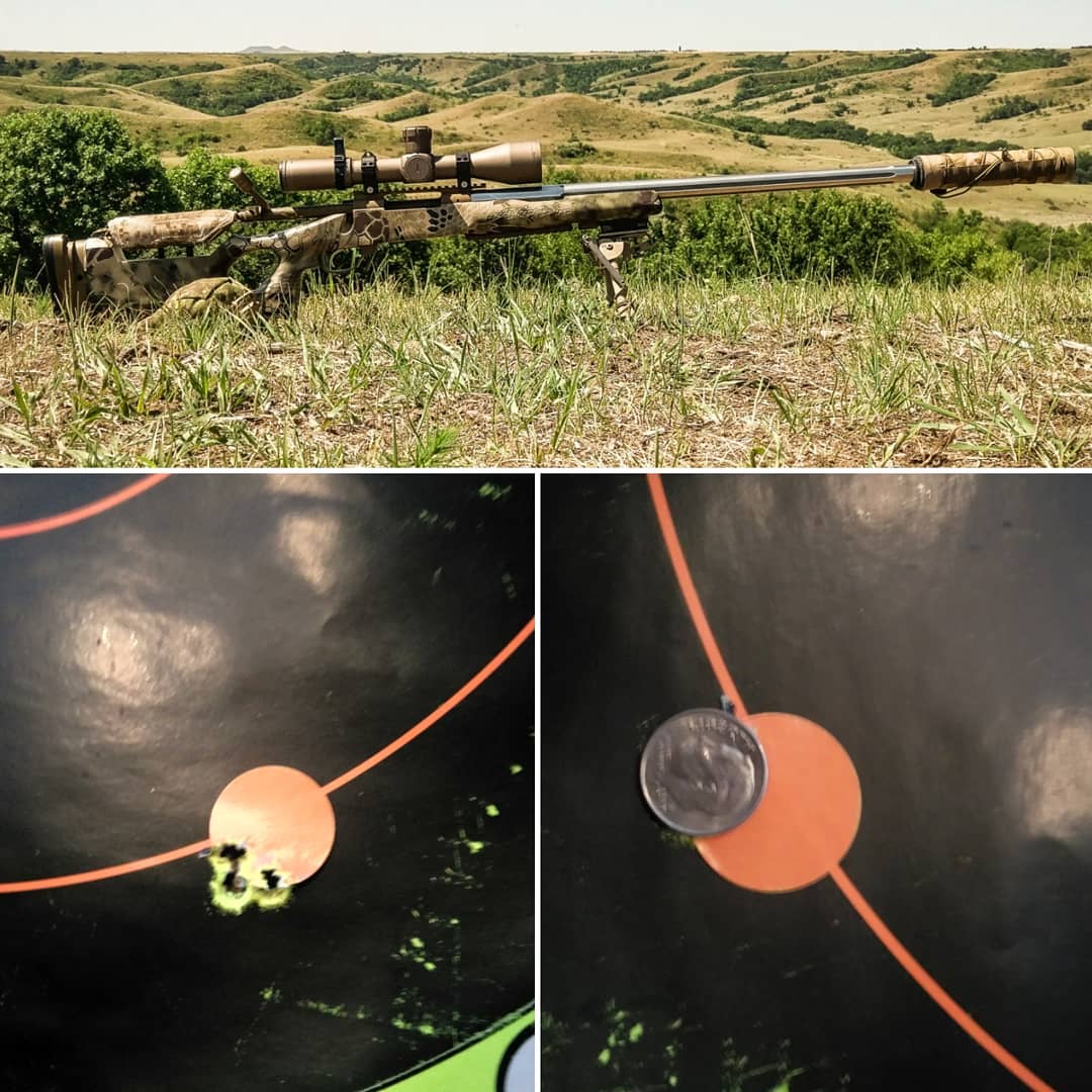

    Is there any justifiable reason to have my 7mm Rem Mag rebarreled to 7 LRM when the 7-300 PRC seems easier to find components for, cheaper more better?
    The 7mm Rem Mag has had both barrels shoot sub 1/2 at 3140 for the first one....and 3105 for the 2nd...but I have a feeling this summer will be the end of the line.
    Just trying to make a plan for the future and I'm wondering if it's even really worth it to change.

    First barrel was 23" I believe...and I'm pretty sure this one is 25"
    Running out of a CRF Win M70 with AICS mags

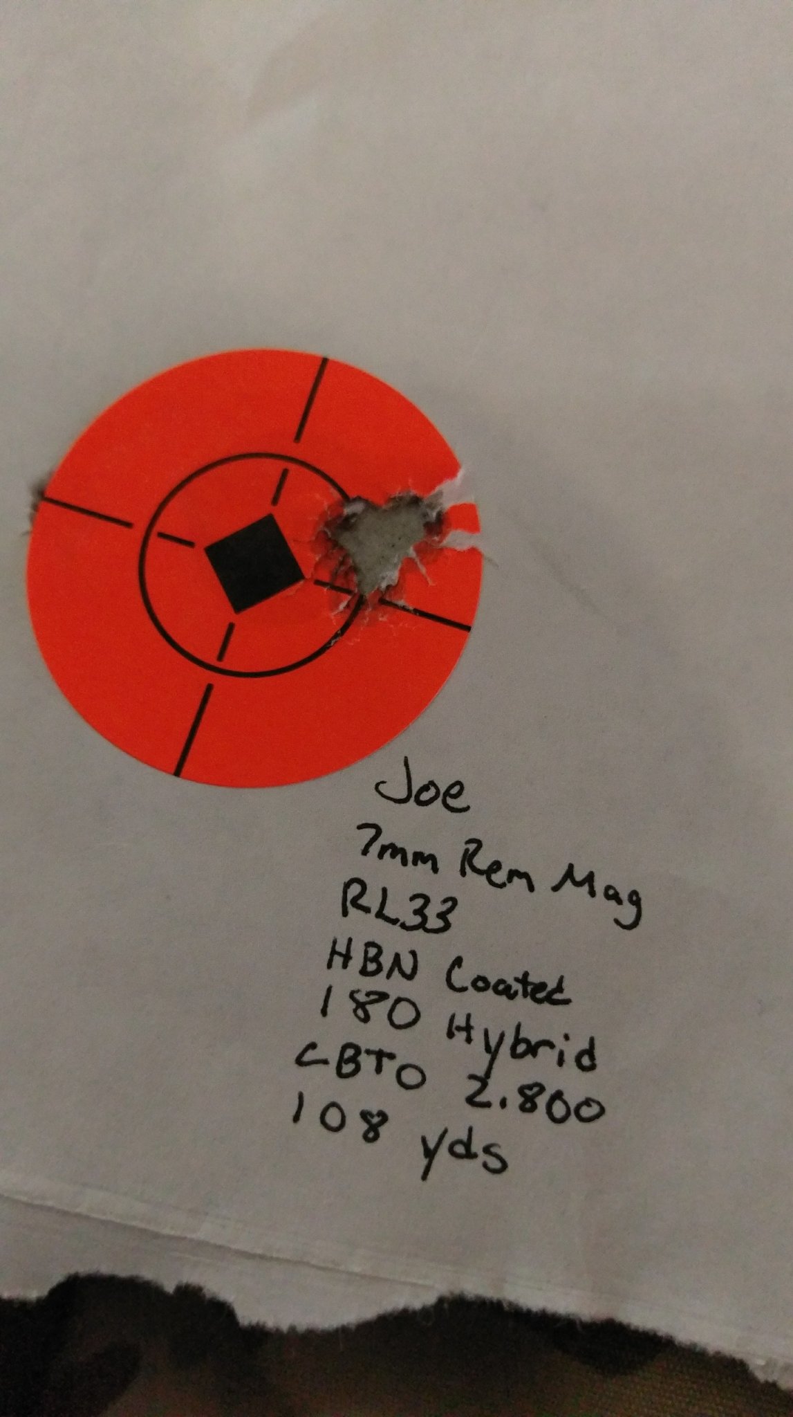

    I've already tested 190 Atips at 3040 with RL33 in a 25" 7mm Rem Mag.
    For the +180gr bullets...RL33 the key.
