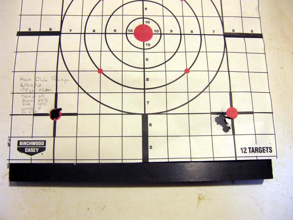

    Here is the ability of a Dick's Sporting Goods ADL 700-V. The receiver and barrel are the only things left original.
    It will shoot tighter than you can, categorically speaking . . .
    That's exactly what I was wanting to see!!! Is yours a .308? The one I have is in fact from dicks as well. I guess now all I need is a trigger and stock... Thanks
    Yes, it is a .308. I have not cut the barrel. Had the barrel threaded for a suppressor and am shooting an AAC "Cyclone". I took the action out, sold the stock and scope. Replaced the trigger with a Jewell and dropped it into a B&C A-5 fully adjustable tactical stock. Using a Harris bi-pod and shooting FGMM 175's.
    I'm 64 years old. You can probably do a whole lot better on a more consistent basis.
