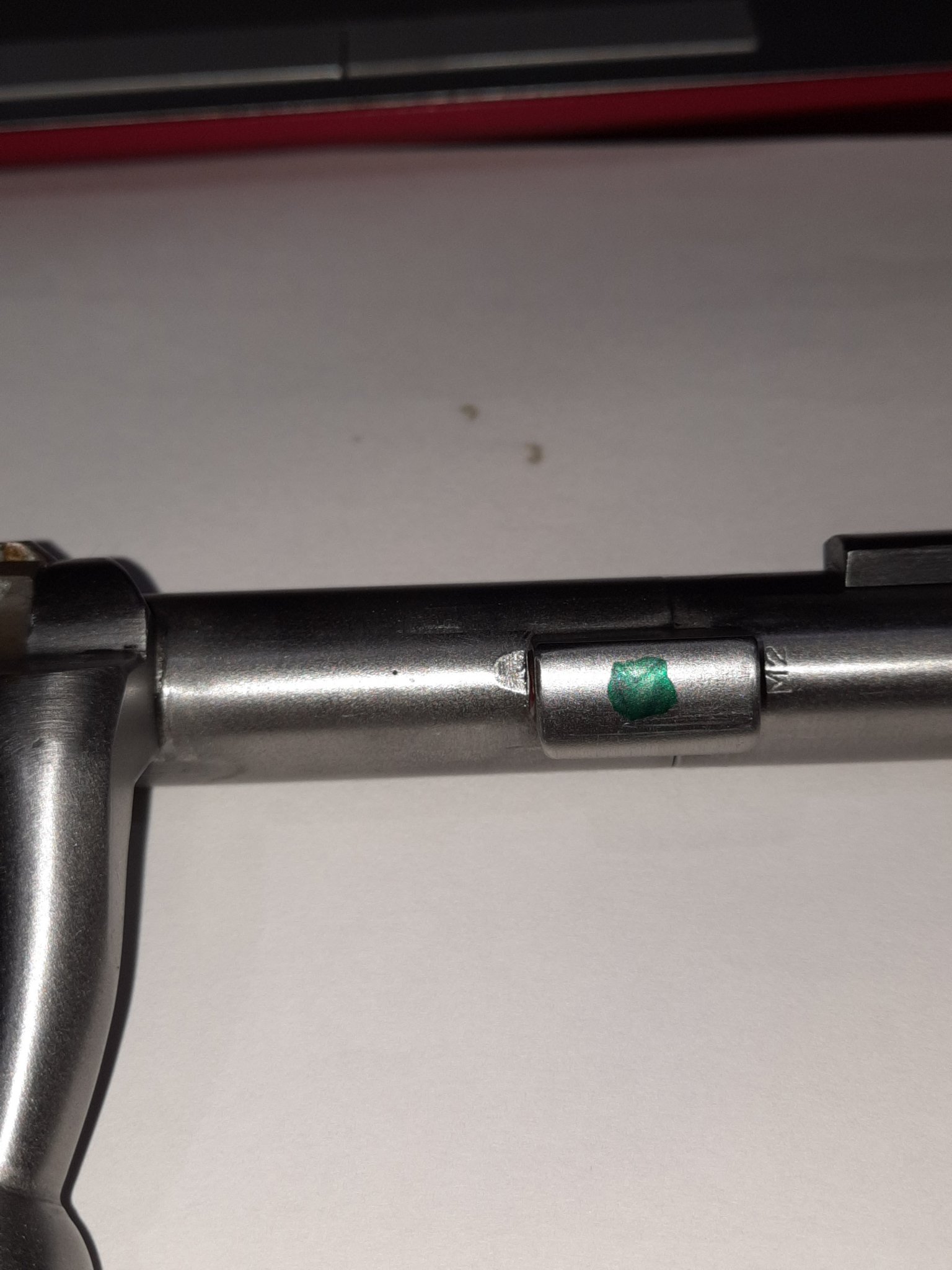

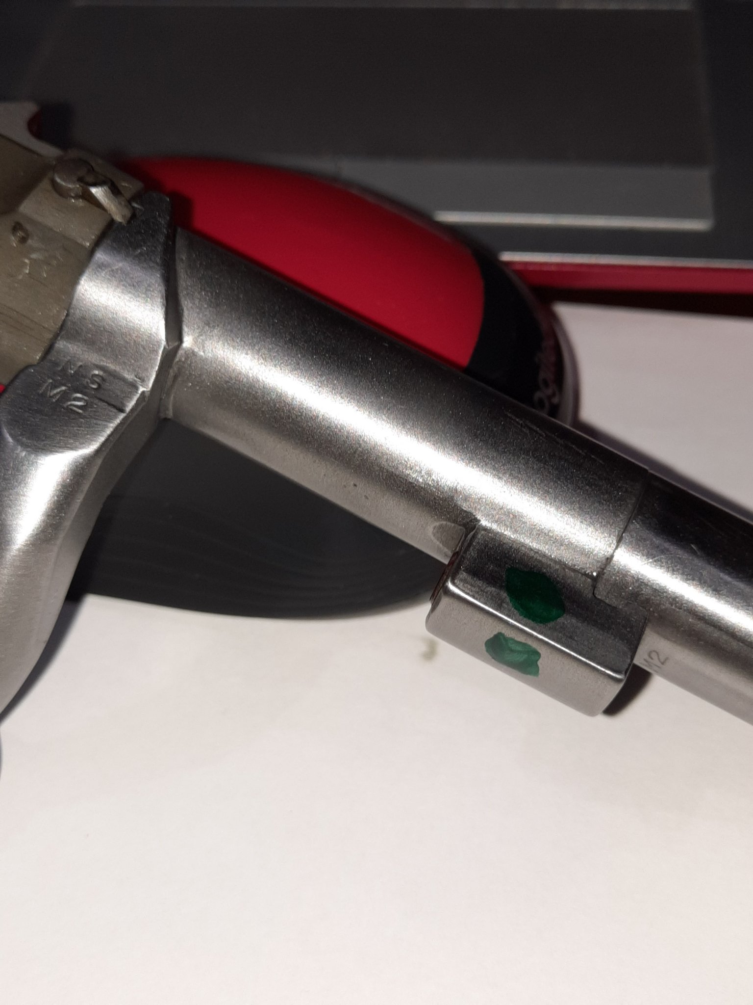

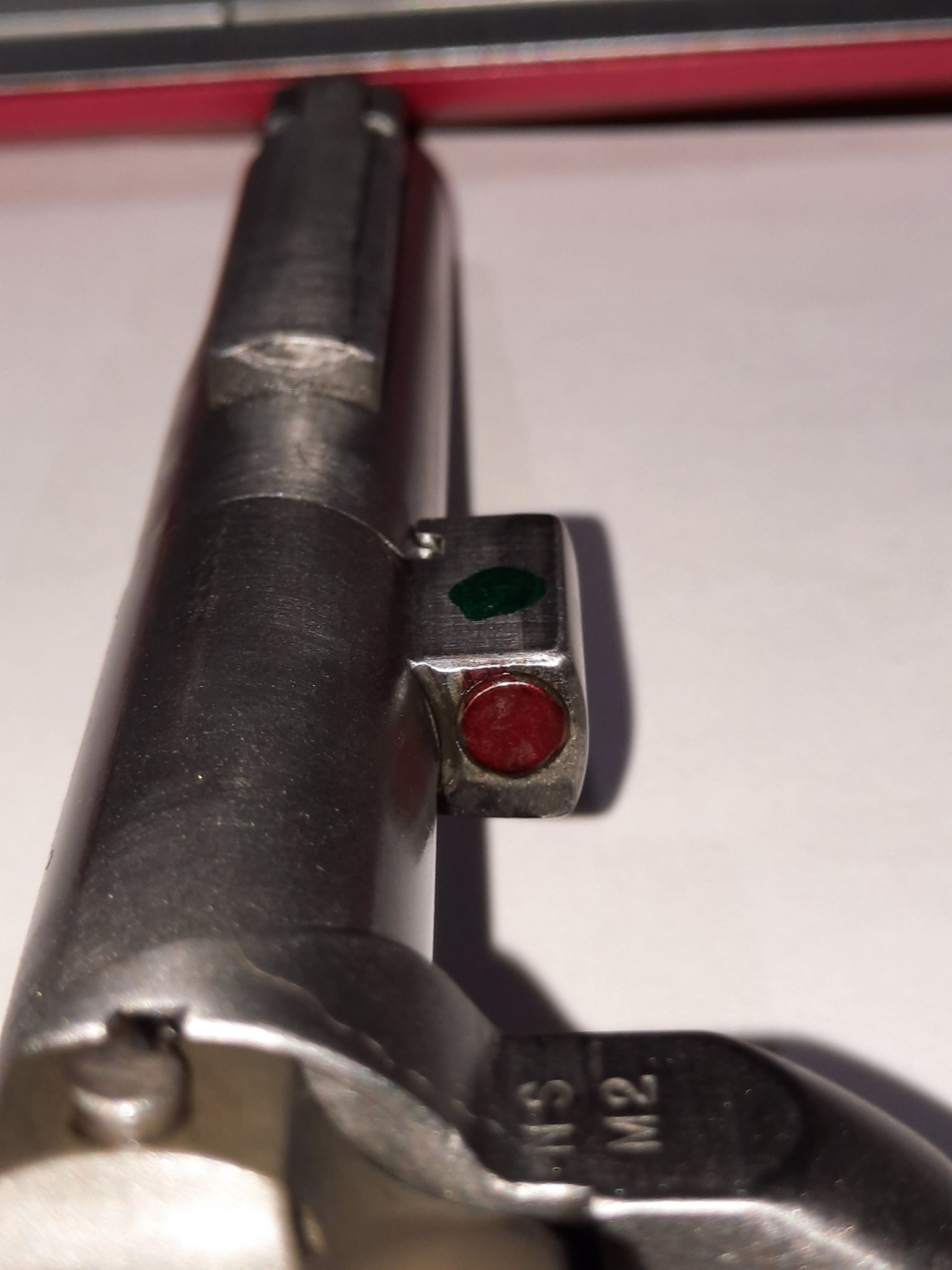

Id like to know if anyone has welded up some bolt lugs and refit them to an action? The play between the lug dimensions and raceway dimensions has me wondering if those tolerances were tighter, would the bolt be less prone to binding. If you have, was it worth it and what type of weld? Laser, tig ?
Are you asking if someone has added some hard surfacing welding rod and reground the lugs?
Do you feel like the lugs have worn down some how or just loose factory tolerances.
More info would help you get a better answere. Photos would be nice too.
KCSMITH....

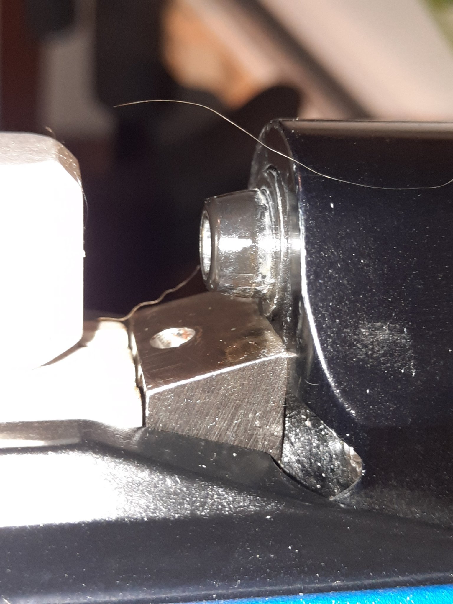

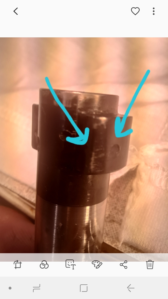

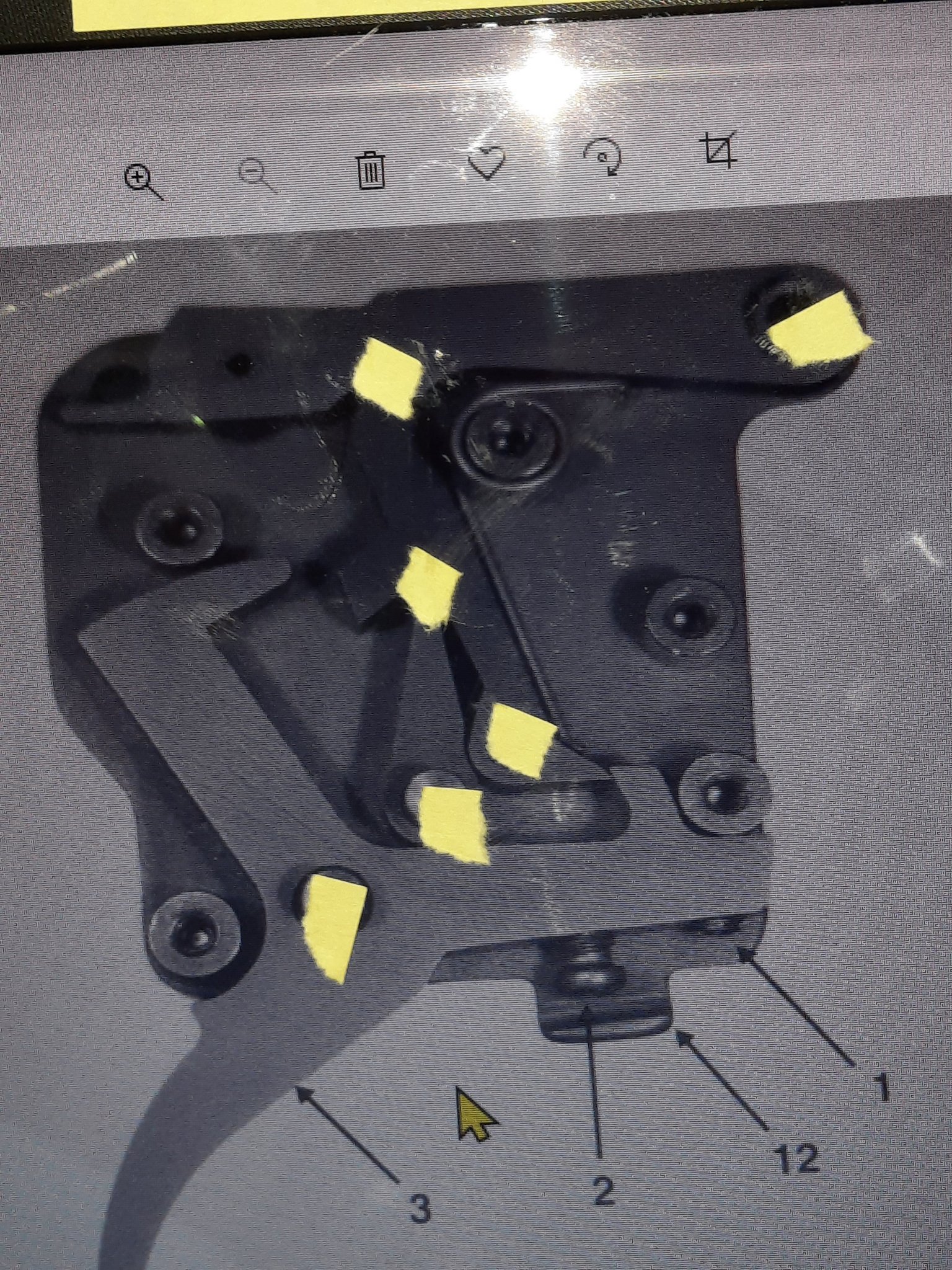

You may add some arrows and notes to your photo as shown below.
Years on the computer doing design work, I still have never learned how to use the functions that allow you to add arrows and circles
and notes on the face of an image. Below are post it pieces stuck to my screen. It's crude but it works.
I would appreciate any help I could get from the forum members to use the proper functions. My thing was CATIA V5.....
These two surfaces in particular.

@kcsmith It's not really the bolt lugs that you want to mess with (other than truing). What you want to look up is Remington 700 bolt sleeve modification or 700 double sleeve body.

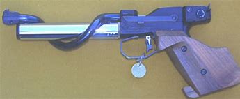

Images 7 and 8 are of an Olympic FWB P70 HP FT air rifle. The sliding breach block that has the air transfer port is pretty sloppy
when in the open position. When it is closed the transfer port needs to be lined up and the breach needs to seal against the barrel
in front and a seal under the breach block to allow air to flow. It can't be loose because 1500 psi of air needs drive the pellet out.
It is only when the breach is fully closed and the male and female cone align that allow this design to work at all.
It's a good illustration of a loose design that tightens up when it needs to.
I doubt the SURFACES you pointed out see any load to speak of. If it were 1922, they wouldn't. Those appear to be upper and
side surfaces not an axial surface that see's any thrust load.

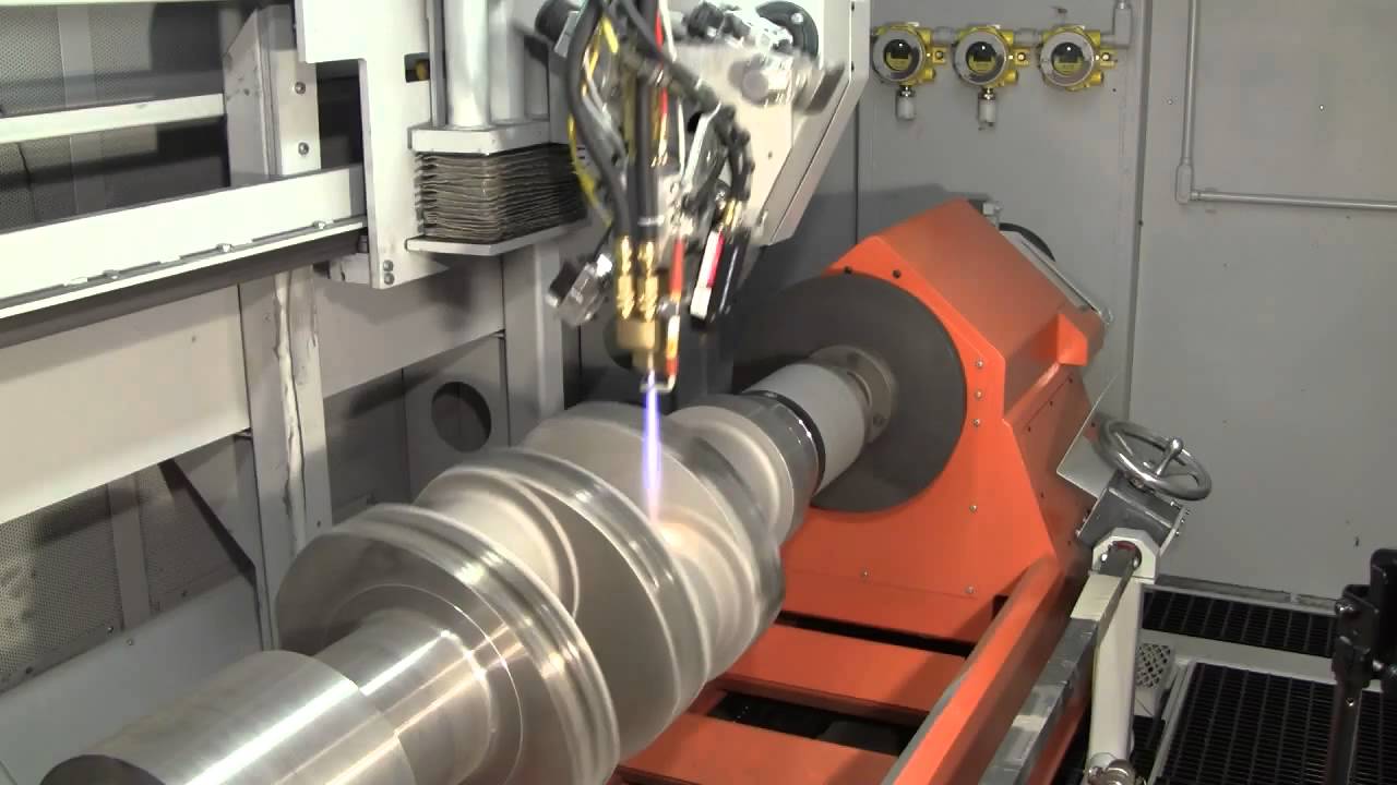

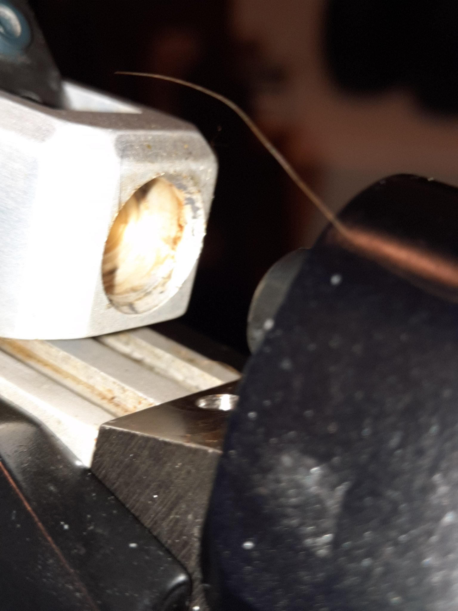

FYI... There is a process called "Spray welding" that is used to build up the surfaces of worn shafting and other parts. The part is generally
spun and welding material is sprayed onto it. A secondary grinding operation is required to bring it back into the design dimension.
Still nothing that will help your case. About 1980, I had seen an apple that had been spray welded. Why? I don't know... why did they twist the
barrel on the FWB 65 pistol below. 5 or 6 of them actually. I like the last image best for thermal spray welding. A crank shaft is undersized
for some reason and they are building it up to salvage it. In that case they are using a plasma heat source.

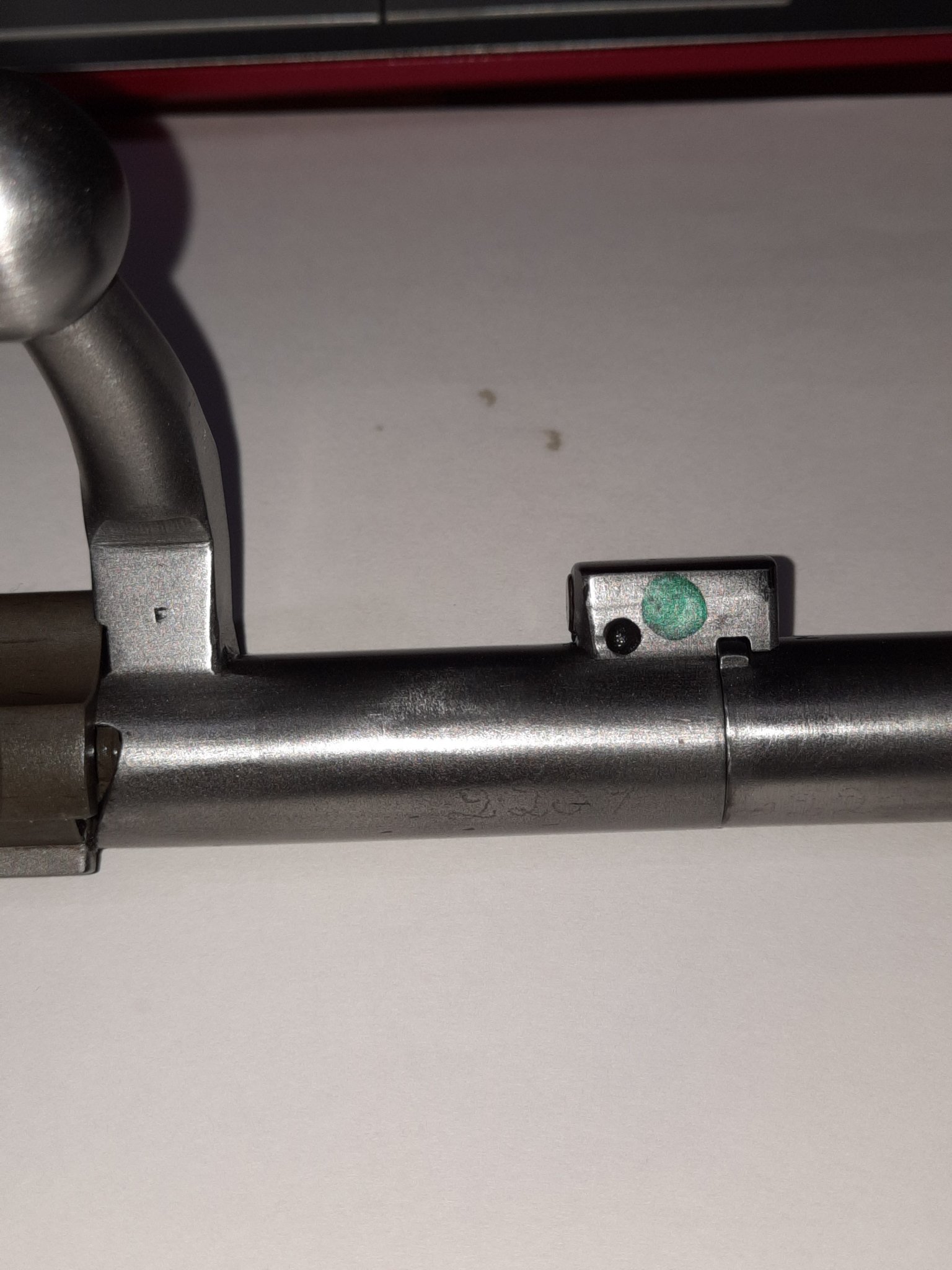

On my 1922 shown in the third image labeled 2.jpg, it wouldn't make any difference in function if the surface was ground down by .06"
You can see that the surface with the green dot has ZERO wear on it because it clears by at least .010"alreay.

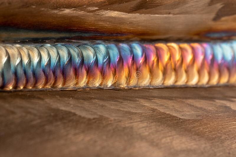

I have manually welded SS with TIG. ( GTAW ) The weld was a fillet fusion and the weld size being about .040" and very little HAZ. I would have
little concern about adding some hard facing to a surface and then have it sent out to be reground. Do I still weld for a living? No!
I was able to do the welds because I had surface ground every surface of the 3/8" thick SS prior to welding. My welds were very straight
and glassy smooth with no weave. The ones below are very nice... mine had a very different texture. The last thing I welded was 4130
air foil profile tube for landing gear. I used some local welding rod and the results were imperfect. I think that was about $3.00 a pound.
I decided to get some MC grade rod from Lancaster Alloys in CA. As I recall it was $30.00 a pound and free of the copper coating found on
most filler rod. The welds became perfect !! The welds were in plain sight and my name was going to be attached to them forever.

In the blueprinting class we NEVER welded on the bolt lug. As others point out, you're going to compromise the bolt's integrity. When the bolt was coverted from the Rem extractor to a Sako type extractor, the bolt was cut first to remove the rim that retained the Rem extractor and a collar silver soldered in before the bolt was milled for the Sako extractor.
I actually hate doing that conversion but it was part of the class so it was done for the experience.
Well duh its a surface weld so if you go real fast it won't heat up the parent metal too much.
No joke, we've had guys come in the shop asking if we can put "cold weld" on something because a hot weld would mess it up... Same people that bring destroyed parts in that were assembled with an interference fit. They would "sweat them apart" with heat and a press, obviously NOT in the correct way.
