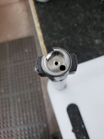

I've got a Rem 700 PTG SA bolt with a mini m16 extractor.
It works fine, however the position of the extractor and ejector makes the brass (6.5x47) hit my windage knob. It doesn't cause malfunctions but does mar the knob.

Was the dual ejectors suppose to fix that?
I'm not sure. Other manufacturers like BAT Machine put the ejector in a different position to address the problem.
My PTG bolt only has one ejector.
Yes. One has to appreciate that its a radical departure from the original system. Adding the second ejector restores the ejection angle (the "punt") to a more horizontal trajectory. This gets the case out of the action without bouncing off optics and whatnot.
Aftermarket bolts have divine intervention by being able to reposition where the ejector pin goes. If you look at them and compare to an OEM bolt, the pin's clock position is different.

If you order a PTG with M16 extractor cut, the plunger hole will be in the right place already. A dual plunger on those would make the ejection angle wrong.
I didn't know that. Even so, my PTG bolt with an M16 extractor stills throws brass into my windage turret.
Is there a way to improve the ejection angle?

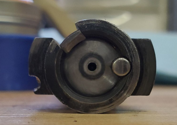

PTG bolt extractor and ejector orientation
Assuming they put it in the "9 o'clock" position (RH gun as you sit behind it) there's no reason to.
The bolt pictured above is mine and the ejector is in the 9 o'clock position.

It's because the extractor is made wrong. Mine wouldn't do that. All comes down to relief angles on the "inboard" side of the claw.
See the difference?
Me: You:
To add to this:
Look at your bolt. Now imagine your back to the bolt face looking down the muzzle. The bolt comes out of battery, lugs are horizontal. Now the plunger is digging into your left ass cheek and pushing you forward. Your forehead is captured by the claw of the extractor. You "want" to rotate at about the 2:45 clock position to "flip" out of the port. Only you can't. The corner of the extractor that is "highest" has a death grip purchase on your forehead. So, you get punted upward and basically do a backflip at about the 11 o'clock position.
That's why your brass is beating your shit up. If the upper corner was clearanced, it wouldn't do this.

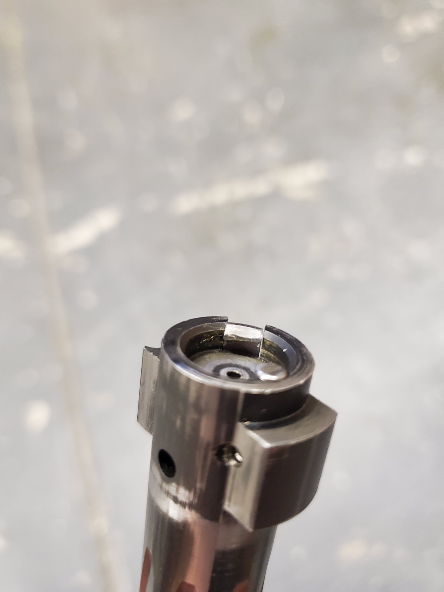

He could always yank out his dremmel and make his PT&G extractor look like yours. It is a cheap part to replace after all. :)
Well, I tried it. Brass hits the turret only when I cycle it slowly now.
Ejection still sucks though, the brass always flips back and hits the side of my action

Changed the PTG plunger to their new style and switched the Remington ejector spring to a PTG ejector spring.
The Remington ejector spring was much stronger than the PTG . That was causing a problem as one of you mentioned.
I can cycle the bolt slowly without brass hitting my scope and I haven't had a piece of brass hit my scope yet.
I also experimented with a PTG ejector spring and an unmodified PTG extractor. The ejection angle with the unmodified extractor was a little higher than the one I filed down,but in the few times I cycled brass through the action, it did not hit the scope turret. It looks like the weaker ejector spring made a fair bit of difference.
The new PTG extractor claw looked a little different than the old one, but it could be just my eyes playing tricks on me.
Last update
The modified extractor is having issues extracting cases now, go figure.
It will sometimes pull a fired case halfway out of the chamber. I didn't realize it and tried to chamber another round. I had to put a nice bend in the unfired cartridge to clear the jam.
