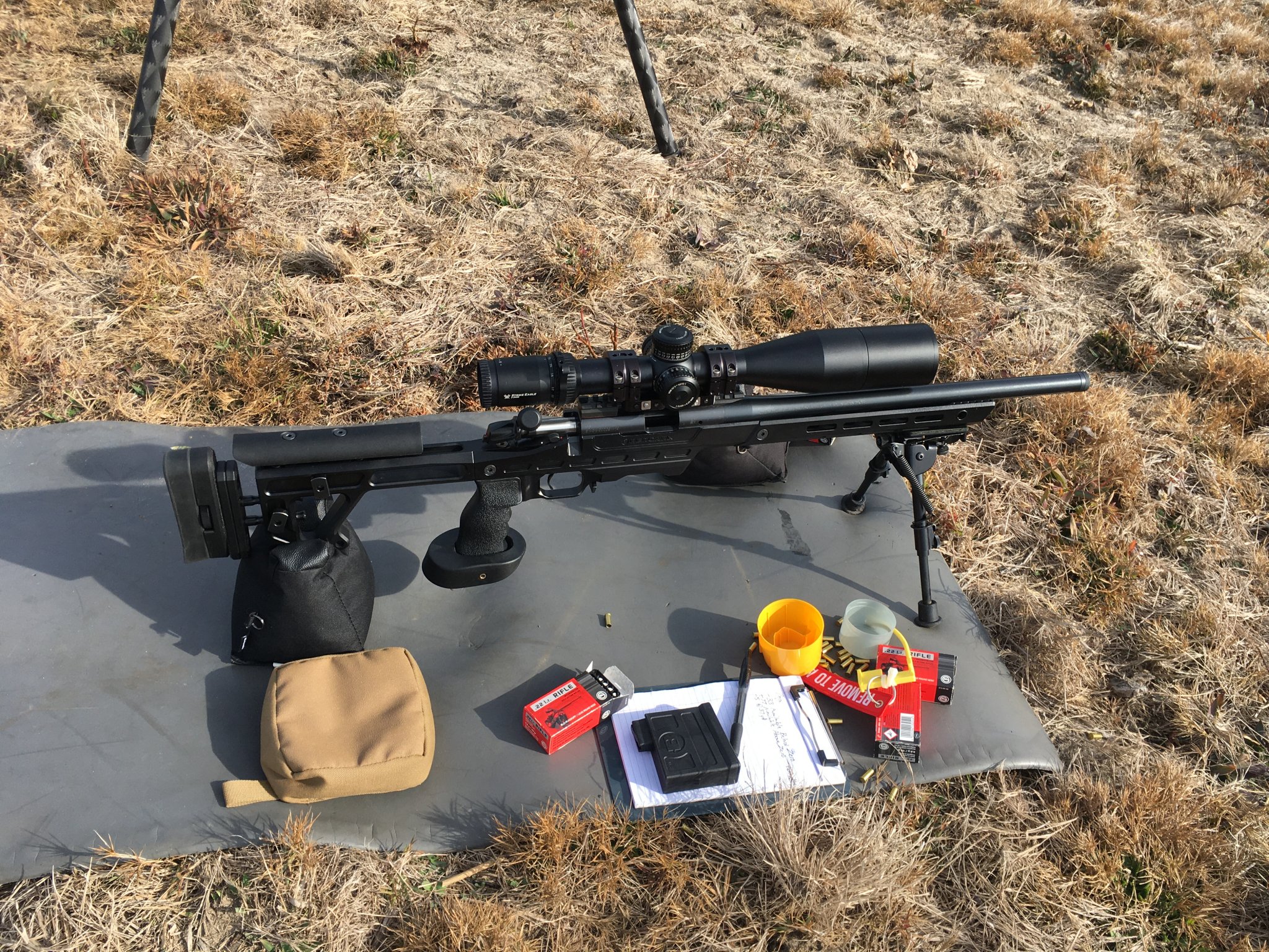

My Vudoo is in an MPA BA Comp chassis. The Bergara B14R is built on the 700 SA pattern/footprint, so it will also.
As far as for triggers, the Bergara BMR also uses 700 SA compatible triggers, but the action is not 700 SA pattern, so they won't fit a chassis. I'm hoping some aftermarket stocks/chassises become available soon for the BMR...not fond of the one they come with, the pistol grip is way too long and the angle too straight.

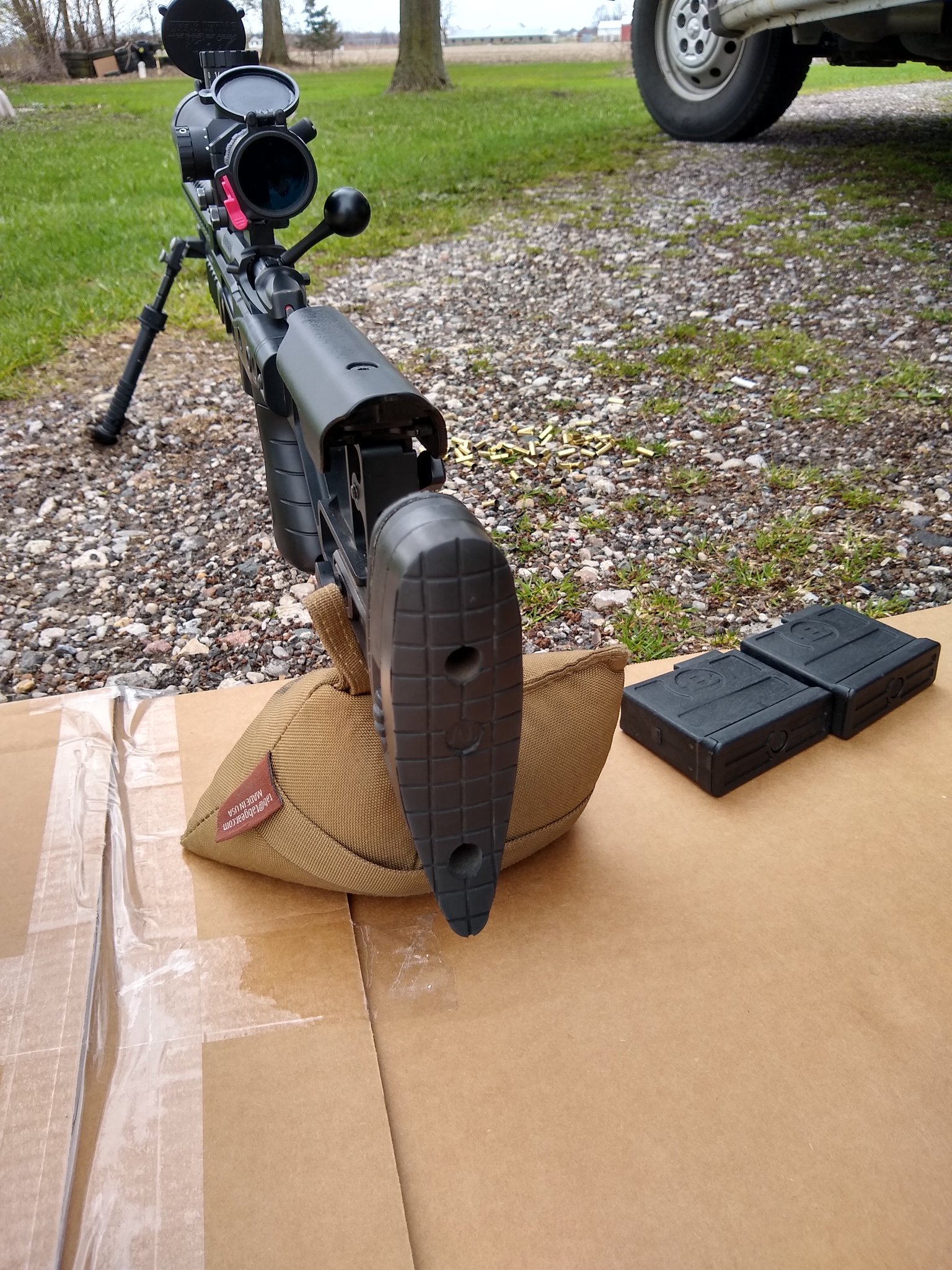

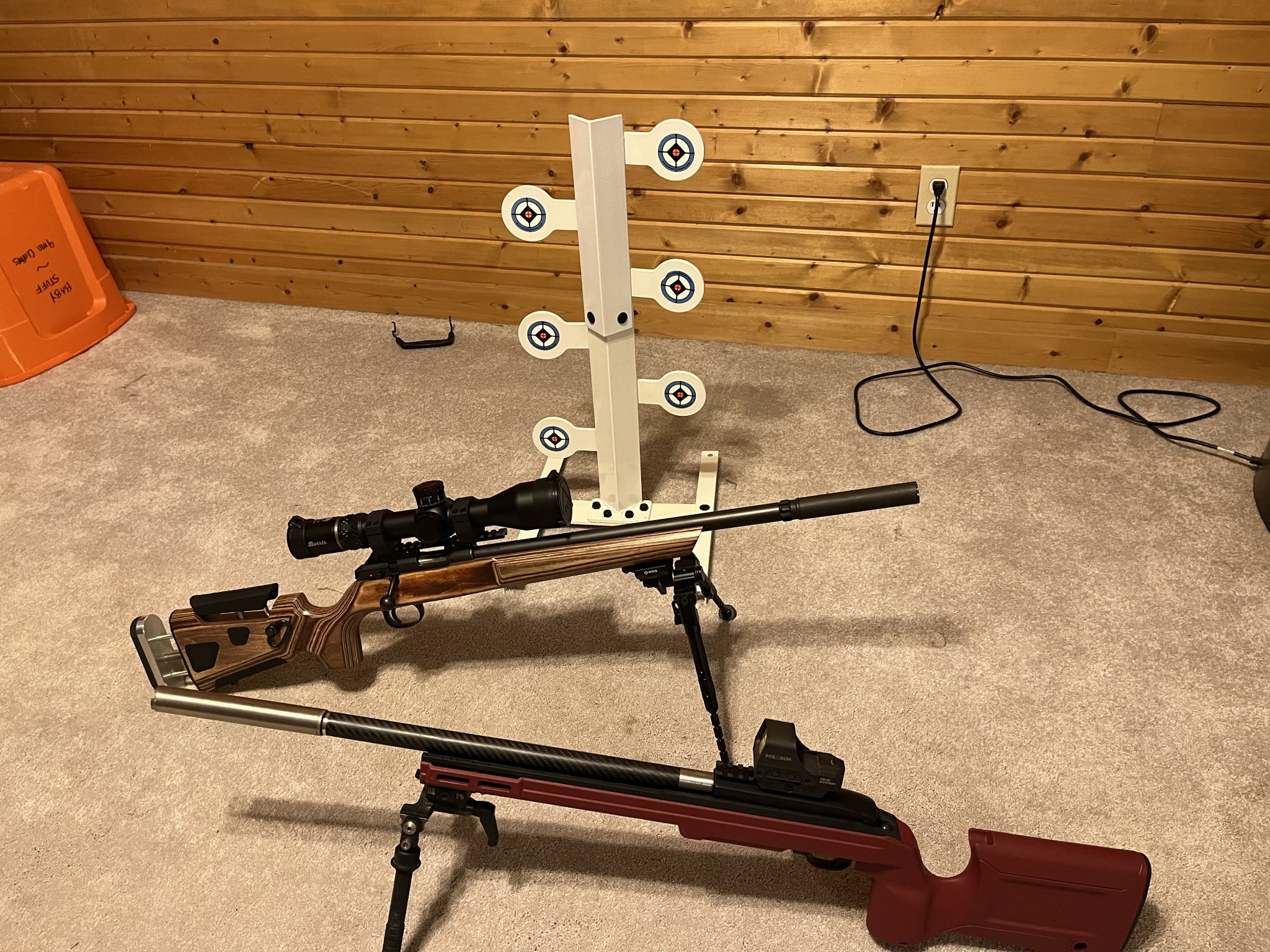

For the $$ the Bergara B14R is a great little rifle. I snagged a barrelled action from a member, threw it in a AIAX chassis and couldn't be happier. It shoots Eley target and Center X really well. It will be fun to try some others.

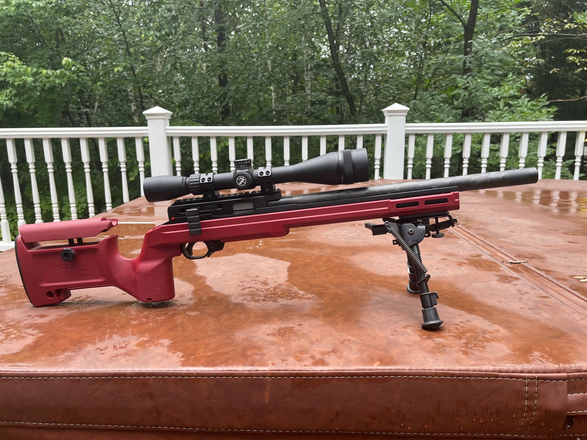

KRG makes a Bravo that fits the 10-22
Krg bravo for the 10/22. Built my son a 10/22 with the bravo chassis and it’s awesome!
Bear the following in mind about the KRG Bravo...
*Compatible with factory Ruger 10/22 as well as 10/22 (22LR) receivers from Brownells, Tactical Solutions, Volquartsen, and KIDD "Classic Slip-Fit" (with or without rear tang screw). We will add to the list of compatible 3rd party receivers as we ensure compatibility. PLEASE NOTE: SOME FITTING MAY BE REQUIRED.
*Not compatible with take-down models or receivers with a rear tang that has a bottom mounting action screw (ex: Ruger 10/22 Competition).
I love my B14r dearly and my wife likes it too, but after I put a KRG Bravo on a PWS Summit action (same footprint as 10/22) for her, she doesn't even mess with my rifles. I would consider putting a Bravo on your 10/22 (easy to sell if is doesn't fit the bill), then buy new glass as that is always nice and can go on the new 700 pattern rimfire rifle you build.

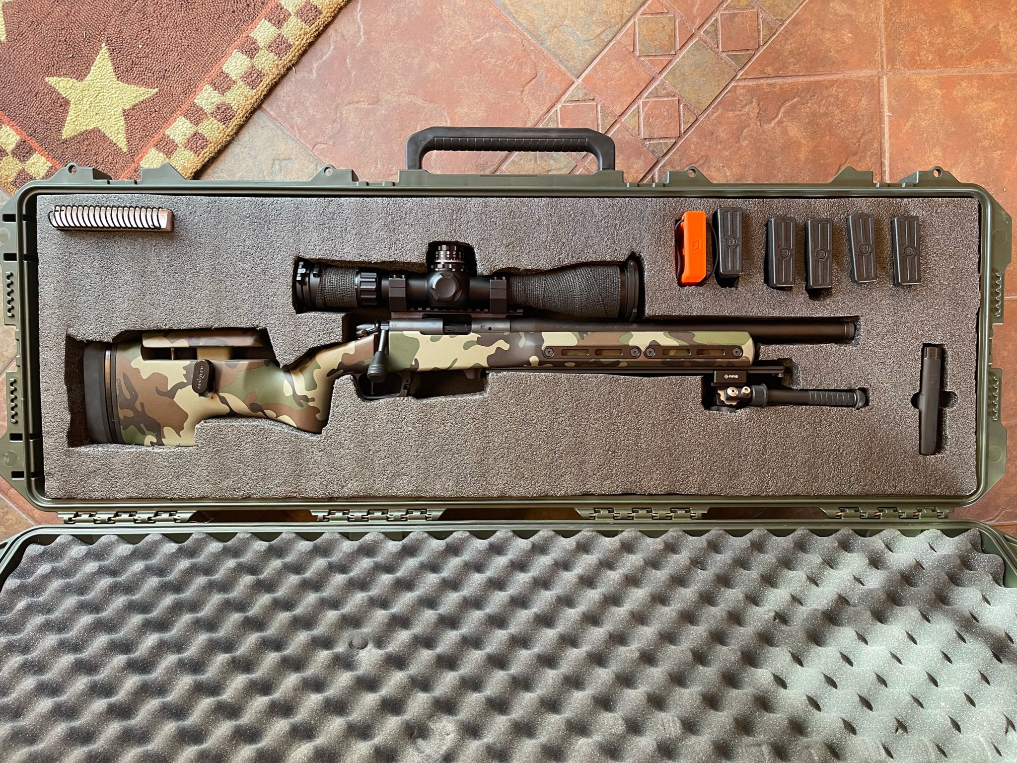

Absolutely love my Bergara B14-R, and when I decided to switch to a chassis, I was overwhelmed with the options. I found a used factory Bergara BMP stock here, and at 1/5 the price of what I wanted, decided to give ‘er a go.
I have no negatives, it’s a great option. Tool-less adjustment, accepts AR style grips, M-Lok forend for accessories, and perfect feeding from the magazine. No negatives other than hunting one down.
