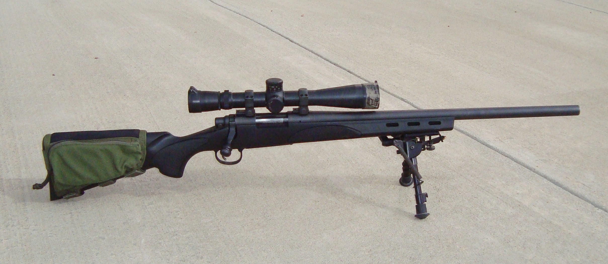

Which sps? Sporter, Varmint, Tactical?
The sporter and Varmint have a stiffer stock with forward pressure pad. Yes they will heat shift on you, but with a little Devcon you can partial bed the action and it will shoot decent. I would leave the pressure pad on first to see how it shoots, if it is complete crap then try shaving it down. Sometimes the pressure up front helps sometimes it does not.
As for the tactical, it has pillars, but the front flex sucks on a bipod. Off bags or over a pack and its doable.
With the barrel free floated there is more tendency for the stock to flex. The stock is plastic, but its design is stronger than the hogue overmolded stock.

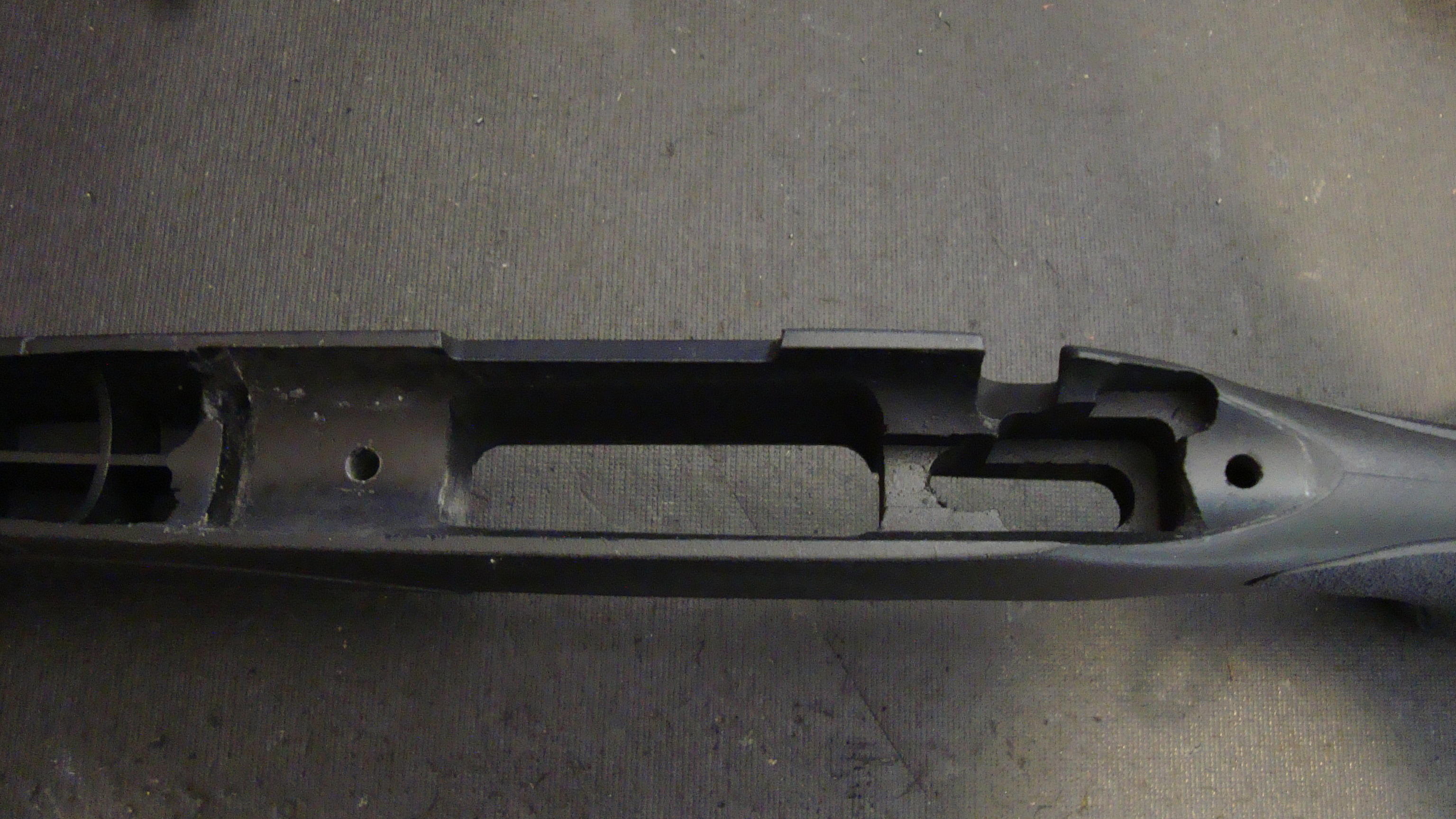

OK, so I am not sure if you have other rifles but I will give you my take on the Varmint stock. Little back story.
I have a Varmint that has been in various stocks and configurations over the last few years. Everything from Remington plastic, to walnut, laminate, HS, B&C, XLR and now back to stock plastic. My reason is that I have another in a McMillan/Atlas/NF config in 308 so no need to double the expense and efforts.
Having the same rifle in all those configs proved to me that stocks do effect accuracy, but not as much as good form and a good load.
Anyway, one of my goals this summer is to prove to myself that I can shoot 1 moa or less out to 700-800 consistently with cheap Remington tupperware. Call me hard headed but I find it to be a good challenge. Anyone can just drop a few thousand on aftermarket stock.
So the first go around failed, as I used the stock untouched as it came from Remington. It shot great, but then started drifting due to heat shift.
So I bedded the action under the recoil lug area and at the tang with Devcon 10110. I left the pressure pad and with everything complete there is approx 8 lbs of upward pressure on the barrel. (by using a trigger strain guage to pull the barrel back)
So now there is no more heat shift after 40 rounds at 100 Yards. I will give it a try this weekend out at Pawnee to see what I can do out to about 500 (if I can).
If the stock fails again, I will then move on to Aluminum pillars. I am pretty confident in devcon as it is tough stuff, but have used aluminum pillars in other rifles. Ernie has a good set and cut to fit the Remington Trigger Springs|Aluminum Pillar|Pillar Bedding|Gunsmithing
So I will update as I make progress.
