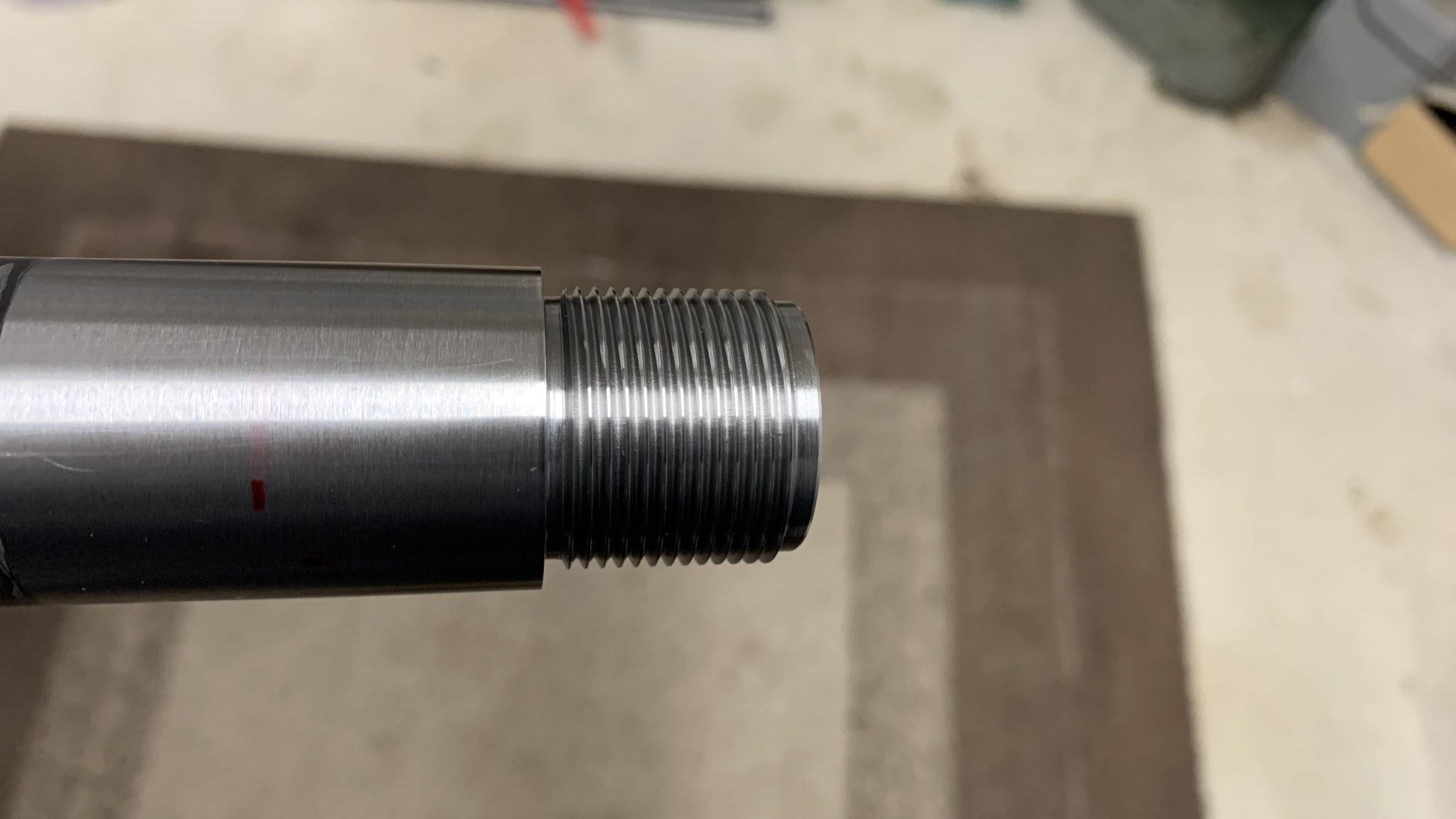

I have a Remage barrel I was just putting on. When I screwed the action almost to the recoil lug I could feel the play up and down in the tenon threads. This action has not been trued, and has burnt out several barrels, as well as having a rotation of three other barrels I switch back and forth on it currently. None of them do this. I just measured the major diameter of the tendon thread and I am getting 1.059-1.060. I don't have ring gauges or micrometer , but when I put my caliper in the groves looking for the minor diameter I get 1.004. I measured both with two different calipers. This is unsafe and I should be returned correct?
The muzzle threads are so big my QD attachment also has to be turned on with wrench from about half way. Again none of my other barrels are like this. This barrel is a replacement for a barrel that the muzzle thread cut way undersized for a 5/8/24. With the muzzle device almost at the shoulder you could wiggle it up and down on the threads.
I don't mean by grabbing the end away from the threads. I mean if you grab it by the shoulder over the threads, you can fell it move up and down. For both.

Maybe I just want an easy way to document how bad it is with out buying tools. I might try to get a good picture of them next to some Criterion, and Crown Ridge barrel threads, and see if the difference is noticeable. I didn't think to take any measurements on some other Remage and factory barrels I have sitting. I will say the threads looked fishy and extremely rough to me when I looked at them.

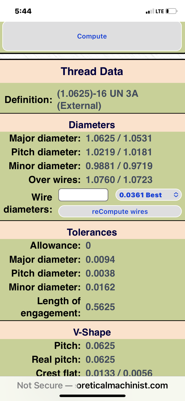

No, thats maximum. Note how wide the max/min is, but the pitch window is much tighter. If you can get some wires and a micrometer(not a caliper), that would be enough. I can link you to this calculator. Google the “three wire method”

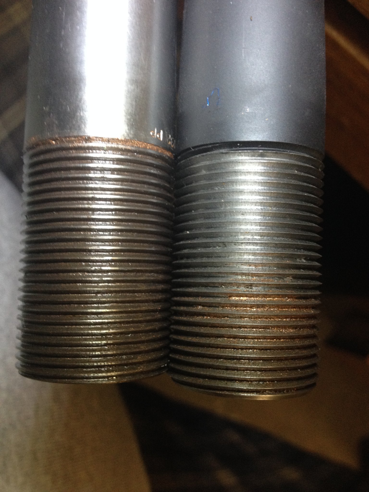

Ok i wondered I just measured one of the Criterion barrels and its major 1.054. I think this picture is kind of telling though. You can see it didn't even squeeze and distribute the little glob of antisieze on one of them. Let me check out wire, I know where i can use a mic.
They looked way too sharp to me when i opened it.

I am sure they can fix it. Not sure I can trust them. This is 0-3.
Those look nice to my untrained eyes.
The threads on the Criterion and crown ridge barrels look nice to my untrained eyes.
The other one looks like crap to my untrained eyes on both ends.

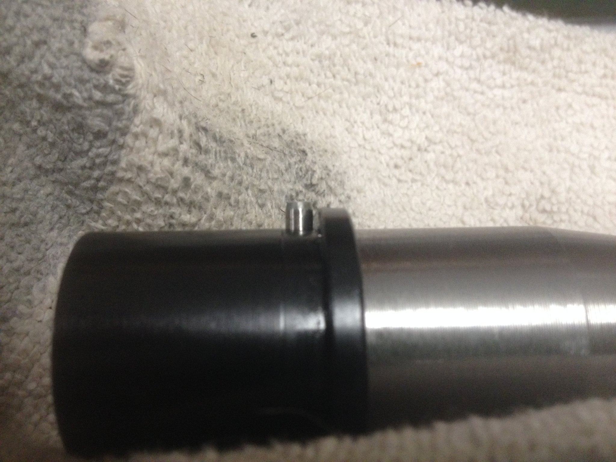

McGowen, I ground down the pin on the ar-15 barrel extension myself not a big deal. His CS has been fine but repeated stuff like this gets old.

It is going to wire way (like a lot) under even Class II specs.

I can see with my eyes that one thread is at least twice as deep as the other.
Had the *exact* same thing happen to me on a barrel I ordered back in '18. Was for a Savage and it did seem loose but I didn't think anything of it...was shooting 1/2" groups right off the bat. Another forum member was having issues with his barrel from the same company doing the same thing and sitting cattywampus in his stock. It made me go pull mine off and get a 3 wire set to measure the root diameter...it was way too small.

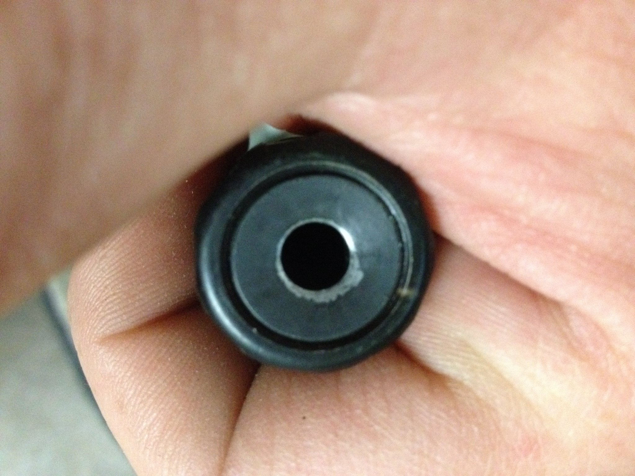

That got me looking even closer and thats when I noticed this barrel was not even crowned. The rifling protrudes past the end of muzzle when looking with a jewelers loop. It looked way off center at first, but that is just paint lines.
I am not sure I should even trust them to fix this.
