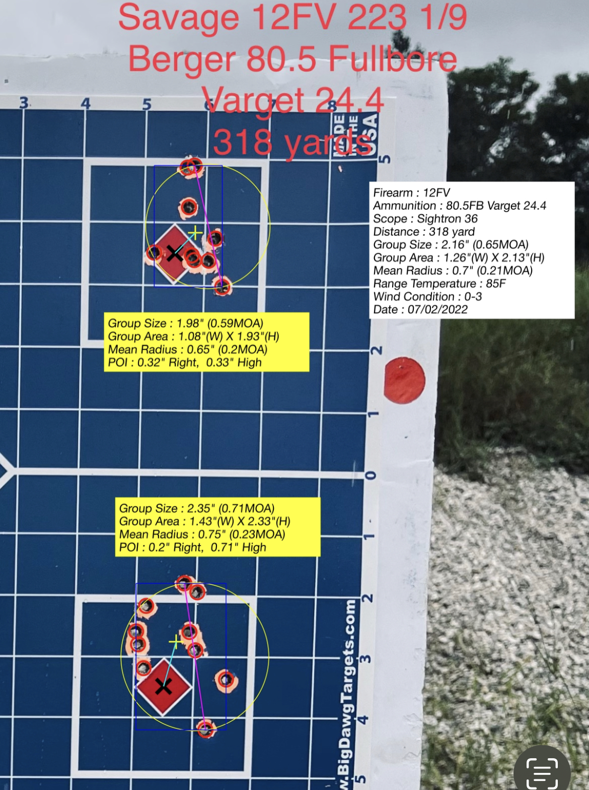

Contrary to popular belief the 77TMK shoot well on a 9 twist also. I haven’t shot my Ruger Hawkeye farther than 100yards with them but my savages have gone to 350 and do just fine. Also have shot 75gr Amax from the savages and have had zero stability issues.
