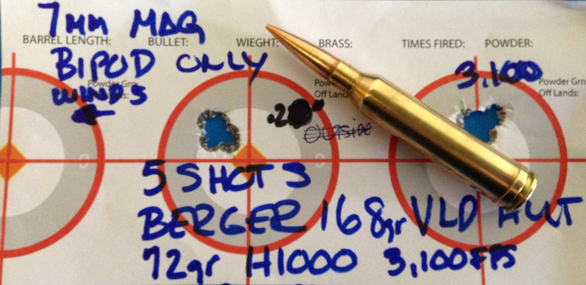

My load is 70.6 H-1000, new Win case, Fed 210 primer and Berger 168's .080 off the lands. 1/2 MOA out of a 26" Bartlein at 3050 fps.
168's are for pussies , grab some H1000 and load 180 Hybrids. Thank me later.
Here is my load for pussies. 168 Berger’s 72 H1000 31oo+ 26” 8.5TW
Same pussy load at 2400 yards
BTW I know and shoot with Jabot, he is NOT a pussy
Enjoy your current barrel for sure. If you rebarrel to a faster twist the 180's are tough to beat in my opinion. We use them on steel to a mile , elk and deer as far as the conditions will ethically allow. The 168s will do it , but the 180's are just more of a good thing.

The 195's have been used with mixed results. They're pretty sneaky ballistically but I don't trust them for use on game. To many reports of poor performance on game, I haven't used them personally and I'm not going to.
Apologies for jumping in with a left field question, but have any of you fellas had experience with the 175 Bergers on game?
I did use 175 eh on game out to 300 yards the results were devastating one shot all needed out about 600 yards on steel in a 1-10 then groups opened up beyond moa I'm sure with a faster twist they would would exceptional
