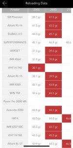

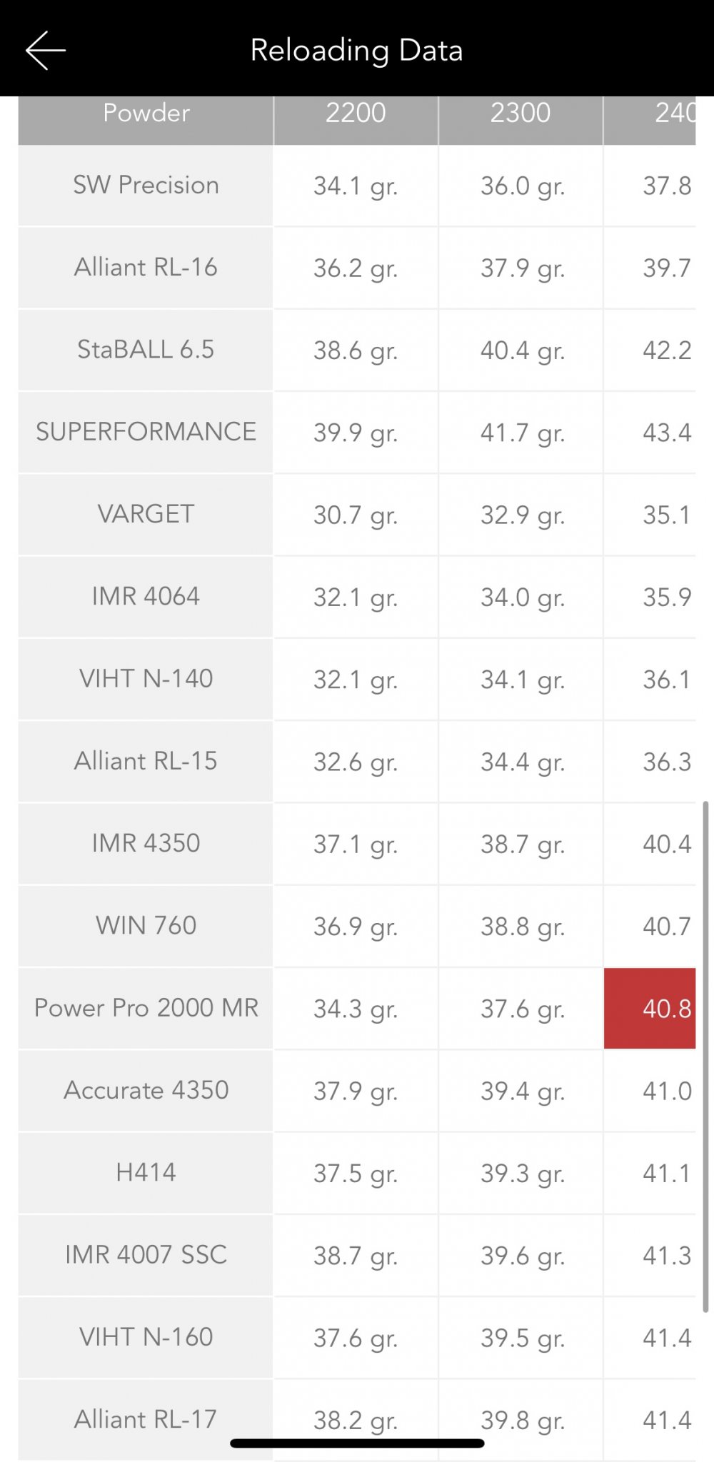

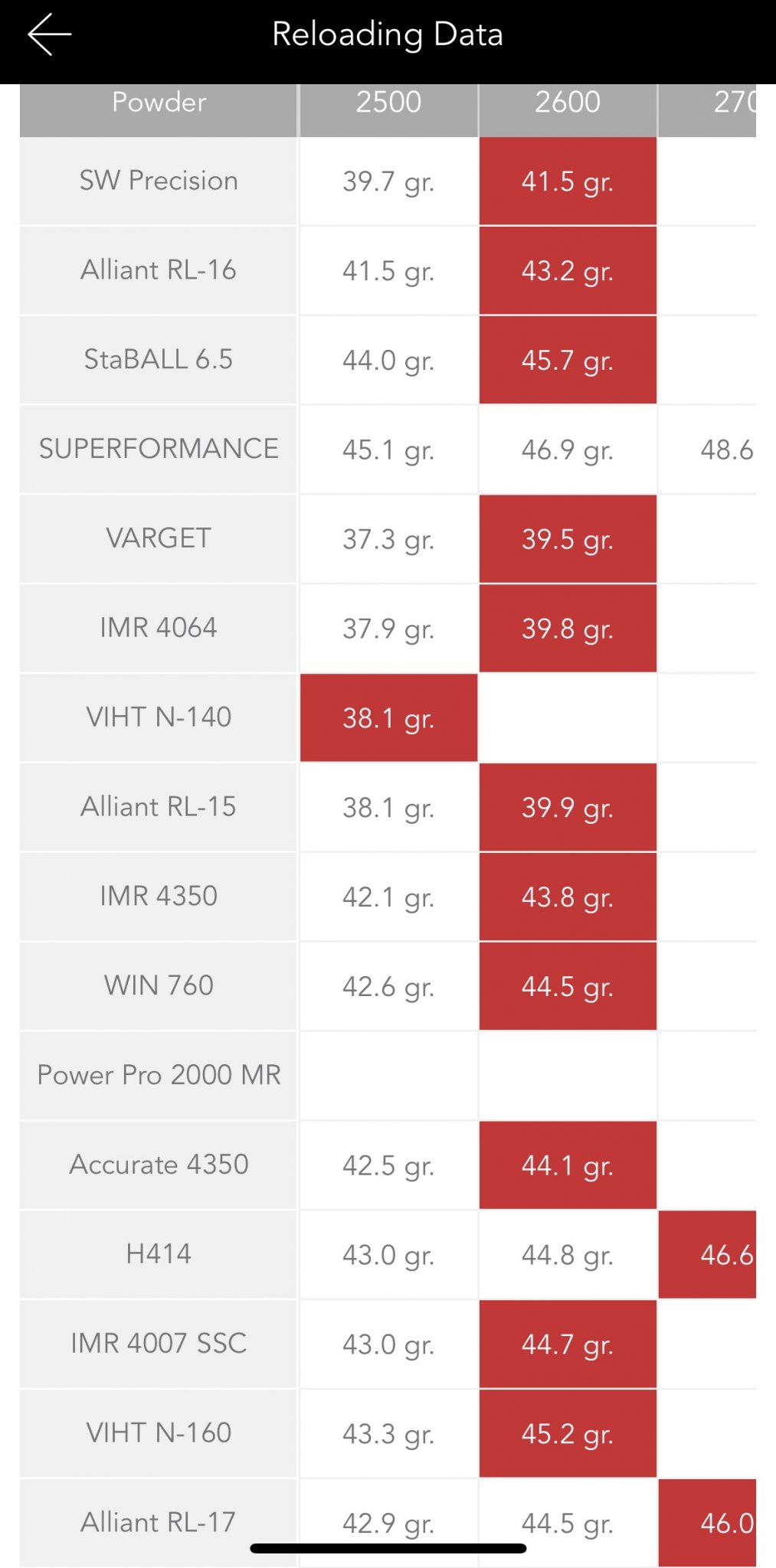

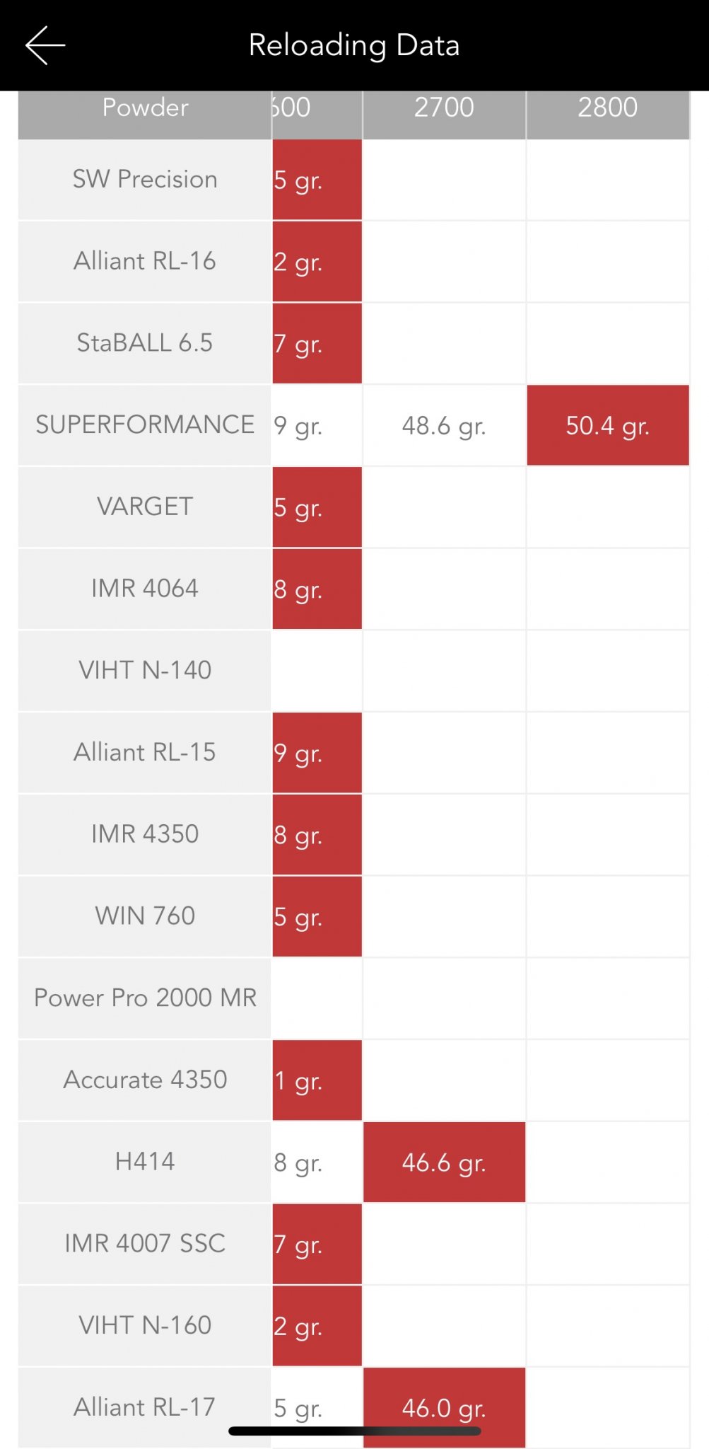

I don’t have that edition. Would you mind taking a pic of the appropriate page and posting?
Thanks,
P
Outstanding, thanks!
I need to find some Superformance.
Did the data mention barrel length? My Tikka is 22 7/16”, 1-9.5”.

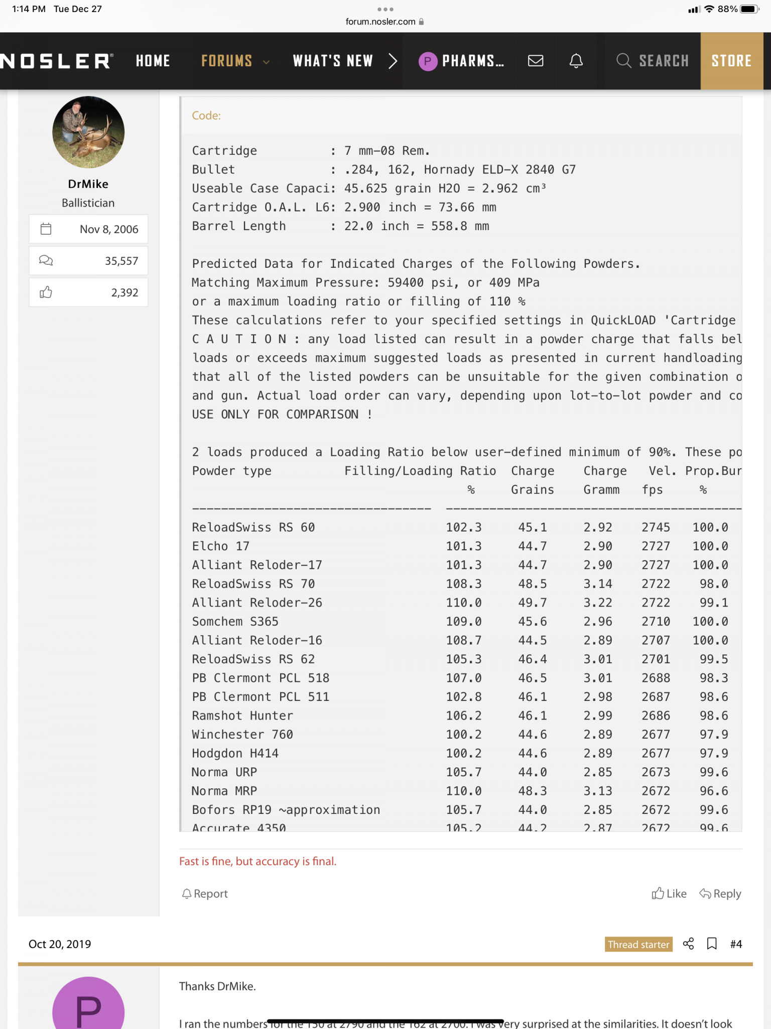

Looking at my notes from a few years ago, I asked for a Quickload for 7mm-08 and 162 Eldx over on the Nosler forum. This might help.

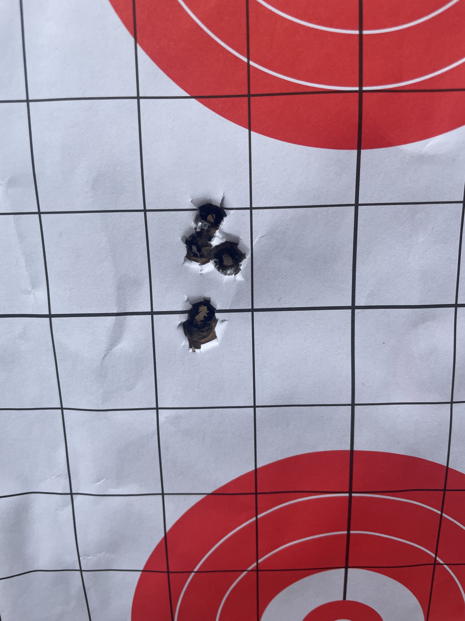

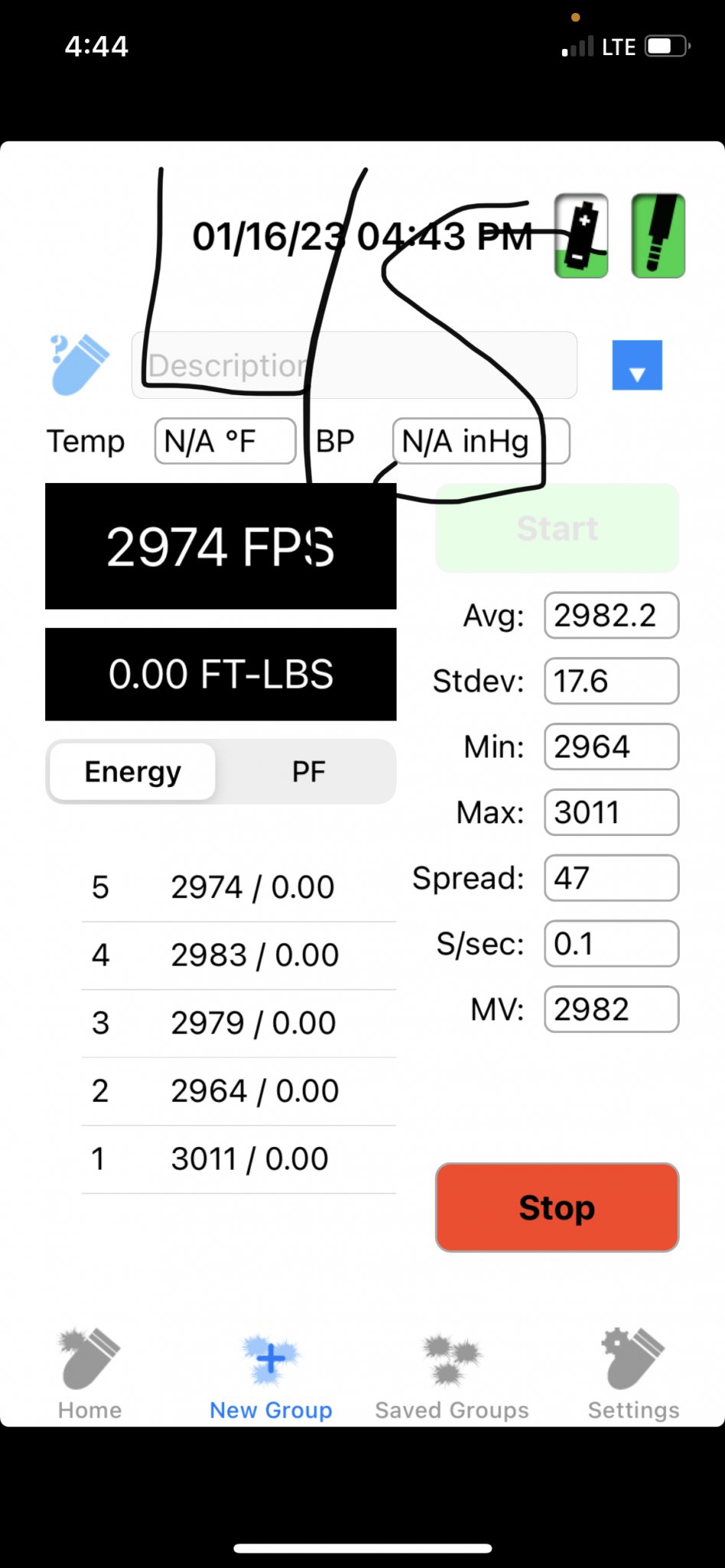

Picked the rifle up on Friday and spent Saturday getting load work up started. Decided to go with a 24” barrel, and here is the load I think I’m sticking with. 45 grains of N550, 168 VLD hunting, 2.950 coal, 2.238 ogive, .015 off the lands, Alpha Muntions brass, Remington primers. I pulled the 2 low rounds.
